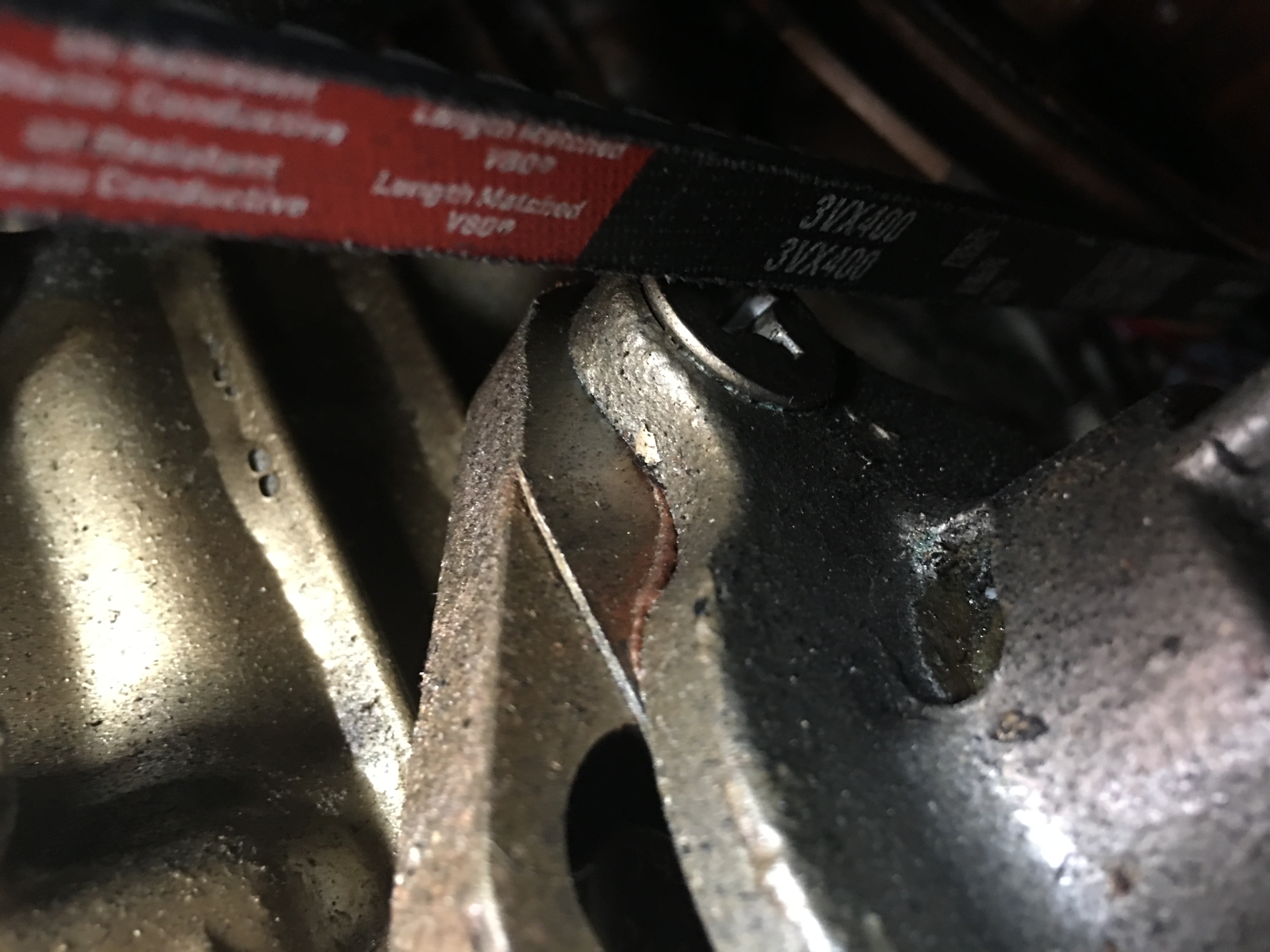

1.  I, like Les have an older Universal M25 enginge running a N202M-7...  However, the way it is set up on my motor, the belt rubs against one of the nuts on the two flange mount.  Thus creating a healthy spew of belt dust and chewing the belt up in time.  I have to believe that a N202M-15 would be a solution by moving that bolt, no?

I will take pics tonight but  iirc the closest bolt to the belt is the alternator tension belt.  There is a weird mix bolts holding the pump to the engine.
When I last changed the impeller only about a pint of water escaped.

I would believe that by going to the -15, you too will do away with the shaft sex changer and that mixed with the mounting flange should prevent any rubbing issues in the future. I could be wrong though without seeing pictures of the motor / belt / application area.

Looks like on mine there is a counter sunk machine screw there and not a bolt.  And yes the -15 would avoid that problem

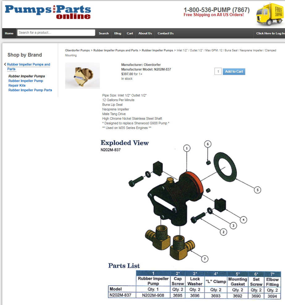

I'm finally replacing my Sherwood raw water pump on my M35B C36 #2164 (2003 year).
Thanks to these forums, I learned about the Oberdorfer N202M-837 replacement kit for the Sherwood.
This kit contains the Oberdorfer pump N202M-908, as well as the mounting bolts and L-attachments, two hose elbows, and gasket.
Pumps N Parts Online's price is a respectable $397, free shipping, and no tax shipped to CA.
Unfortunately, in speaking with Scott, they were out of stock, with more inventory in transit.
As I couldn't wait, I sourced one locally in San Diego for $495 plus 10% sales tax (sales tax in LA County just increased to an astonishing level!), or about $550.
Thanks to Pumps N Parts for the great pricing!

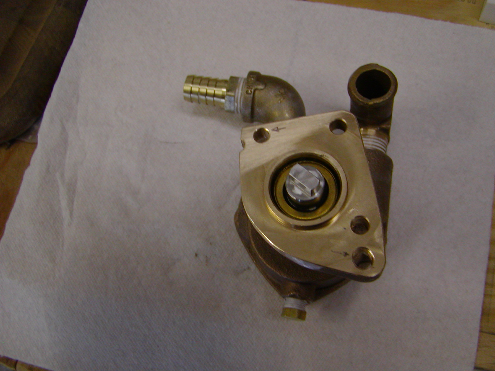

My trusted Oberdorfer N202M-16 finally after 220 hours has started to weep. I am quite happy with its performance.
I have ordered the repair kit (part number 11691) from www.pumpsandpartsonline.com for $ 53.00  ( free shipping).
I have never replaced these parts.
Can anyone tell me if you have replaced them? Is is safe to replace them while the pump is attached to the engine.
The problem that I am thinking is that after the shaft is removed any water remaining in the pump may drip down into the engine
through he hole that is used to lubricate the shaft where it joins the engine under the mounting base.
Do I need to remove the pump to replace all the seals - or can I replace them from the front?
You need to pull the pump to replace the seals.  Close the raw water thru hull.  Pull both hoses off the pump.  Pull the pump from the engine.  For those with the -03 pump pull out adapter.  Clean up the engine where the pump was mounted to remove any gasket material.  If worried about getting crap in engine use duct tape to seal.
Replace all the seals re-install with new gaskets.

Leslie, thank you for your help.
I decided to replace the seals myself.
I have posted photos of how to perform this repair in my other post - see link below.
https://www.catalina36.org/forum/technical-discussion/oberdorfer-seals-replacement
You will find the link to the album for this installation in the link above..
I am sure it will help others

I now have the replacement seals. I am wondering if lubrication is needed before re-installing the shaft.
I have a large drill press to insert the seals. Is that sufficient force?
Posts: 393
Haro;
 Not sure about the force that would be developed by your drill press but a 4 inch bench vise will do it.
