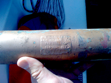

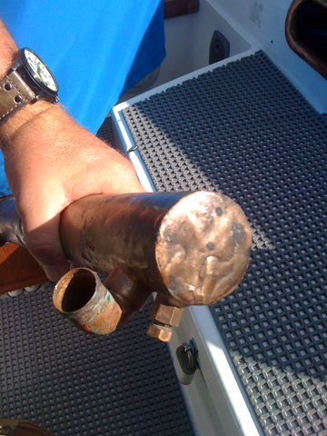

I took the boat out yesterday for sea trials and to play with my spinaker. I ran the engine at different rpms and then pushed to almost full rpm. The temp gauge held solid at 160'. There was abosolutely no hot engine smell!
The only thing I have to do is install a rubber gasket or material between the HX and the engine bracket.
I also took a couple of pictures of the old HX. Note the welded end. It was definitely an after market weld. One can only guess why the PO had it welded shut. I would guess the bolt threads stripped or the shop could not get a good water tight seal??? It's anyone's guess?
Thanks for all of your inputs...

[QUOTE=stu jackson c34;6701]
the old 2 inch HX had one end welded shut from the factory, it wasn't your PO who did that, so don't blame him.
[/QUOTE]

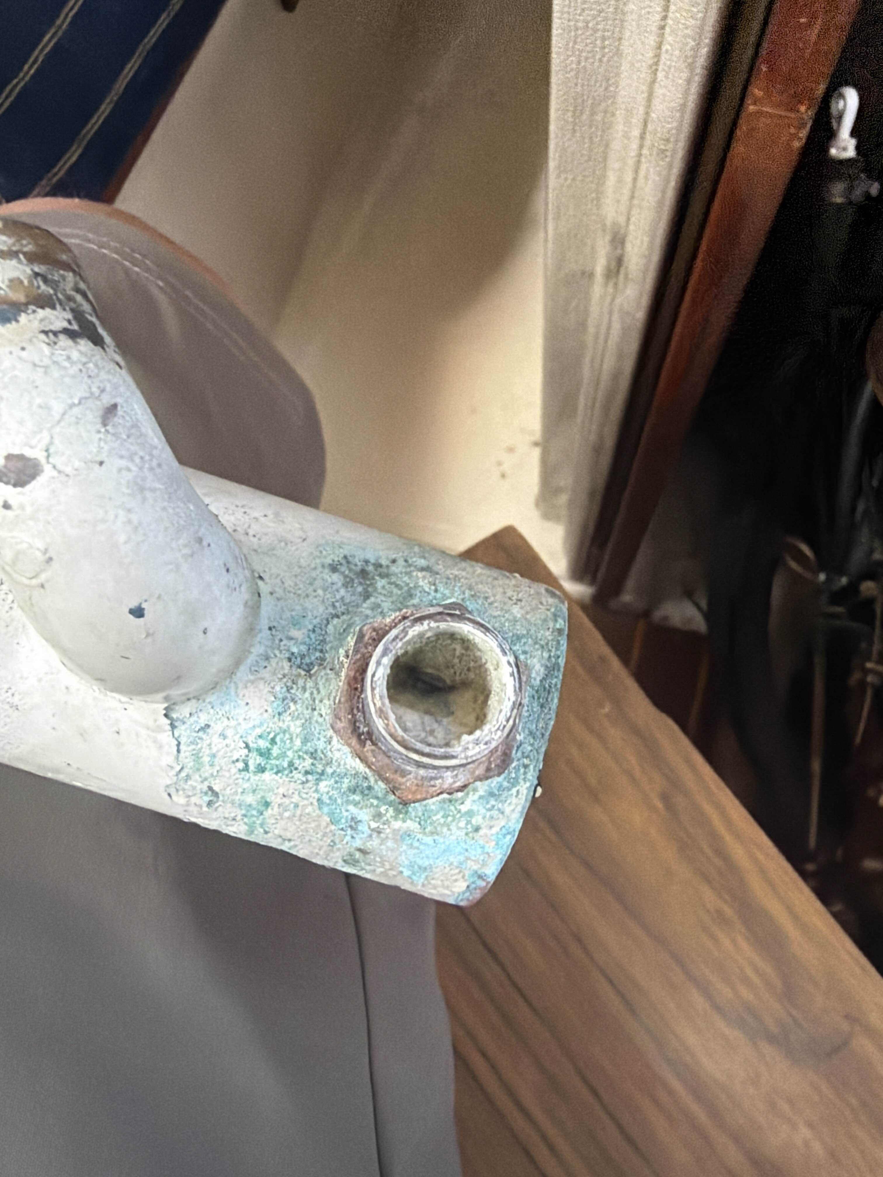

I just attempted to change the zinc on my new (to me) c36 with an M25, and when I removed the bolt there was no zinc attached. Then I tried to insert the new zinc and discovered that the hole is plugged (probably the old zinc). Problem is, I have the old 2" HX, so the end cap by the zinc cannot be removed. Any thoughts as to remedies?
Or should I just replace the thing by upgrading to a new 3" HX, and if so, any suggestions for where to get one?
'Cause that's where I step when I am climbing down into the cabin and the engine cover and companionway steps aren't in place.

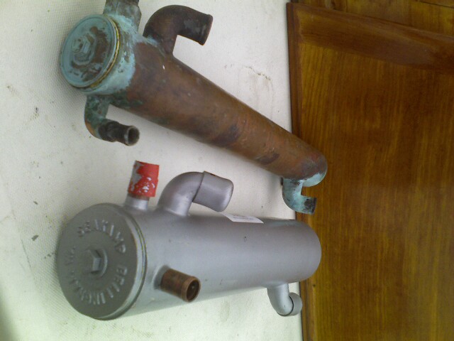

Having just performed this upgrade a few weeks ago, I discovered that the old 2" HX in fact DID have a ½" fitting for the hose from the raw water pump, while the replacement 3" HX has a 5/8" fitting. Thus, seems like the PO had the correct hose size. The solution (for me) was to fabricate a reduced barbed coupling to go from 1/2" to 5/8".
[QUOTE=Chachere;8489]Having just performed this upgrade a few weeks ago, I discovered that the old 2" HX in fact DID have a ½" fitting for the hose from the raw water pump, while the replacement 3" HX has a 5/8" fitting. Thus, seems like the PO had the correct hose size. The solution (for me) was to fabricate a reduced barbed coupling to go from 1/2" to 5/8".[/QUOTE]
Here's a photo of the old and new heat exchangers. Besides the greater diameter of the newer HX, you can see that it is also shorter, and the fittings are not all the same size nor oriented exactly the same as before. I don't know if the different fitting sizes and orientations are because its an aftermarket replacement (Seakamp) as opposed to a "genuine" Universal replacement. In any event, it will fit, after some "persuasion" and adaptions.
