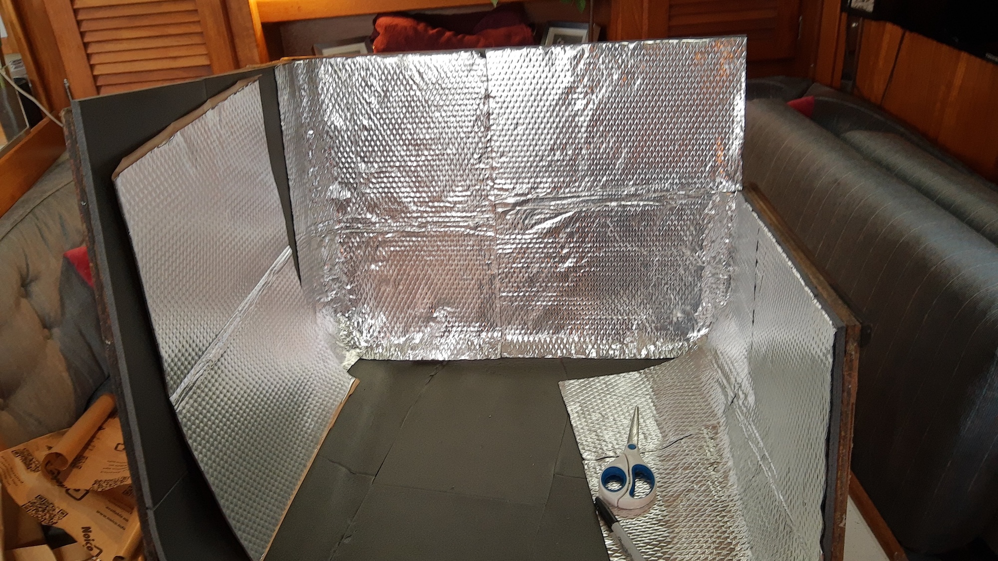

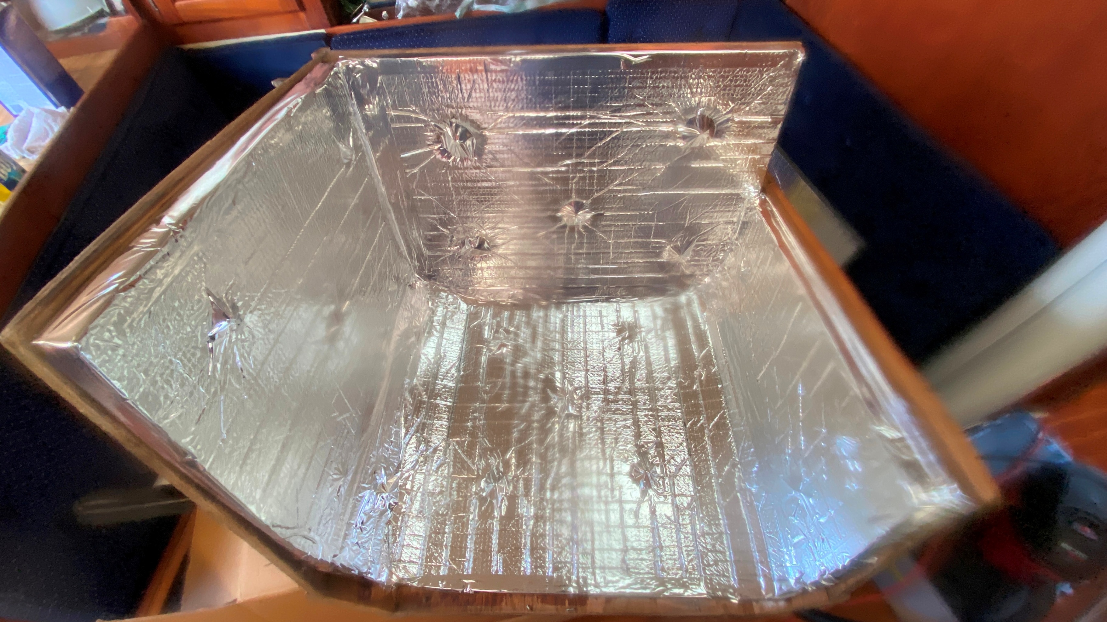

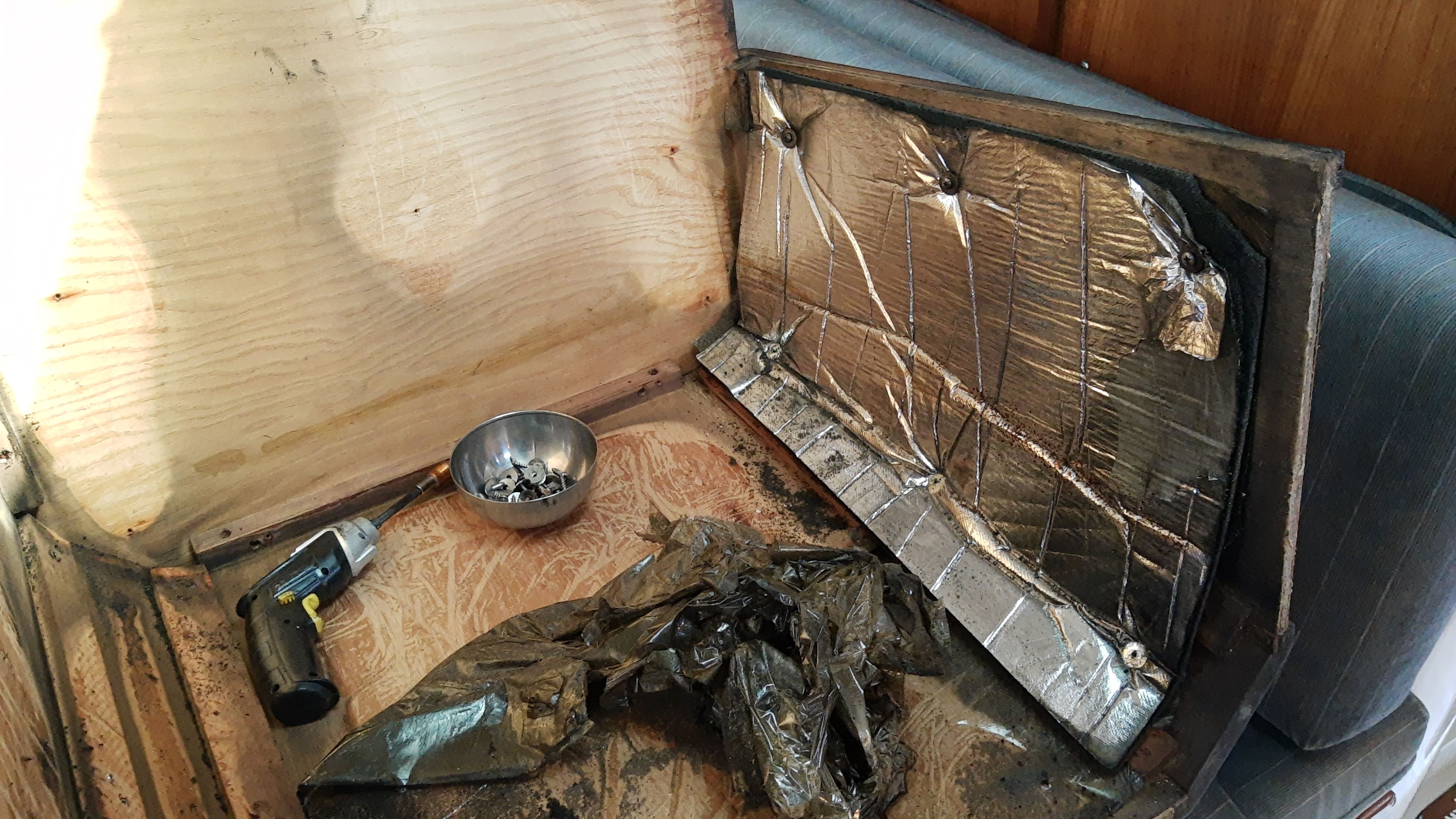

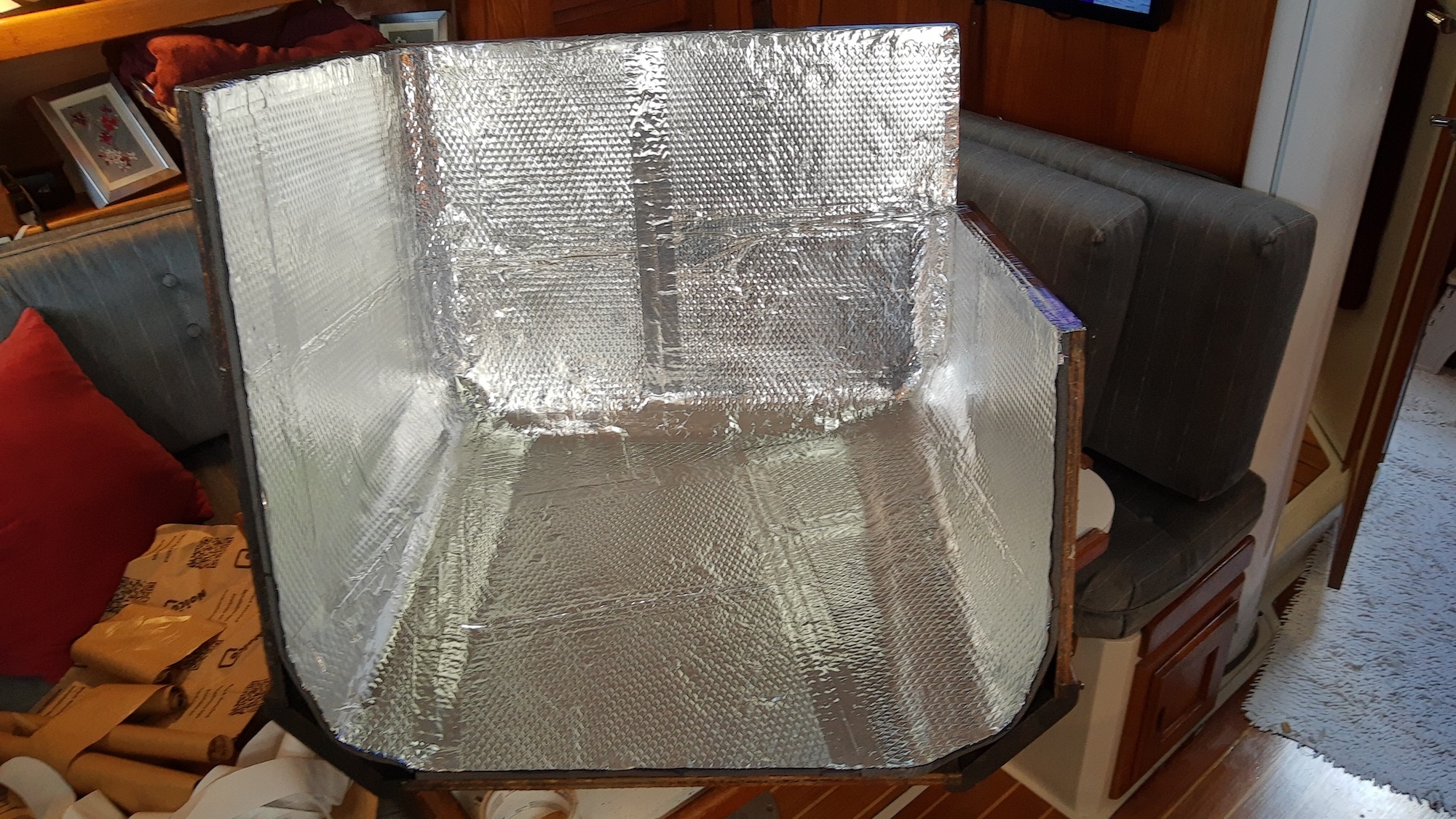

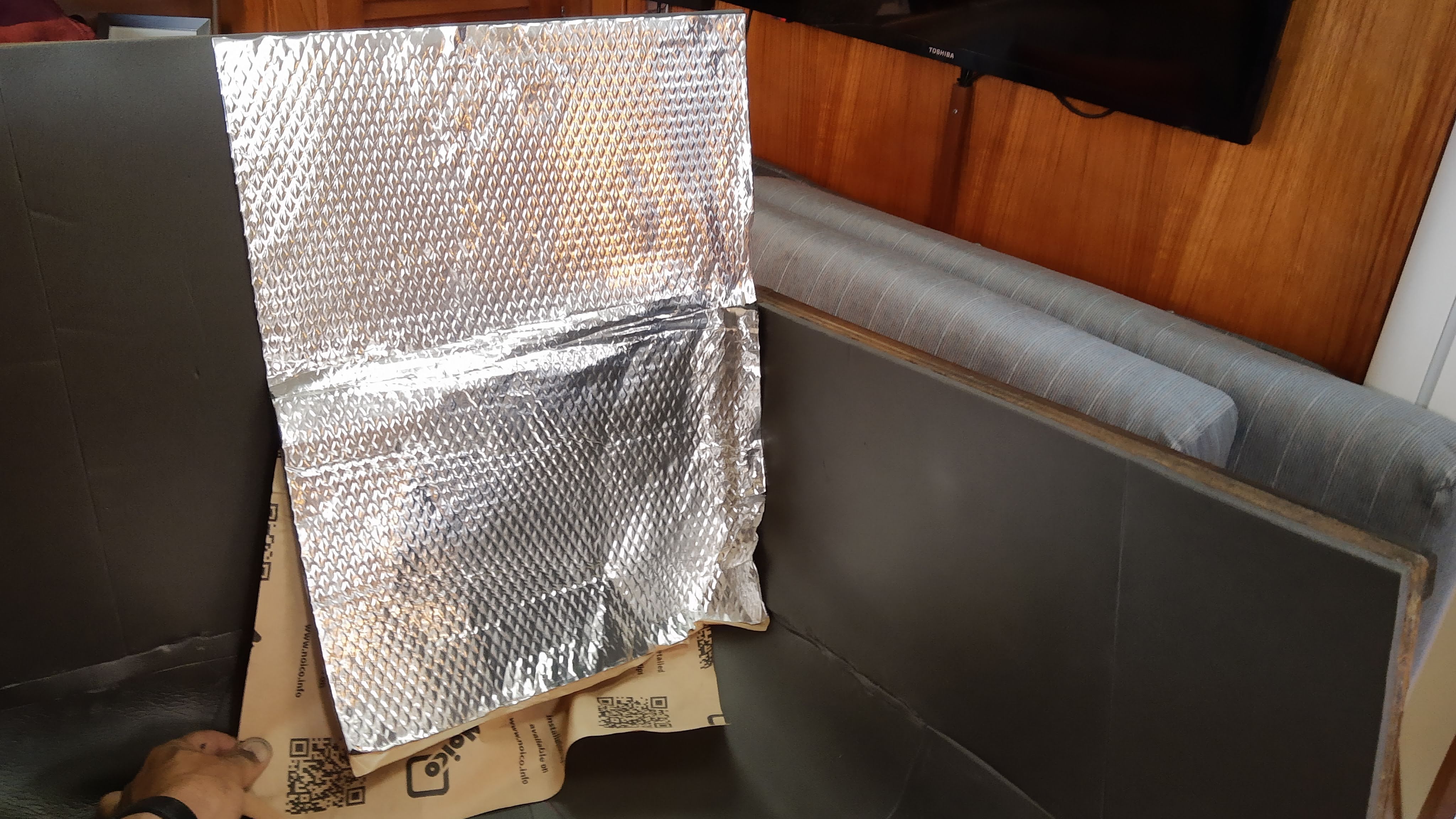

Rich, I checked the decibel level outside the box with the original material and then after I installed the two layers of first dark grey foam, then aluminum backed foam and found no real improvement, but the old stuff was falling off so it had to be done. That was about 8 years ago. While the corners that get squished regularly have been compressed and the aluminum has mariginally peeled off, in general it has held up. See pics. I got all the materials from Amazon, usually called automotive sound dampening material or somesuch.
