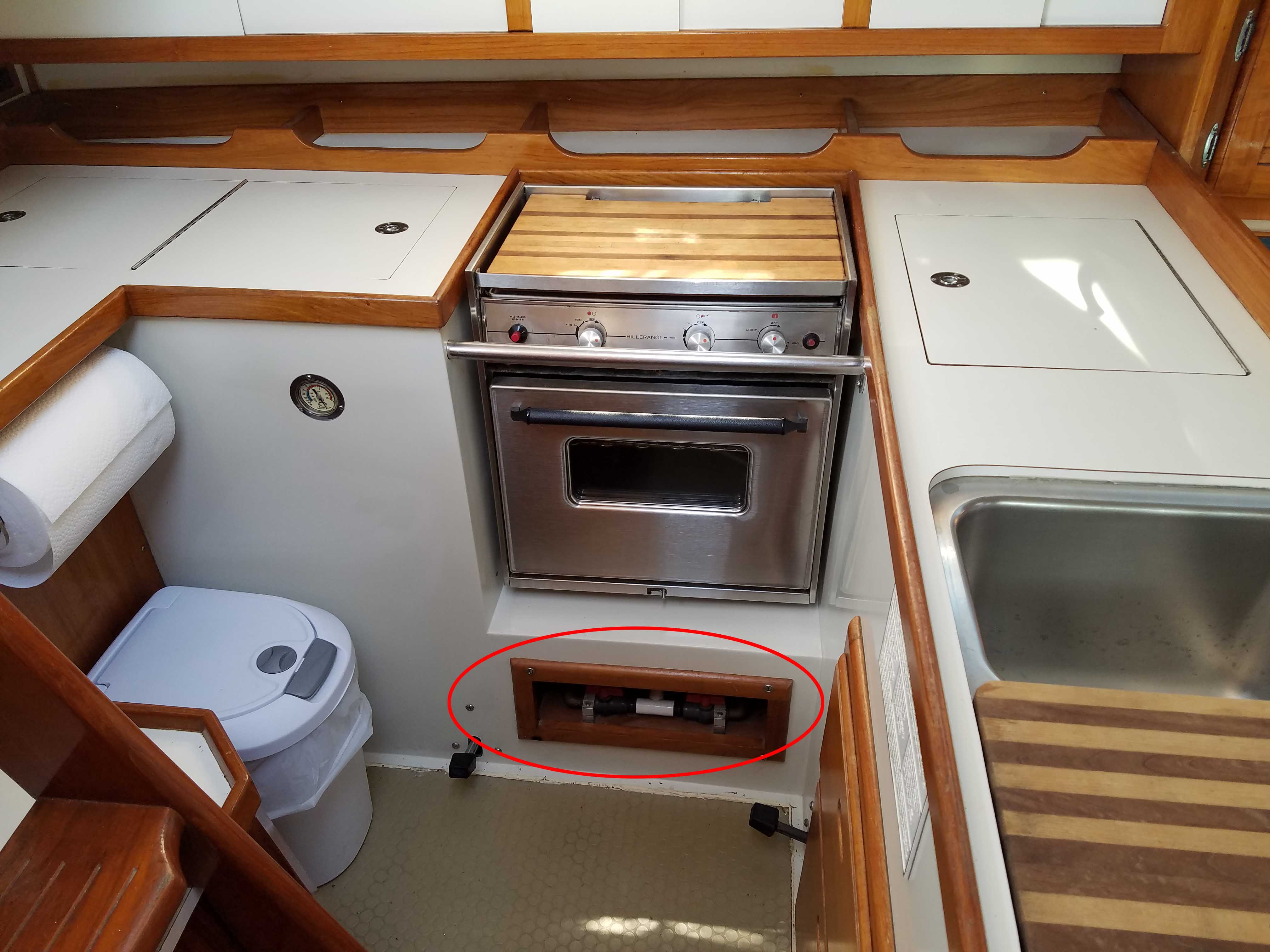

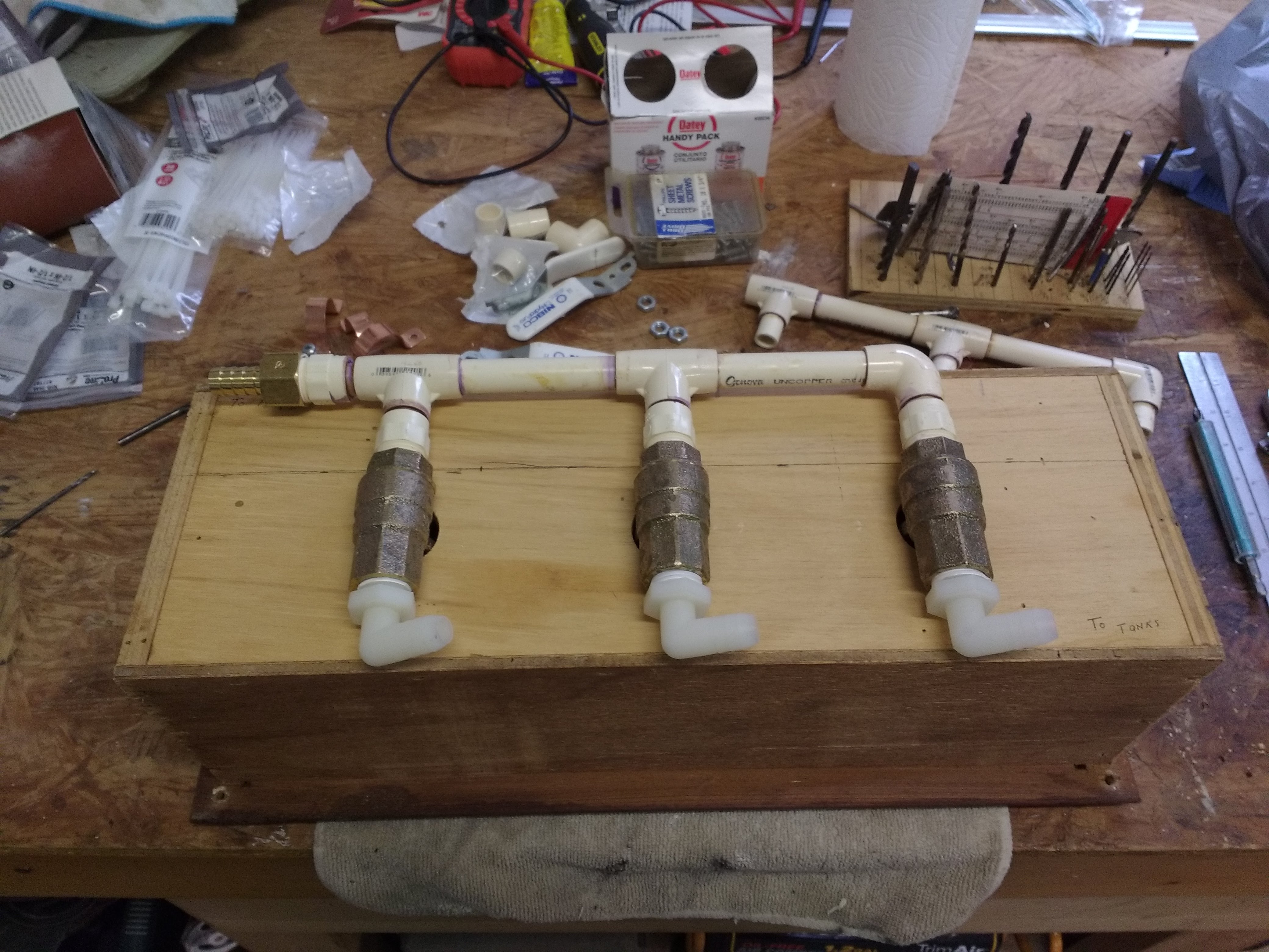

I am planning to add a bow tank as well but it hasn't made it to the top of the list yet.  I am installing a valve assembly this spring to give me easier access to switching the tanks and I have added a valve for the additional tank. There is an upgrade article by Bruce Landsberg in the members only section on the valve setup.  The valves are located in the small shelf below the oven in the galley.

That's what these valves were supposed to be for?  Mine don't appear to be connected to anything, and neither the dealer or the surveyor knew what they were for.  Thank you for solving the mystery!  I have the 3-tank, 3-valve setup, with the valves under the dinette settee, so the PO must have done this at some point.

Don:  Your setup might have been for the two foot pumps in the picture. One for that galley/refrigerator drain and one for a sea water rinse in your galley?  Not sure - they could still have been for the fresh water tanks - hard to tell.
