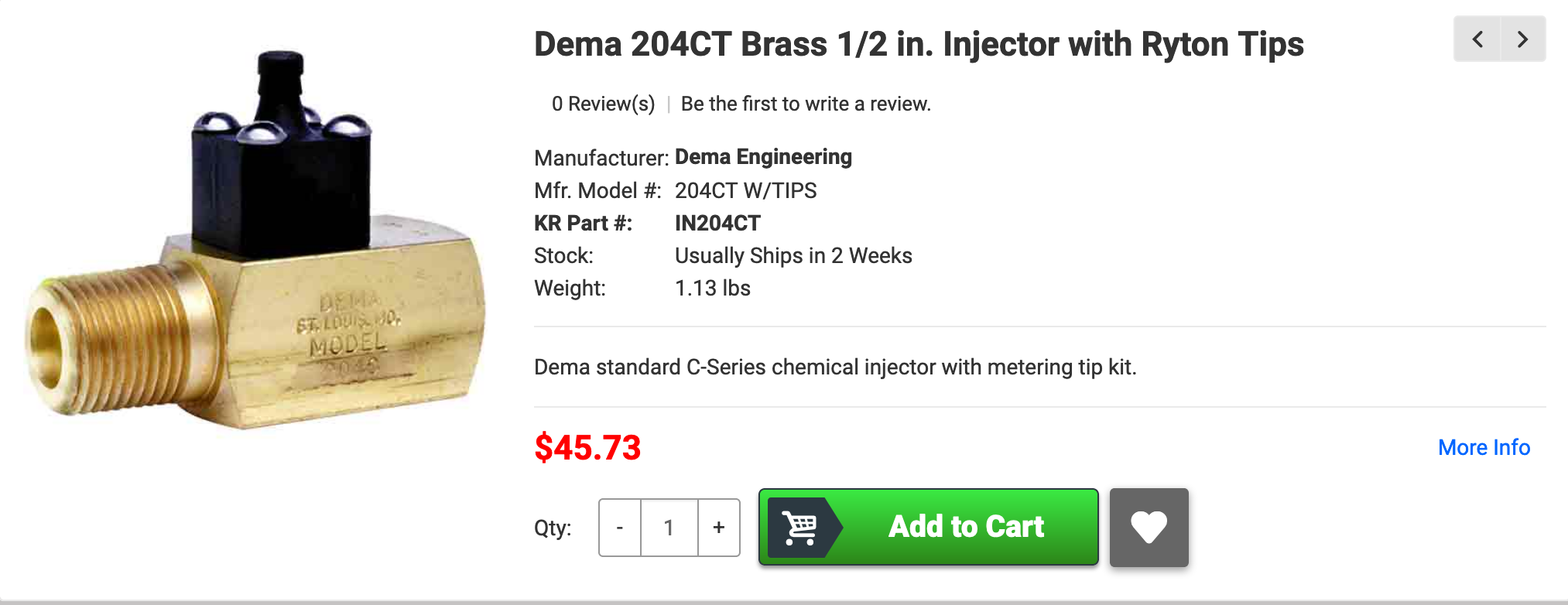

I have a 16K Mermaid ac unit. I installed a venturi condensator valve about two years ago from Mermaid and paid about $200.00. It stopped working even though it has been throughly cleaned. Mermaid would do nothing about it. So I found out where they get theirs from. It's only $45.00.

Thanks - I was about to buy this Marvair kit from Defender for $160, but this is packaged with all the tubing and clamps (a $50 value!).  Before it failed, how did yours work?  https://www.defender.com/product3.jsp?path=-1|6880|2061076|2061077|2061085&id=2756613

When it works it works well. I spoke with Tom at Mermaid and he said that on occasion they will get a condensator in that for what ever reason will not work no matter what you do with it. He didn't know why that is.
