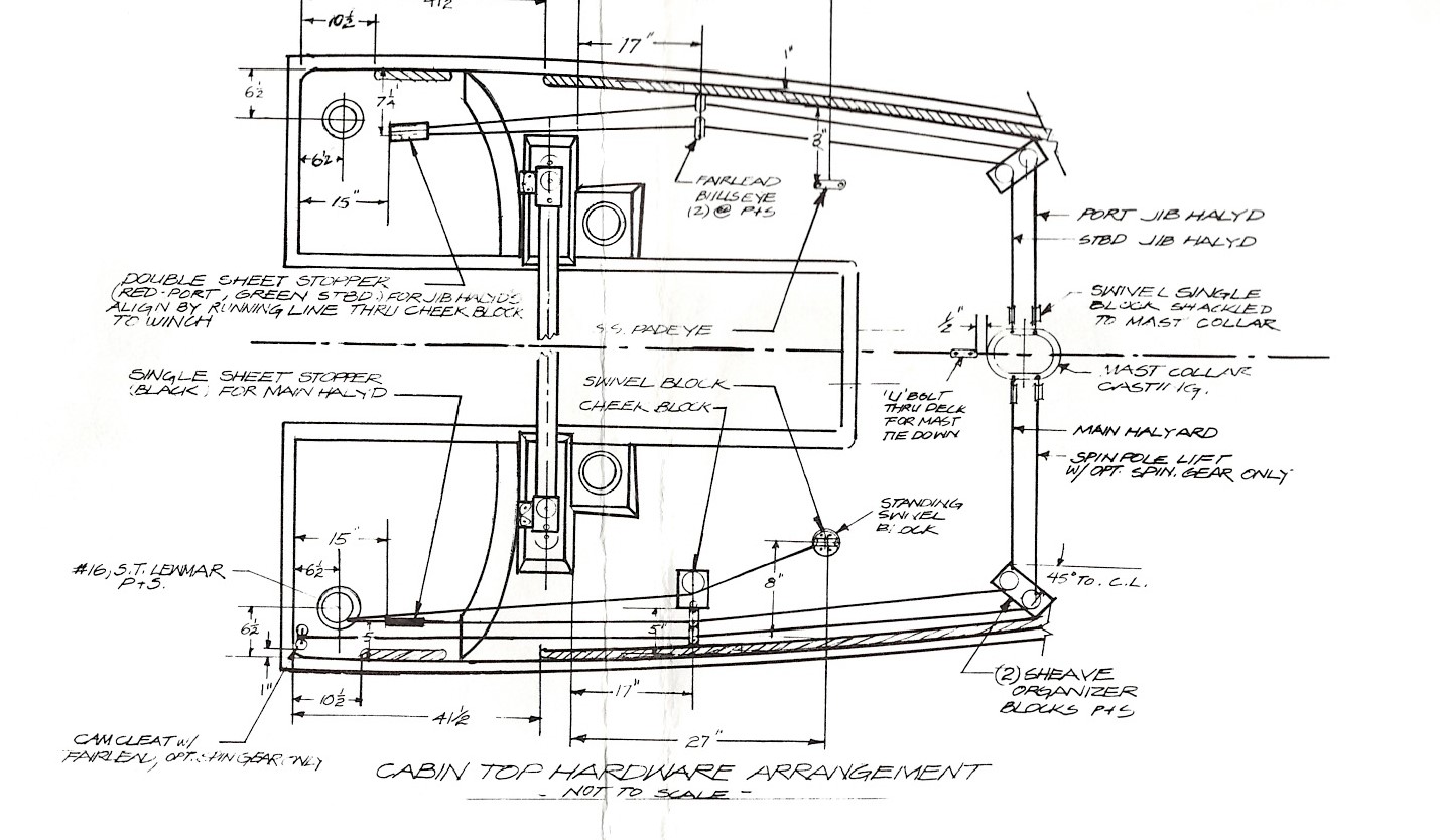

Mike,
On my 1985 C36 MK1, the mainsheet starts with a deck mounted pad eye on the port side and then goes through the blocks on the boom and traveler.  The free end of the line then goes to the stand up swivel block on the starboard side, which then leads to deck mounted cheek block which turns the line to top of the cabin through a rope clutch to the winch.
The drawing above is from the original manual.  Mine is, of course, different now , but the swivel block and cheek block are clearly visible on the starboard side, the pad eye is across from the swivel block on the port side.
HOpe this clearifies things.

Thanks! Mine is set up exactly like this drawing.
