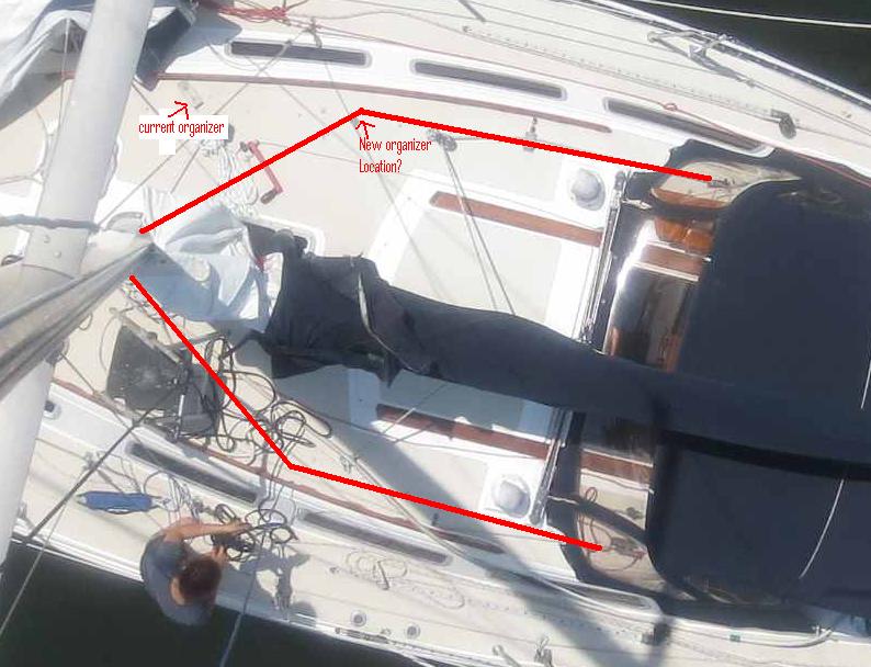

Since we're planning to replace the old-style (and barely functional) OEM curved traveler over the upcoming off-season, we're looking into revamping the other control line arrangements as well on our Mk I. We've always handled sail-raising / dousing and reefing from the mast, in part because the existing deck hardware created way too much friction to operate the halyards from the cockpit (and there was no hardware leading the reefing lines to the cockpit.)
It seems to me that part of the problem is that the OEM organizers lack ball bearings, and also require a 90 degree bend. My thinking is that installing new high quality organizers, located further aft so that the lines make a much shallower turn, will reduce the friction significantly.
Attached is an overhead photo of the current deck arrangement, on which I've marked the proposed alignments of control lines. Wondering if any of you have done something similar, and if so, how did it work out? Photos and other info (hardware brands, etc) would be great ....
I see from his excellent photo archive that Tom Soko did something like this on Julandra (and, among other things, moved the winches, as we must do, since the current stupid arrangement means we can only crank half a turn at a time because of the dodger), but I haven't seen any pictures of the configurations on the coach roof (forward of the dodger).

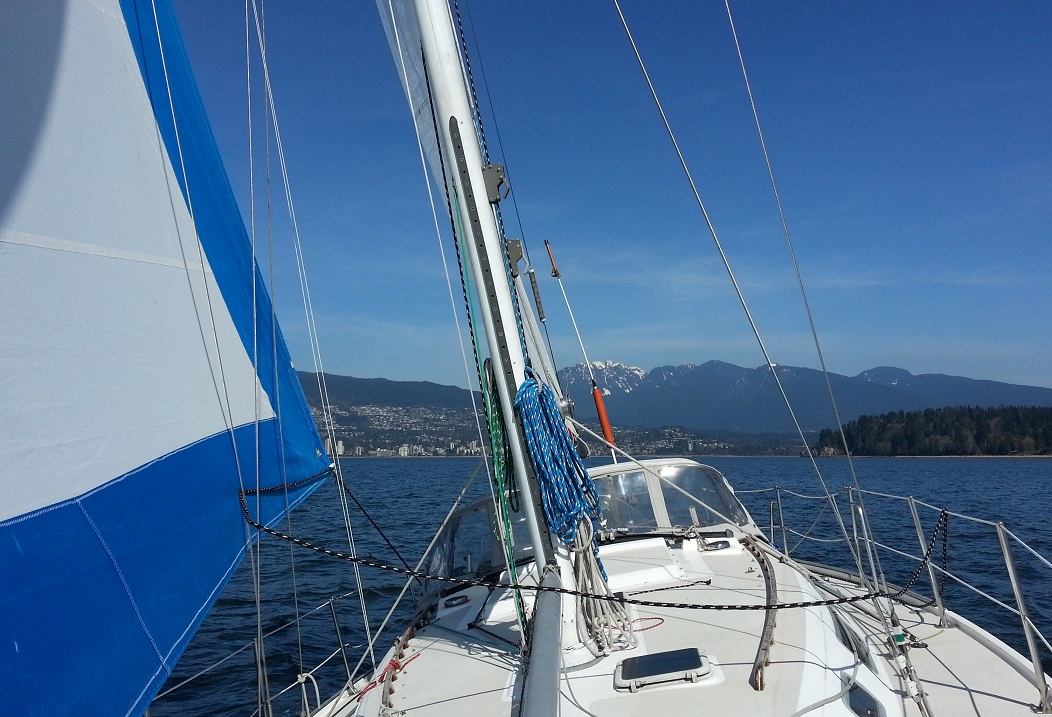

This one shows, if you look close on the stbd side, the spin halyard (black) going inside the traveller mounts, and the spin pole lift (green) going outside in the original mainsheet leads. Both about the least angle I could manage.
Note that I did remove the wood hatch slides from my boat, mostly because I did not want to maintain them but also to clear more room for lines.
The two clutches on the side of the mast are the genoa (blue) and main (white) halyards.

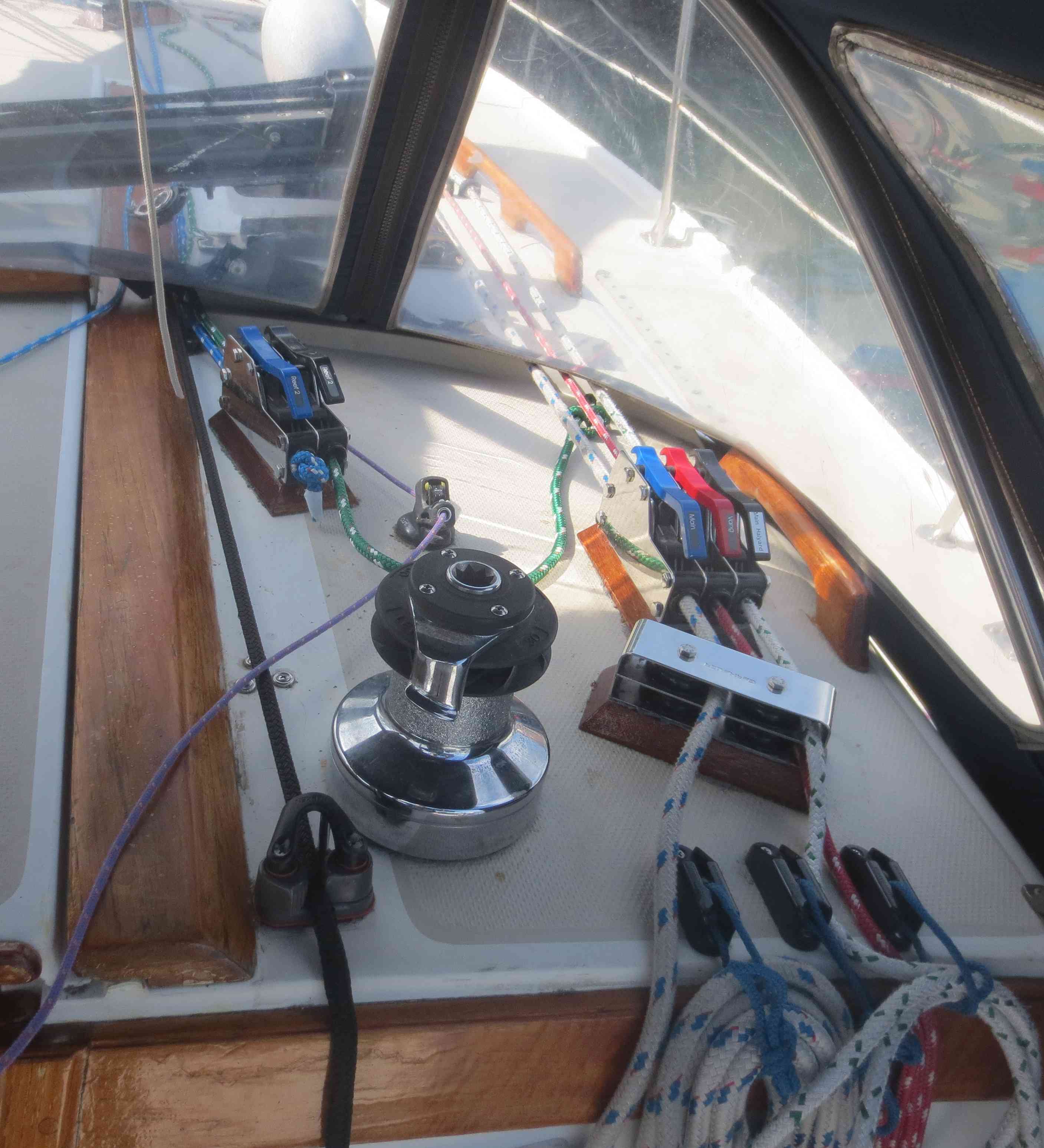

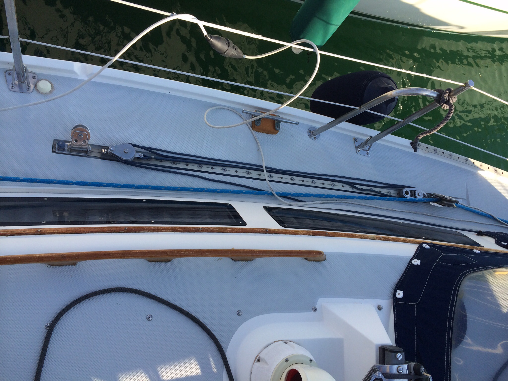

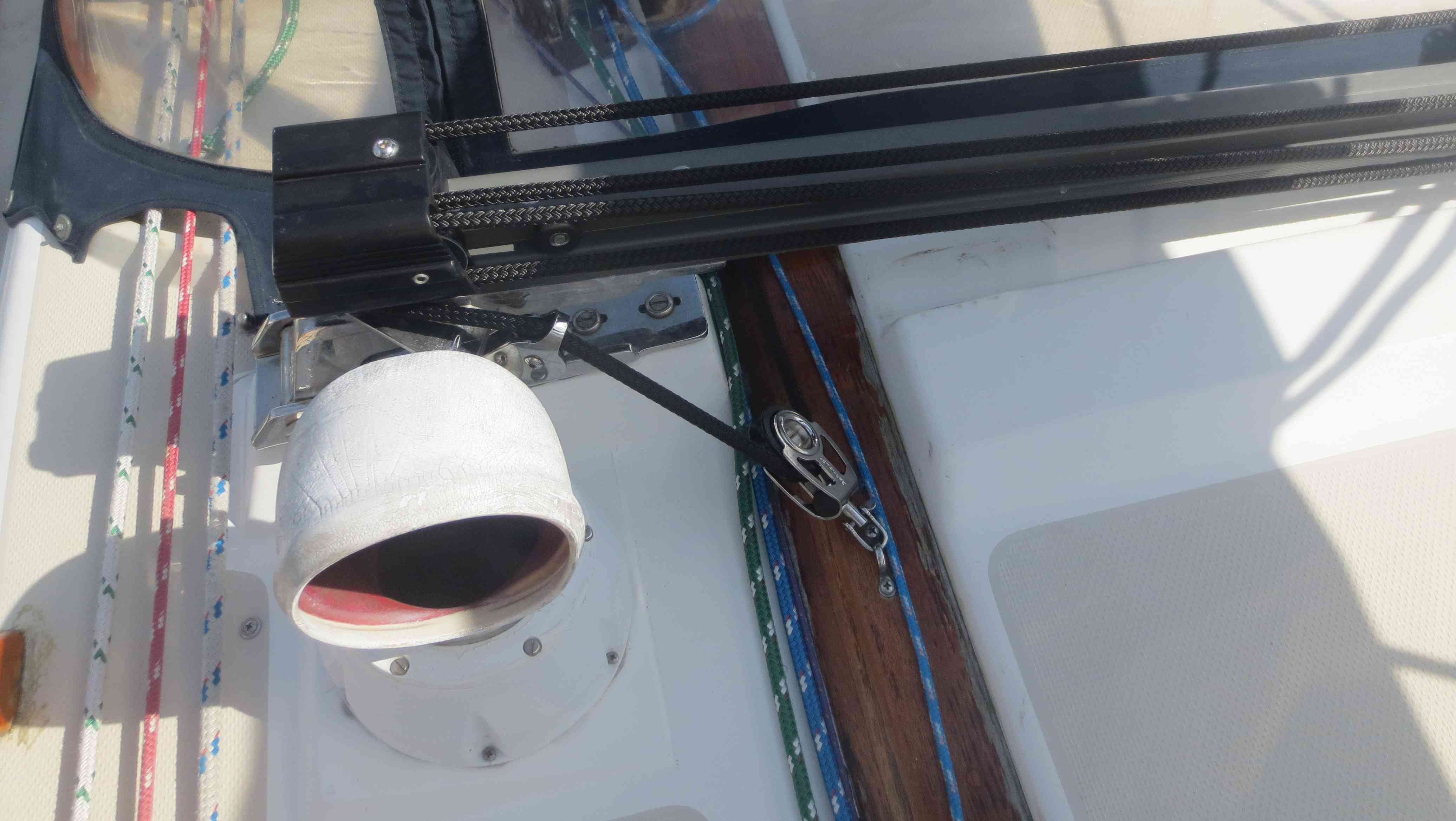

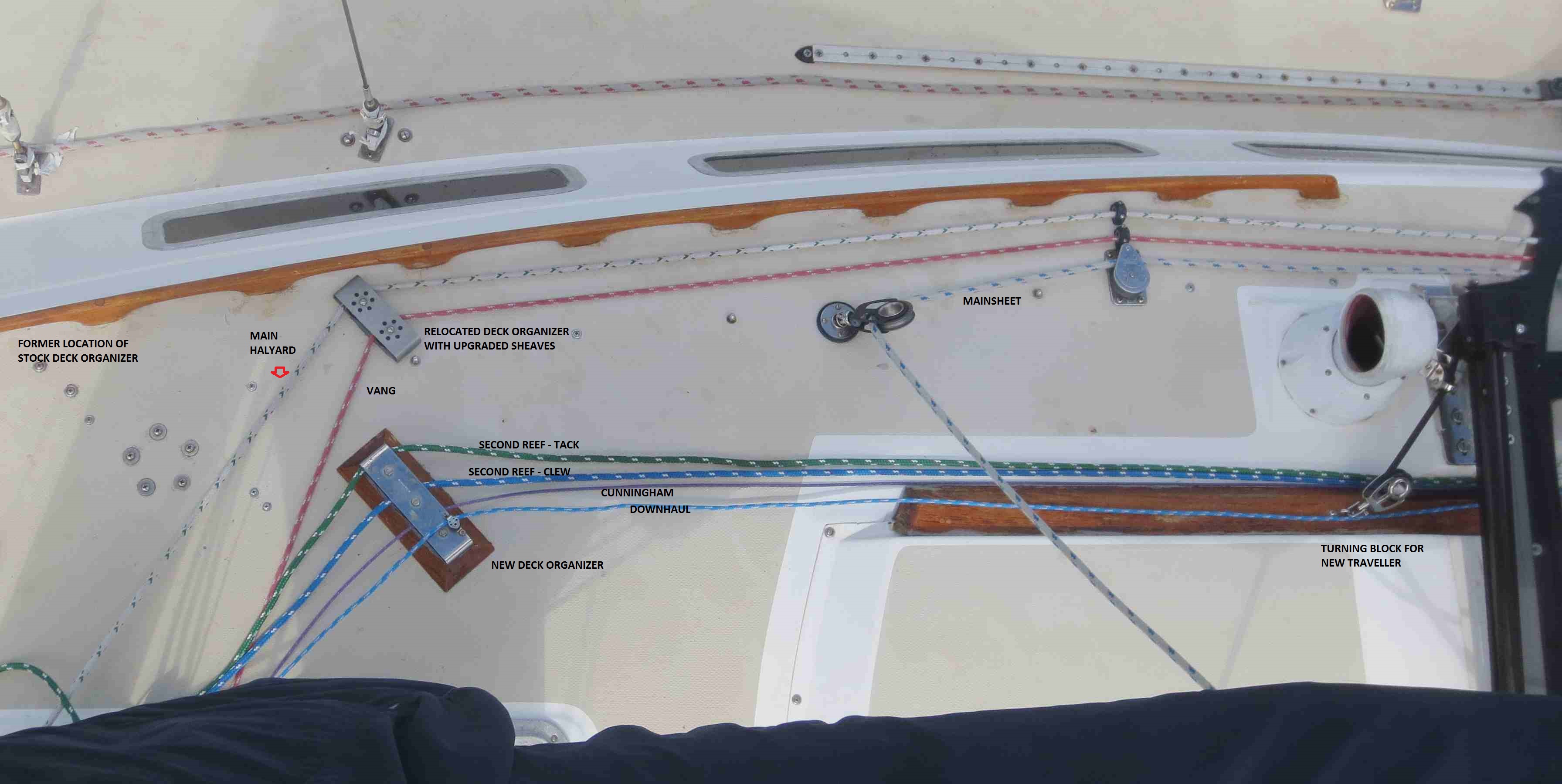

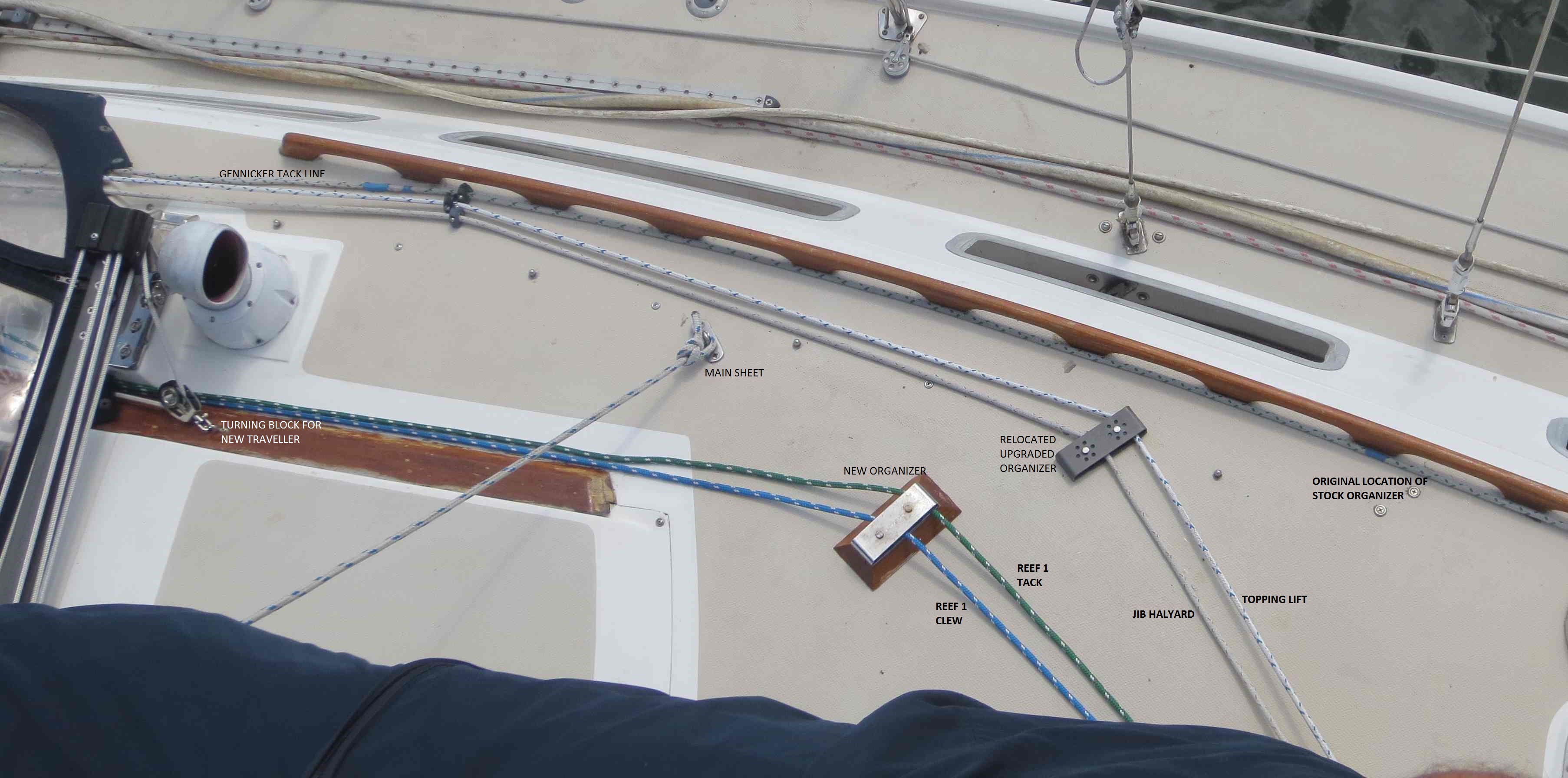

    Thought I'd circle back and report on the outcome of this project, which took place over the past winter (but didn't get around to photographing until now).  In addition to relocating all the control lines so that we could operate all of them from the cockpit, we replaced the OEM curved (and barely functional) traveller with the Garhauer (which works great), and added a Dutchman furling system (necessitating the addition of a masthead-controlled topping lift run over the spare sheave at the masthead and run down inside the mast and aft to the cockpit).
    Attached are some pictures of the system we've been using this season.  Moving the original organizers aft somewhat so that the turning angles were shallower (and replacing the original blocks  with ball-bearing upgrades from Garhauer) definitely helped (we can now raise the main from the cockpit, although we ended up having to add a small line to help pull the mainsail fully down -- maybe we need to upgrade to ball bearing sheaves at the masthead) (Subsequent update -- no longer an issue once we installed a Tides Marine sailtrack).
    The first two pictures show an overhead view of the control lines rerouted on the cabin roof (with labels).
    The next two show the new traveller from Garhauer (note the way we arranged the control lines for it; they leave the traveller and go slightly forward and then turn under the traveller and dodger into the cockpit, worked with Guido on that one); and lastly the control lines in the cockpit.  This is a dream to use compared to the original.

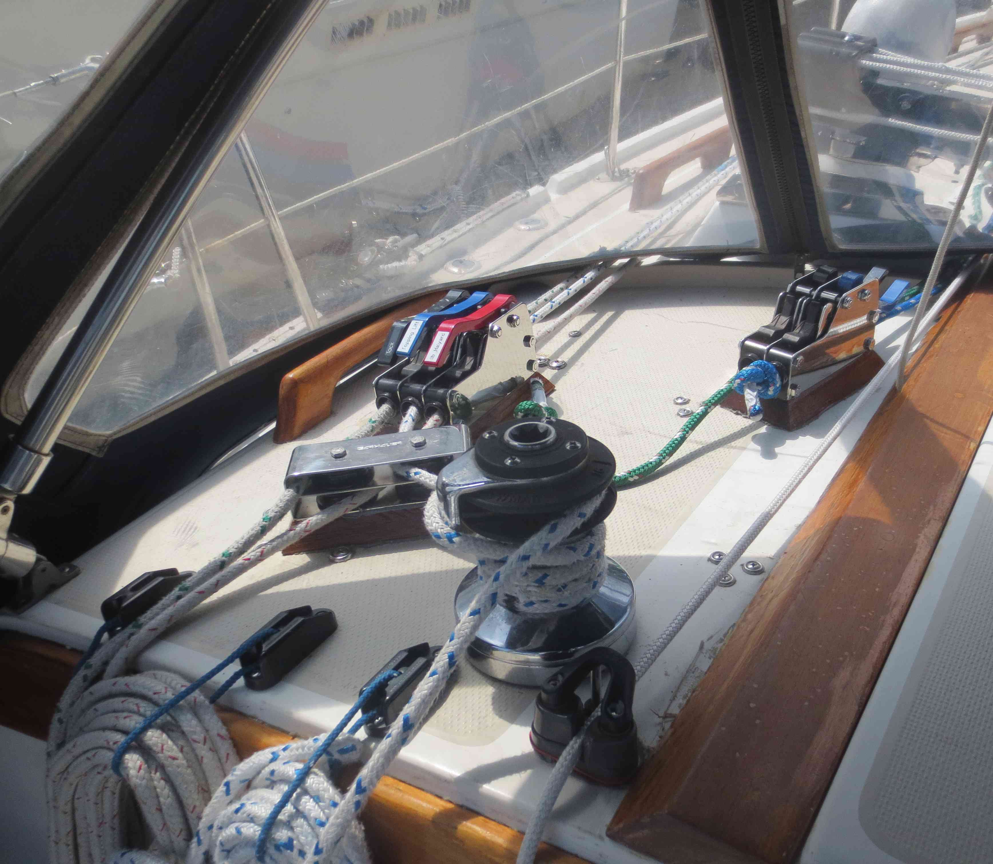

    In the last two one can see that -- copying Tom Soko's modifications to Julandra -- we moved the winches inboard so that we can rotate the handles fully without getting stopped by the dodger (later model C36s didn't have this problem!), and added new rope clutches and organizers.
  The lines one sees in photo #5 are as follows (from left to right):
 - Downhaul (small blue line)
 - Traveller (black line)
 - 2nd Reef Clew (heavy blue line)
 - 2d Reef Tack (green line)
 - Cunningham (small purple line)
 - Mainsheet (white with blue flecks)
 - Vang (red with white flecks)
 - Main Halyard (white with green flecks)
The lines seen in photo #6 are (from left to right):
 - Gennacker tack line (white with green flecks)
 - Jib Halyard (white with red flecks)
 - Topping lift (white with blue flecks)
 - 1st Reef Tack (green line)
 - 1st Reef Clew (blue)
 - Traveller (white)

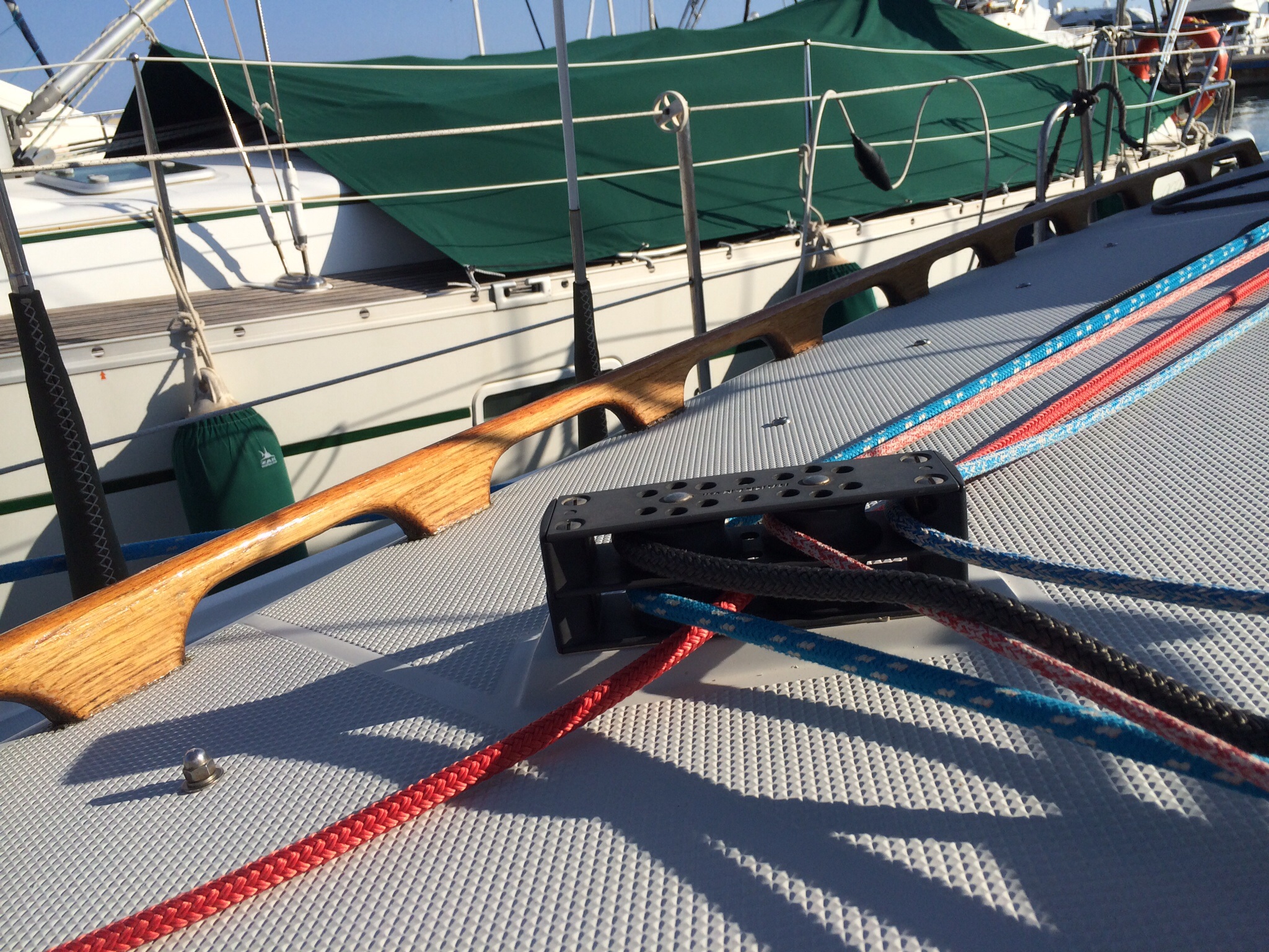

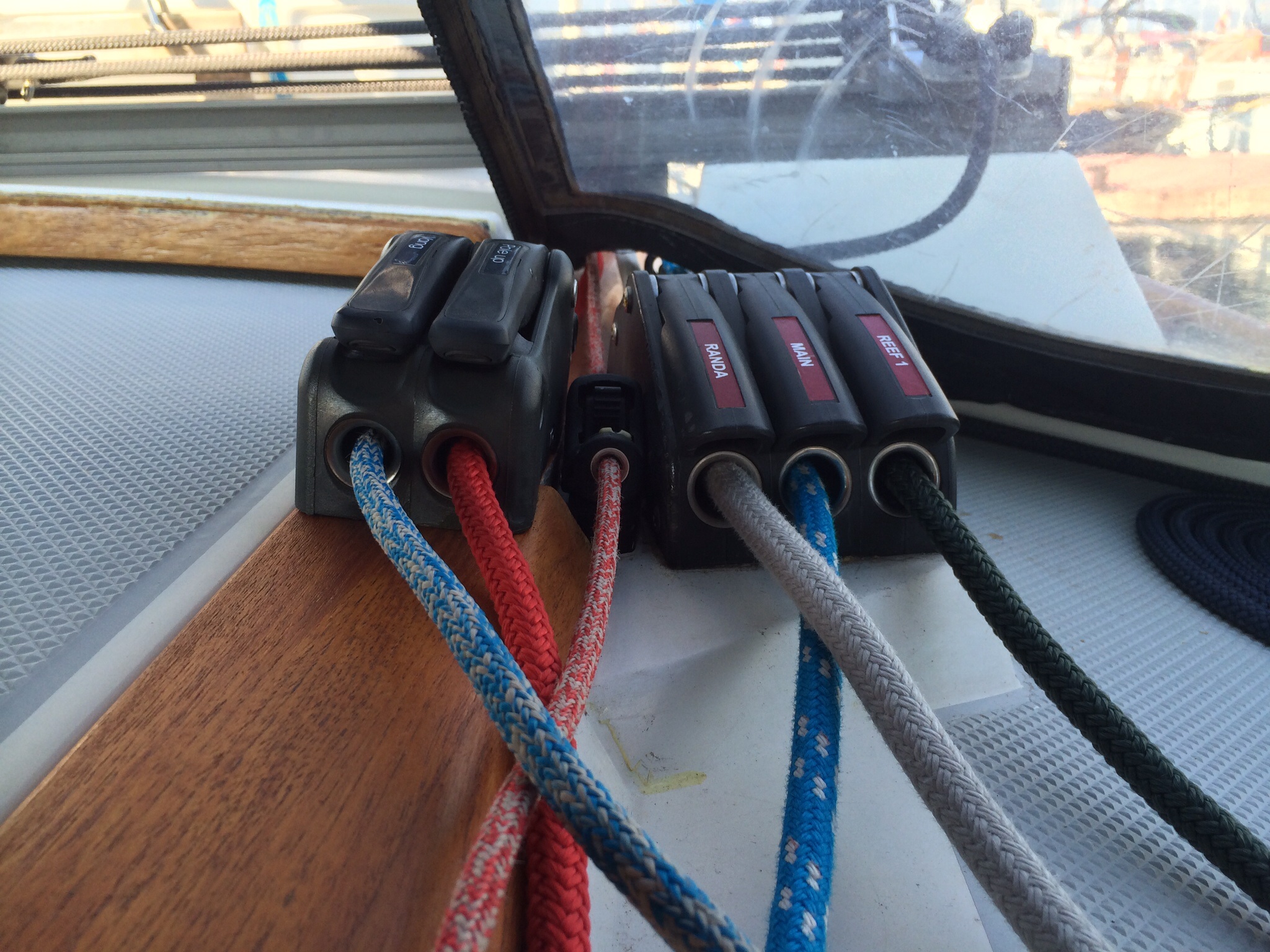

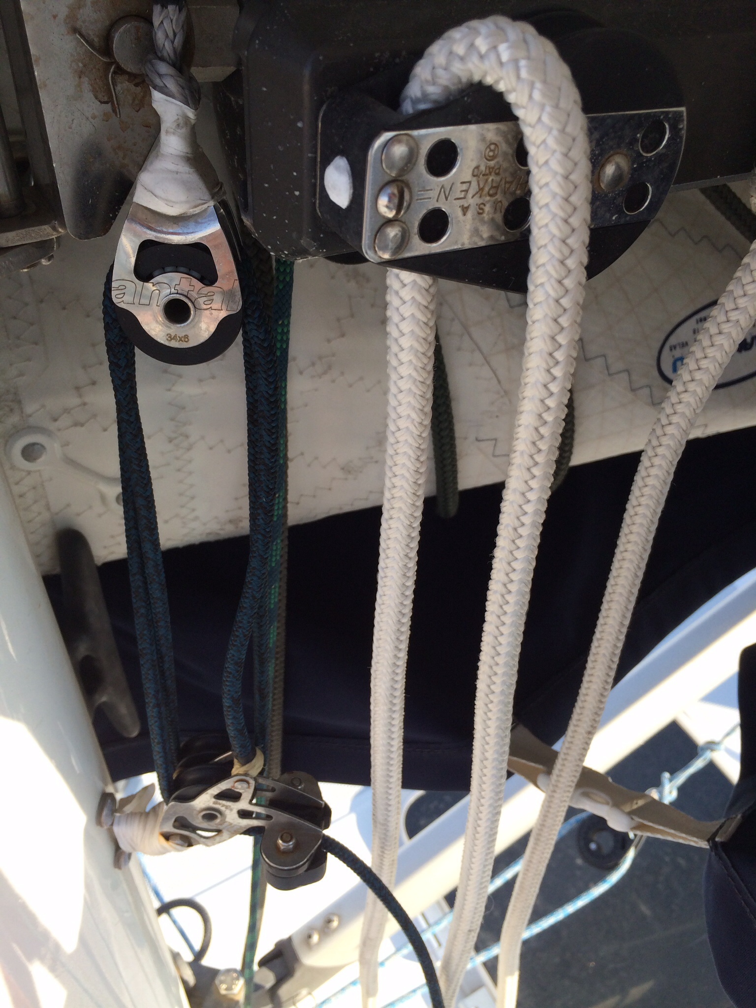

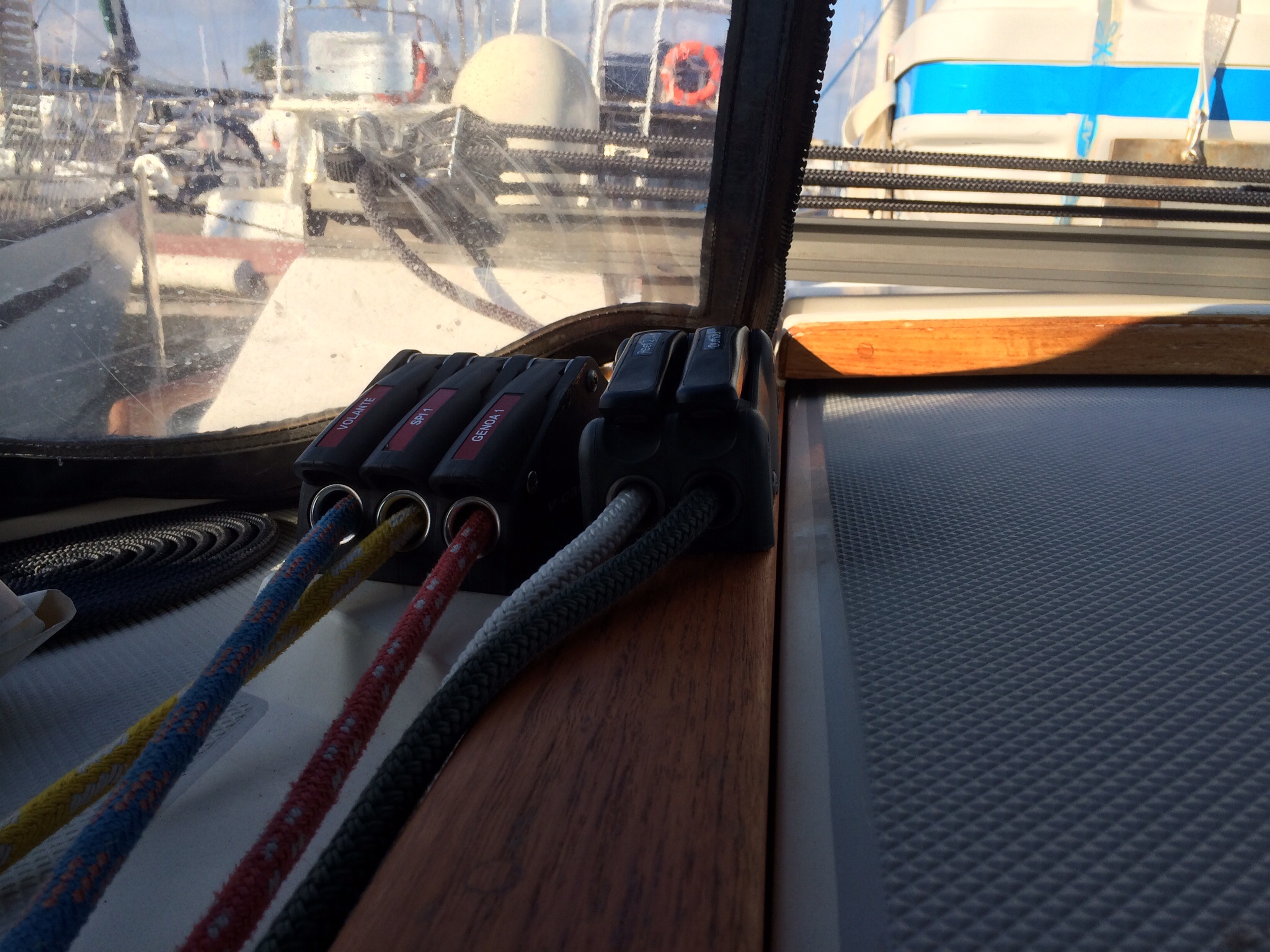

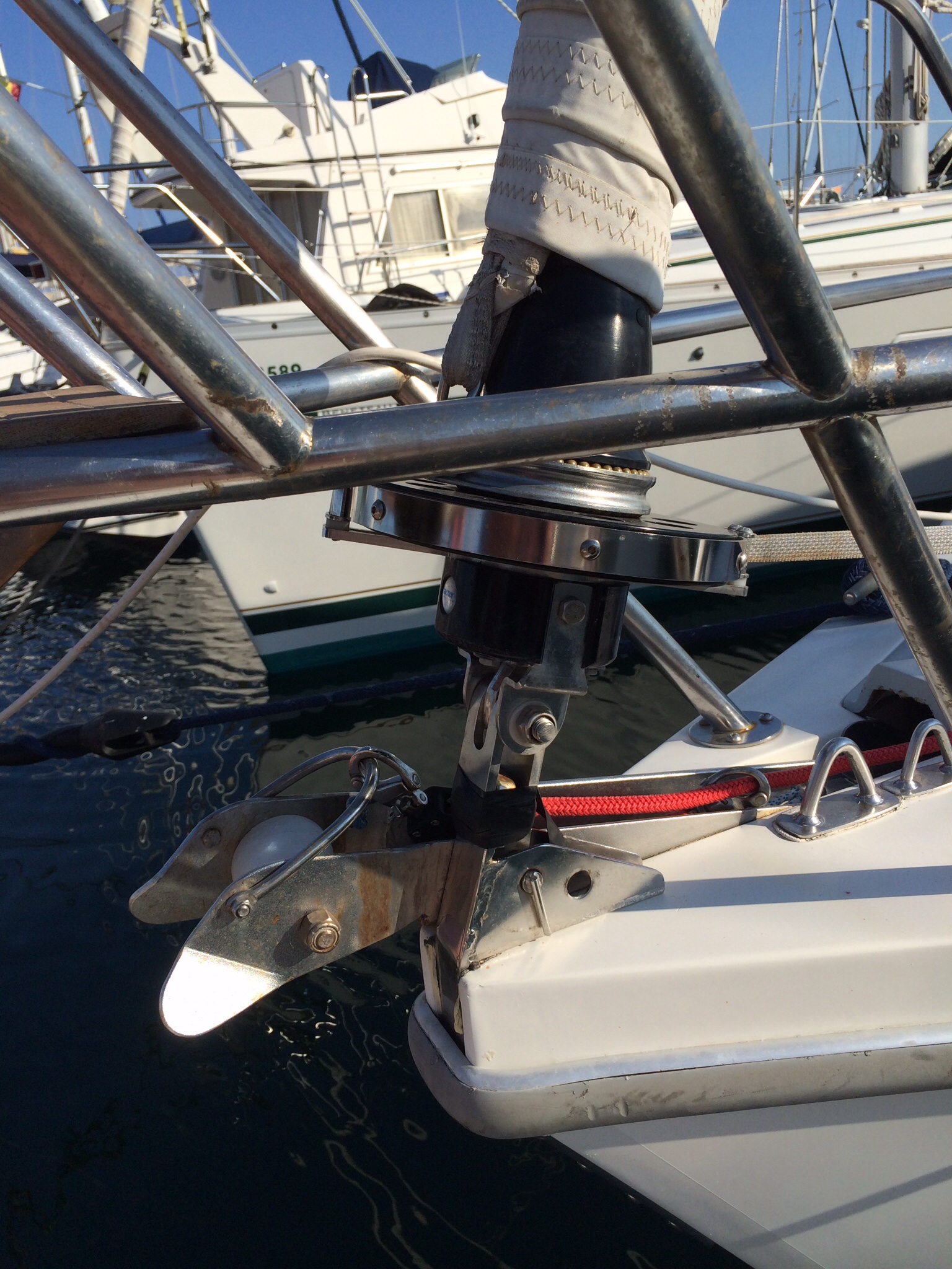

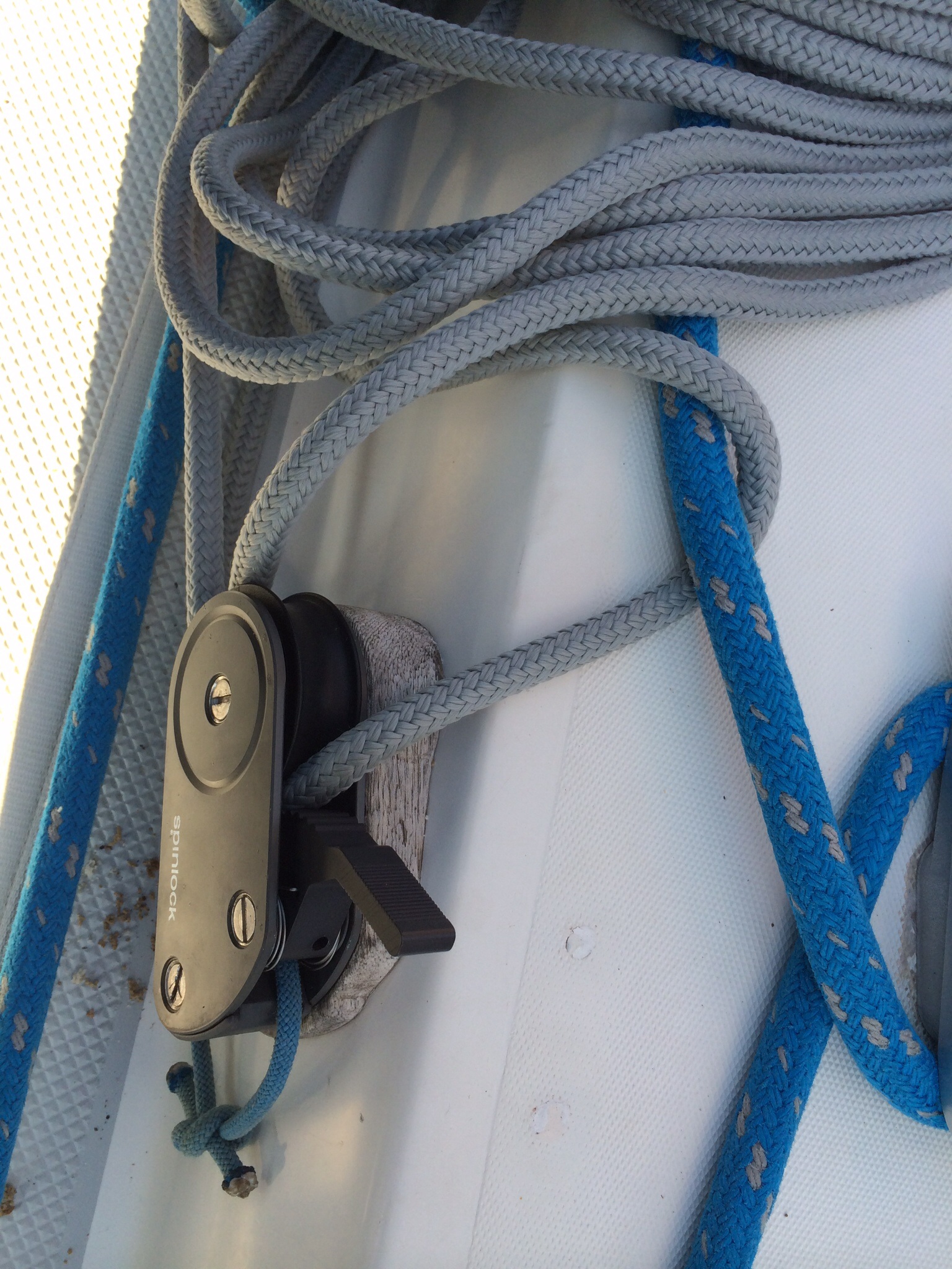

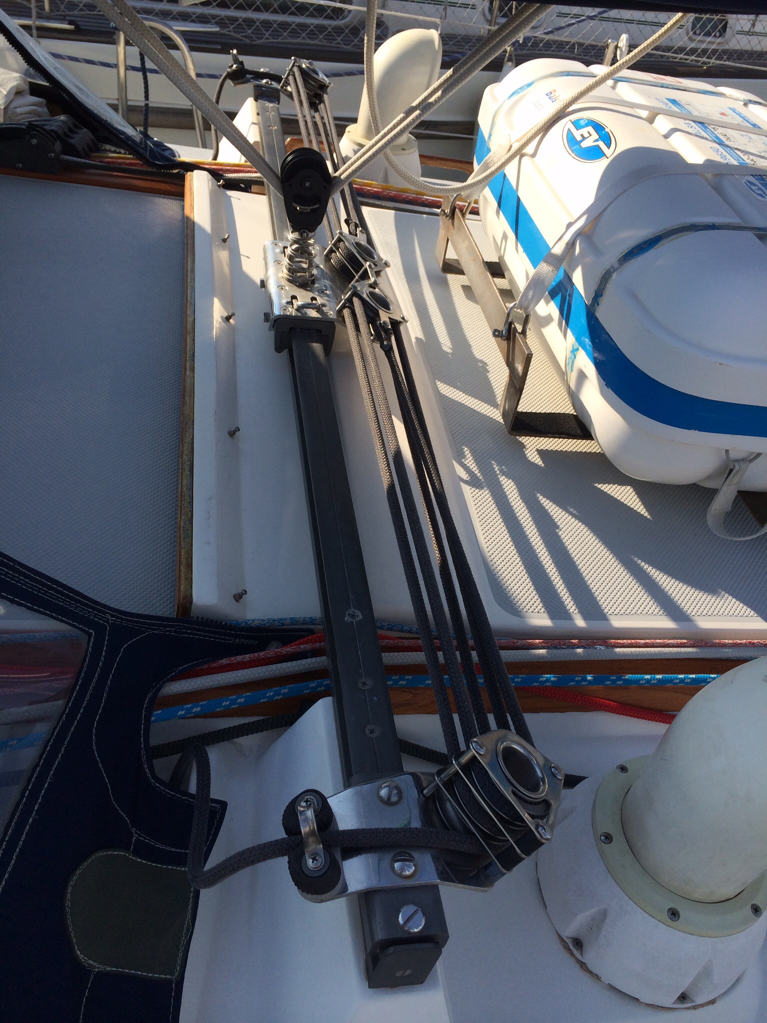

I include some pictures of the modifications done during the years on my C36 (1991). I sail mainly single handed so I tried to bring to,the cockpit all the lines. Only Cunningham remains at the mast. Hardware are Garhauer, Harken and Antal. Backstay is made out of spectra and I managed to run the SSB cable antenna inside the spectra back. Well between the core and the cover. Also a navtec hydraulic is fitted. The furling system was also replaced by the innovative facnor flat system. It really makes the jib works closer to the deck. Inner stay is also fitted so high aspect, Solent or storm sails can be hoisted. Harken single line reefing system is installed, bringing reefing lines to the cockpit. Genoa and main travellers are from Garhauer. Spinnaker barbers are also controlled from the cockpit. All the best and fair winds! <img src="/sites/default/files/styles/medium/public/forum/image_20.jpg?itok=MqyfKFgg" width="220" height="165" alt="" class="image-medium" /><img src="/sites/default/files/styles/medium/public/forum/image_15.jpg?itok=_SDgWZuR" width="165" height="220" alt="" class="image-medium" />
Eladio Vallina
C-36 TR EUREKA II
Hull 1122 (1991)
Home port Barcelona (Spain).
Image icon image.jpg836.82 KB

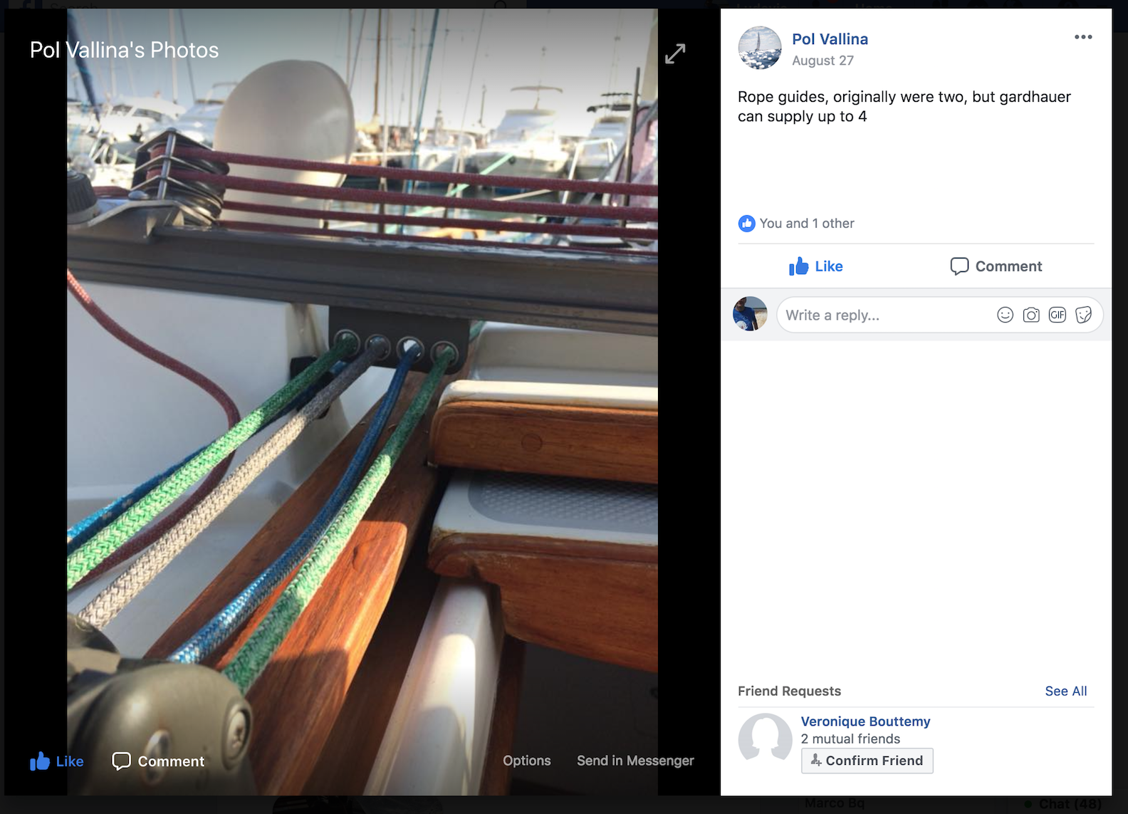

This thread has been very helpful to help me with the look my deck should take. For archive here a great picture was posted on facebook, and a good way to bring 4 lines to the cockpit through the traveler.
https://www.facebook.com/photo.php?fbid=10214661716609783&set=p.10214661...
Adding it, since not always easy to find stuff back on facebook.
