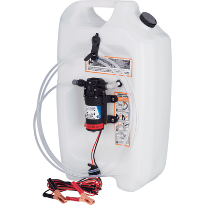

I'll include a pic of the pump I use: Jabsco Flat Tank Oil Changer System, Model# 17860-1012
