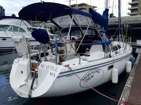

Mark,
I had hand rails made for my pass through on my MK1.5 (1990) I wanted the more classic model when I was doing my search back in 2003. I too wanted a pass through for reasons of getting in and out. Initially though when you pull up in a dingy the ladder was not easy to hold onto getting in and out. I had these rails made so that they went right up to the top of stern rail. I can't tell you how many times we have appreciated this addition. It serves several functions i.e. something to grab when you are approaching in a dingy, able to hold onto when lowering the ladder, additional tie off for visitors, and a huge asset when someone older needs to board. Another note about your comment on storage. I have found that there is plenty of storage on the 36. In fact I haven't taken full advantage yet & I don't use the aft cabin as a garage. I had a Cat 30 with the aft lazerette and I don't miss it.
Image icon Stearn Rail and Transom664.79 KB
