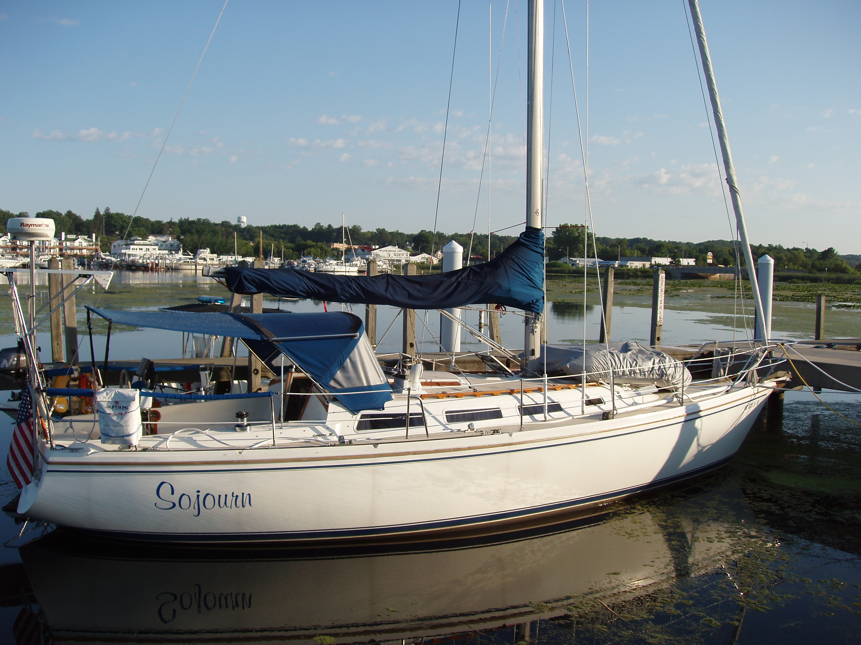

The short answer is yes.  My boat has a high dodger, it's great for protection and visibility.  A previous owner, moved the aft bale forward a little, 20+ years later no issues.  I do not have a photo of the boom, attacheded is an old photo of the boat & dodger.
