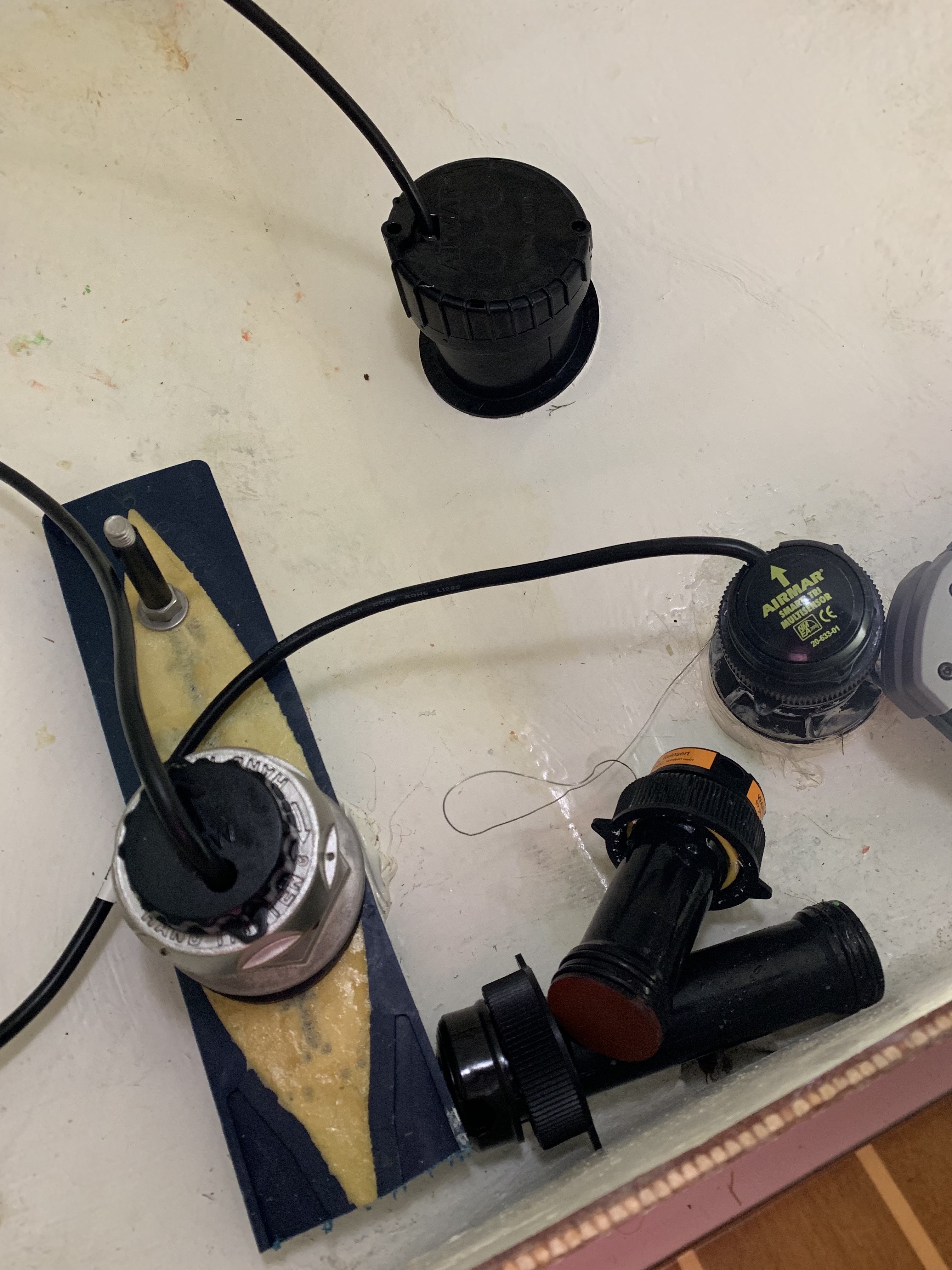

I am using it on my C36. I'ts actually manufactured by Airmar but labeled by B&G and Simrad. It works great, It's basically it's a transducer that is angled in a forward manner.

The forward looking sonar does not connect to a NMEA 2000 network. It is installed directly to the back of the B&G MFD in sonar #2 connector..
2003 Catalina 36
On one Panbo review the guy broke the transceiver before he could test it. A stray chunk of wood destroyed it. As was said earlier it has an angled face that sticks out about 1.5” below the hull.
