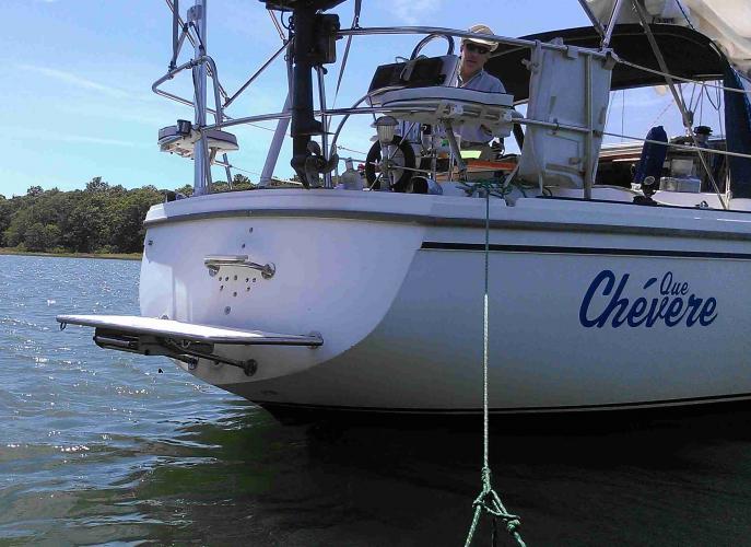

In 2010, I used Boat US for our name: 12" tall x 39" long. $128 for both sides- Navy Blue, no sparkles. Been very happy. Take your time for the application and follow the instructions. Avoid applying on a day with wind! Having trouble attaching photo. Will try again later.
Posts: 703
Photo Attached- 12"x39" Boat Name

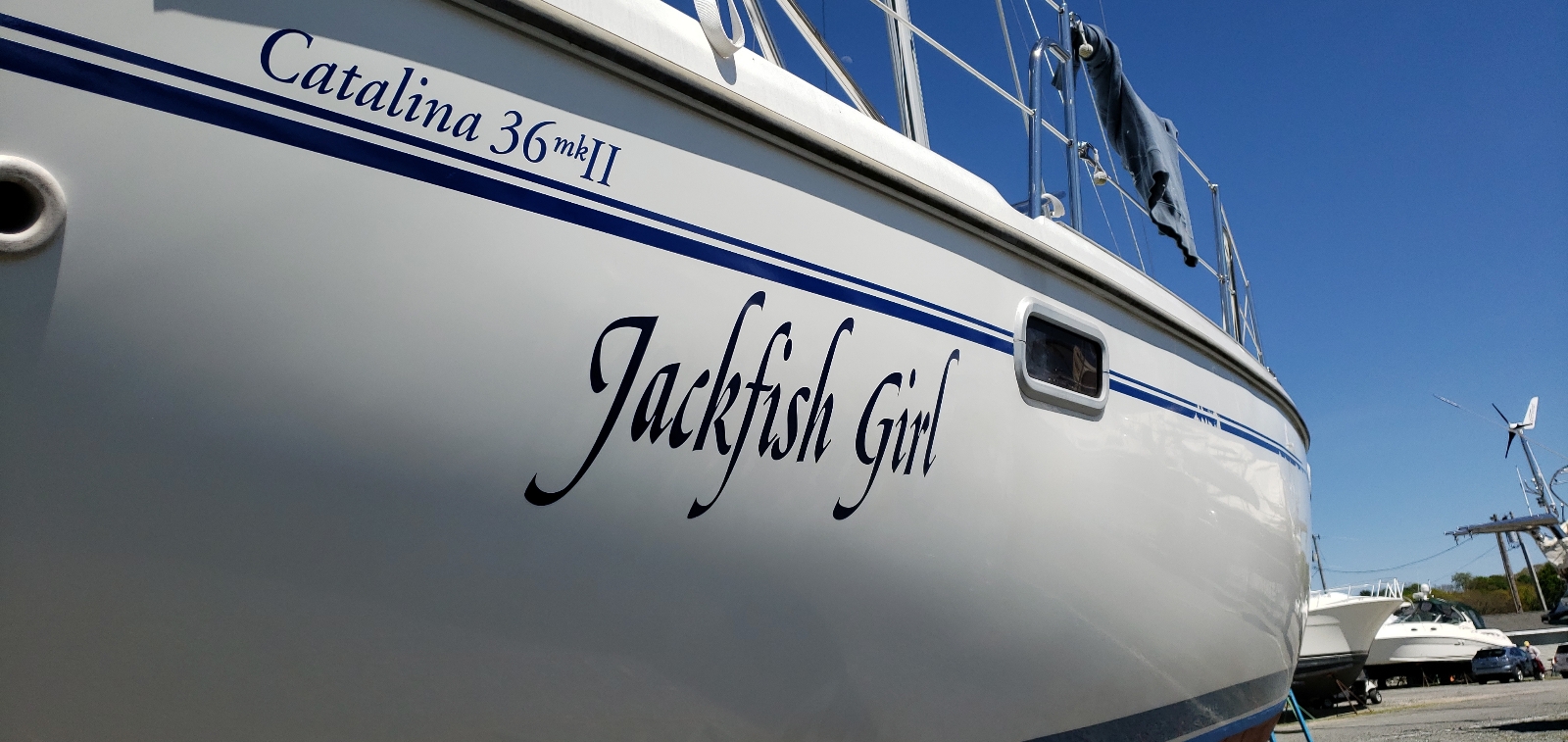

**UPDATE** - The eraser wheel I purchased worked fairly well, with one painful lesson learned. Like waxing with a polisher, this is a LOW rpm operation only. I was using my cordless drill and it's max rpm was still low enough to be fine. When my only battery died I switched to the corded drill. The higher rpm, torque, etc took the first letter off with ease, but left a yellowish shadowing of the eraser material, burned into the gel coat. I was able to dim it down but not completely remove it with rubbing compound. It still passes the 50' rule. The rest of the decal came off fine with lower rpm (barely squeezing the trigger).
I ended up buying a cheaper version of 3M's eraser wheel called a Doca Disc. Youtube reviews were very positive. Maybe I shouldn't have chinced... Oh well.
I think the name decal from BoatUS came out well in the end.

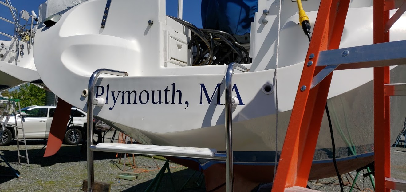

Hey John, thanks for noticing. This time I didn't 'chince' and purchased a really nice Makita polisher. Used Starbrite premium cleaner wax. It came out pretty well.
Looks very nice. I suspect your boat is not Coast Guard Documented. As you would need port of call also.
McFly
Joined: 10/22/18
Posts: 200
Got the port-o-call on the transom as well.  Transferring the CG number
