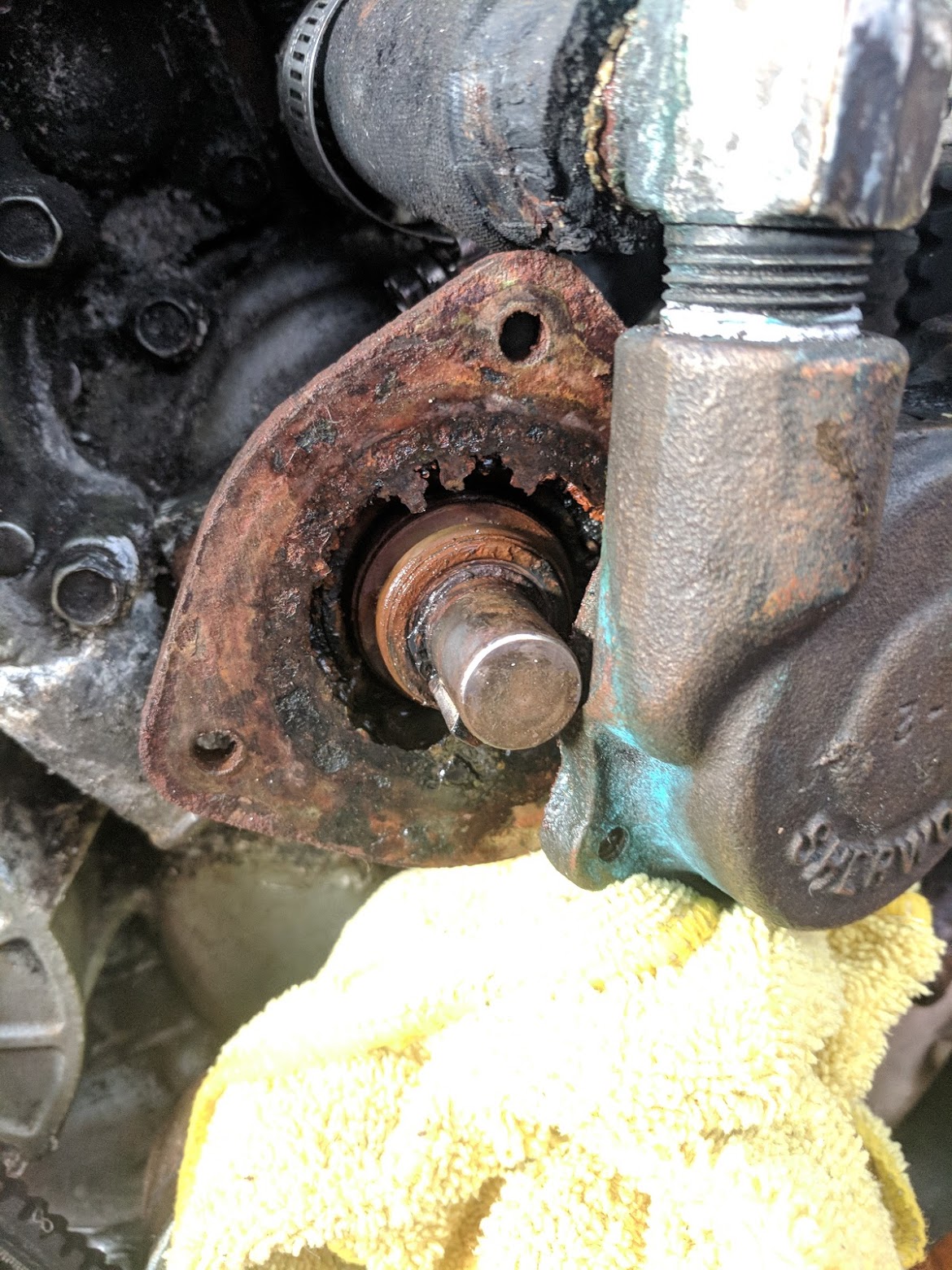

Hi Paul! How did you finally do on your M25XPB? How looks my sherwood pump right now. I guess it's time to replace it.

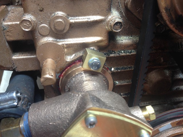

Paul;
Oberdorfer makes a complete kit to replace your Sherwood water pump. It is available from both Depco (Tampa) and Cardinal Pump (St. Louis) - Cardinal is also know as 'pumpsandpartsonline' The kit comes with every thing you will need and does not require any grinding as it has a completely round flange. Please see post https://www.catalina36.org/forum/technical-discussion/raw-water-pumps
The kit number is;
OB N202M-837. The 'KIT' comes with new correct size high tensile strength bolts for mounting to the engine, water pump, new mounting flanges, gaskets and new elbows to connect to the water lines.
I made a Post on the forum regarding this when I replaced my Sherwood with the Oderdorfer. Cardinal Pump will offer free shipping if you say you read about them on the Catalina Forum.
