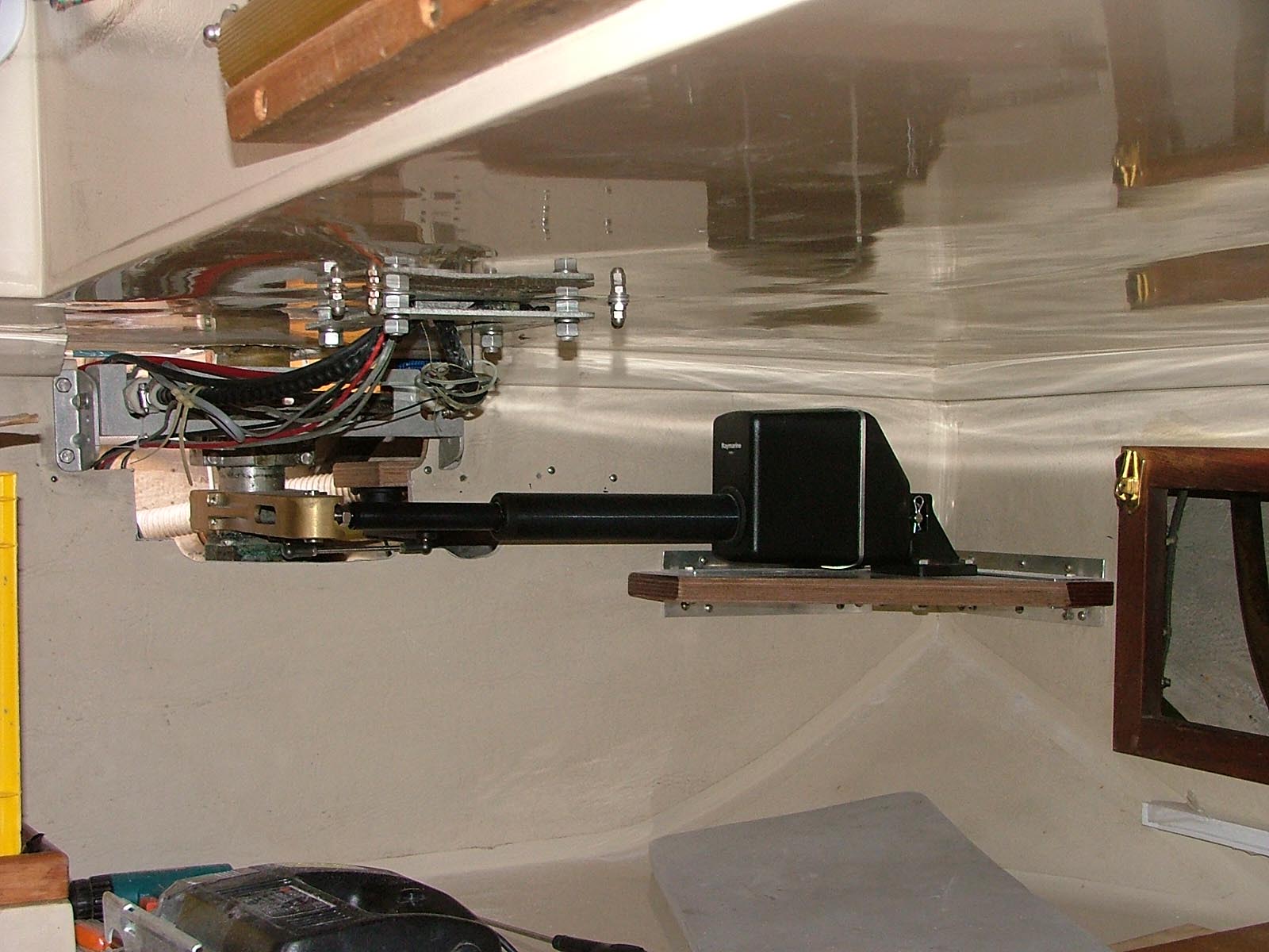

We installed a new underdeck autopilot Raymarine with a linear drive onto it's own tiller on the rudder post after our old 4000 failed to cope with boisterous conditions. we keep the old one ready as a back up. We do longish passages, however (to 12 days or so) offshore.
The previous owner came down from the US to New Zealand with just the wheel pilot [I]singlehanded[/I] though, and I hear the new ones are better...

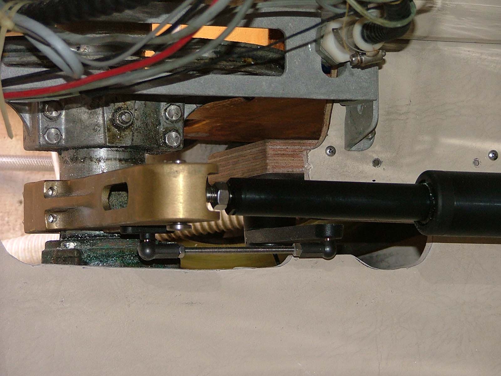

Would probably work... had a quick look at ours:
We used the second hole on the tiller arm to get a bit more travel stop to stop, so ours is closer to the bulkhead than if you use the longest hole of the arm.
The drive must be at right angles to the tiller arm so...
With ours you would need a couple of inches or so of packing off the bulkhead to keep the drive parallel if you mount it there. (Do the instructions allow for sideways mount?)
Other than that, it would probably make a neater installation :-)
Good luck with the job, you will love it when it's done...

Unfortunately we did install ours in the rear cabin, but I like the storage in the lazarette. Also on long passages I like to be able to easily see how things are going with the linear drive. I have fish bins along the aft bulkhead with the drogue and parachute anchor and tools there. We still have a useful double cabin mattress :-)
Hope this helps...
S.V. Wind Star
Rob, those photos look like a sweet installation on an older C36! Kudos.
Gary, as you try to fit a linear actuator in a confined space it might help to make a mock-up of the actuator. I did this on my MkII installation, as is documented in my article. Your mock-up might need to be more three-dimensional than mine, but it's a lot easier to work with a light simulation than with the awkward and heavy actuator itself.

After so much good advice from people I feel it is time to return some. While Larry was lucky enough to have a position on the MK II to mount under the swim platform, on my 1987 Catalina 36 there is no such opportunity. I would like to share with people the set up I built to mount the ram below deck. The only other change I made from Larry’s location of other systems such as of flux gate compass and control head is that the computer did not fit in the cabinet. I therefore mounted it below the nav station, where I found a hole was made from a previous installation of navigation equipment, that affords good access to snake wiring in from there to behind the electrical panel, and under the cabin sole. There is no rudder position indicator on the new models of auto helm. This appears to have worked out well and was one less component to install.
It was necessary to add blocks to limit the rudder travel so as not to max out the excursion of the linear ram. Fortunately I do not like docks anyway and close quarters maneuvers. As a new owner I may never realize how much rudder control I lost, although I am finding out under power it will spin rather quickly chasing a missed mooring attempt.
Not wanting to sacrifice the limited storage space in the stern, I elected to mount the ram inverted athwartship on the starboard side. It looked though, with the curvature of the hull, it would be a tight fit, if doable at all. Relocation of the cockpit drain hose was the first casualty of the installation. Needing a firm location, I used a 2x6 rafter leftover from repairs on my garage roof from Hurricane Sandy, who also took my previous boat. Never lost power though!
I braced the first 2x6 lengthwise between the stringers that support the lazarrett shelf. These were held in place by thin steel plates screwed to the 2x6 and the stringers on both ends, at the same height of the stringers to not interfere with replacement of the lazarette compartment boards. Naturally I was not as lucky to have everything line up for those 90 degree angles specified. With the addition of 2 more thickness of 2x6, all held together with 5 inch bolts, also capturing the rams mounting base, I got a horizontal ram angle to the Edson tiller arm. With the arm in place and a new 18 inch drill bit, I drilled through the cabin wall and into the pilot hole of the tiller. In this awkward position it was difficult to exert the pressure to drill. Once through the rudder post wall, I continued into the other side of the wall. With occasional checks of the color of the drilling dust, it finally turned from aluminum to brass. As recommended by Larry, I took everything apart and drilled at home, much easier. The bit then produced “ribbons” of brass, rather then dust, indicating I just was unable to push hard enough in the confines of the boat to really cut quickly.
Location of the control head was to be on an unused spot on the helm Pod, but with limited space to snake wires through due to other instruments, I considered to mount it on the coaming on the starboard side. This was the location on my previous boat, and accessible from the helm and the cockpit. It would also up higher were it would be less inclined to get a button bumped as had been past experience.
Unable to find a satisfactory exploded view of the Edson pedestal, I decided to do some exploratory disassembly. The compass came apart in the usual manner, remove the night light housing, then the stainless housing, 4 large screws were exposed. With these removed the compass came off easily and the pedestal nearly fell apart. Really easy stuff. I then had to rummage around, as being new in the boat it was hard to find a well stocked junk drawer for a thin snake line to drop down into the holes inside the aft cabin for snaking the “back bone” wiring.
A point of interest, in my rush to “fire up” the toy, I connected a “spur wire” from the computer to the head directly to see if I could get things working. An error message said “No Pilot” Try as I might I could not get the system up. A call into Tech Support, informed me you must use the “back bone” wire between the computer spur wire and the control head spur wire. Don’t know what magic lies in that blue backbone wire, but it worked right off.
I considered the mounting more of a mock up, with plans to modify if necessary over the winter. I found it necessary right off to add angle iron brackets for a more secure mount to the stringers from the 2x6. This worked well to hold things in alignment from the torque of the ram trying to twist the 2x6 mount. All was well with the mounting to go from Oyster Bay NY out to Martha’s Vineyard.
Now with winter here, it was time to remove the mount, take some pictures and paint it for a final installation.
I hope this helps and encourages others to mount a below deck system on their boat. Really the worst part was the drilling!
