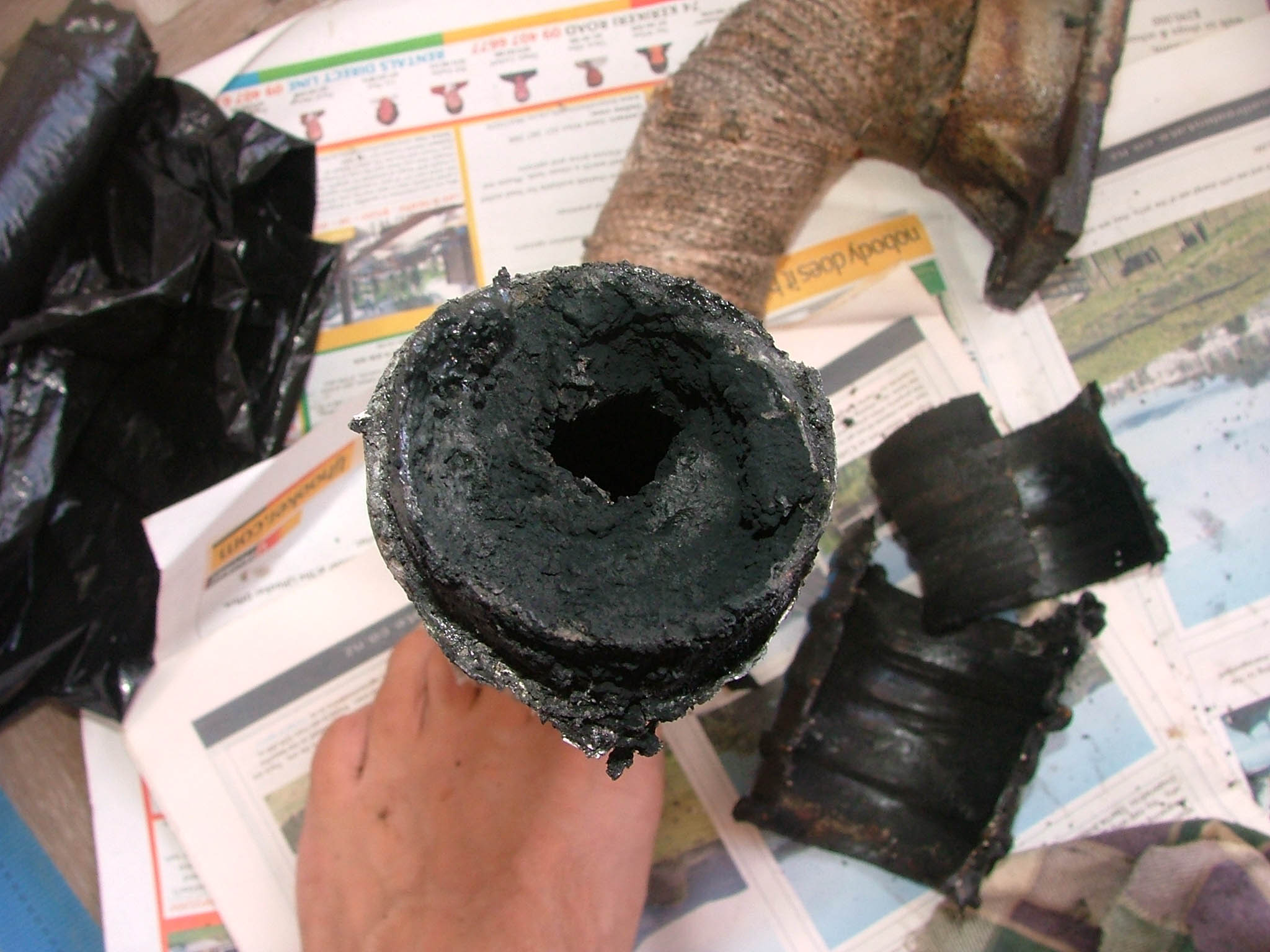

Dunno, but THIS :eek: was in my exhaust just above where the raw water is injected!
I'd inspected it 2 years earlier, but you can't see the middle of the pipe from either end...

Rob,
I've never seen anything like that! What causes that much buildup? Anybody?
Cheers!
__________________
Steve Ramsey - Puget Sound
S/V Manonash - '96 C36 mkII (#1586) - M35B
Steve,
I'm not sure, but let me throw out a few possible ideas for the carbon buildup:
Age
Engine Overloading (over-propped)
Excessive Idling
Worn Injectors
Running engine temp at less than 165-180
Poor Quality Fuel
I'm sure some diesel mechanic types can come up with others.
I'd agree with that list.
I'd expect to see the engine running a bit hot under load with that much exhaust blockage. Movement of air through the engine plays a significant role in engine cooling.

Funny thing - the engine seemed to run fine, but did get hot if run at full throttle. I had a new pipe made in Fiji (long story) but the overheating got slowly worse over 6 months and it would not run wide open. Even ran hot at 2200 RPM for 20 minutes as leaving New Caledonia so we babied it back to New Zealand. (Truth is - we had 15 to 20 Kts true wind speed, close hauled and pinching for seven days, port tack for 900 miles. Only ran the engine for an hour and a half)
The blockage was a short length of pipe, about 3 cm JUST before the water injection. The black crud was too hard to chip away with a flat screwdriver and hammer.

The same thing happened to me. The hole for the exhaust closed down to about 3/8" diameter. I could not get over 2200 RPM under load.
The iron pipe between the exhaust manifold and the cooling elbow was completely corroded through right where the build up occurred. I think probably the relatively cold temperature of the mixing elbow caused the exhaust to condense on the wall of the pipe at that point. The condensation would be highly corrosive, with the sulfur and other stuff that is in diesel exhaust.
Complete failure occurred on a cruise. I was able to limp into a marina that had a hardware store that had a supply of iron pipe fittings, and I pieced together a replacement exhaust system out of 1-1/4 pipe fittings. Sure did fix the power problem.
After returning to home port, I ordered the same fittings in 316SS from an online merchant, and replaced the iron.

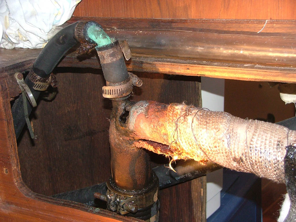

Rob Kyles's picture
Rob Kyles
Joined: 6/15/08
Posts: 172
Unwelcome sight as we approached Fiji in a flat calm, Koro Sea :(
