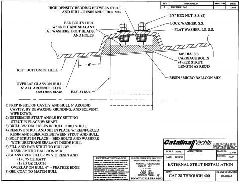

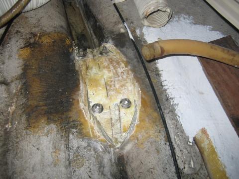

Paul
I too have water pooling in the same area behind the prop shaft strut on our 1983 C36.
When we pulled the boat out of the water for the season a few weeks ago we noticed a considerable stream of water trickling out of the strut. I wiggled the strut a little and I could see even more seepage from around it.
Our boat has always collected water in that area, which overflows and drains down the hull under the engine and into the bilge.
I am thinking about completely removing the strut and re bedding it in the hope of solving this issue at last.
I'm wondering if anyone has gone that route before and to what end.
Bob Serotini
1983 C36 Hull #81
Milwaukee, Wi.
I had a 1984 Catalina 30, keep in mind this was before many of the manufacturers began to upgrade their processes because of blistering etc. On my 84 bondo was used to fair the area of the strut. We noticed that this area was moist. Same with the fairing for the keel. The bondo was absorbing and holding onto the water.
On another note because of the age of your boat you may wish to replace your strut altogether. What may look perfectly OK may not be. On my 36 younger than yours the strut bronze was brittle and starting to crumble, don't know why, but it was. I replaced with a fabricated SS strut which allowed me to use the largest cutlass bearing for a 1" shaft. It also gave me more body to drill and tap for my Spurs cutter. The fabrication done locally was less than purchasing the bronze replacement, which was a long delivery.
I discovered (upon removing the center tank to replace the prop strut) that that aft cavity on our boat had been filled with expanded foam.  That would eliminate the problem; as far as I can tell that cavity serves no function at all.
