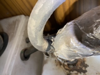

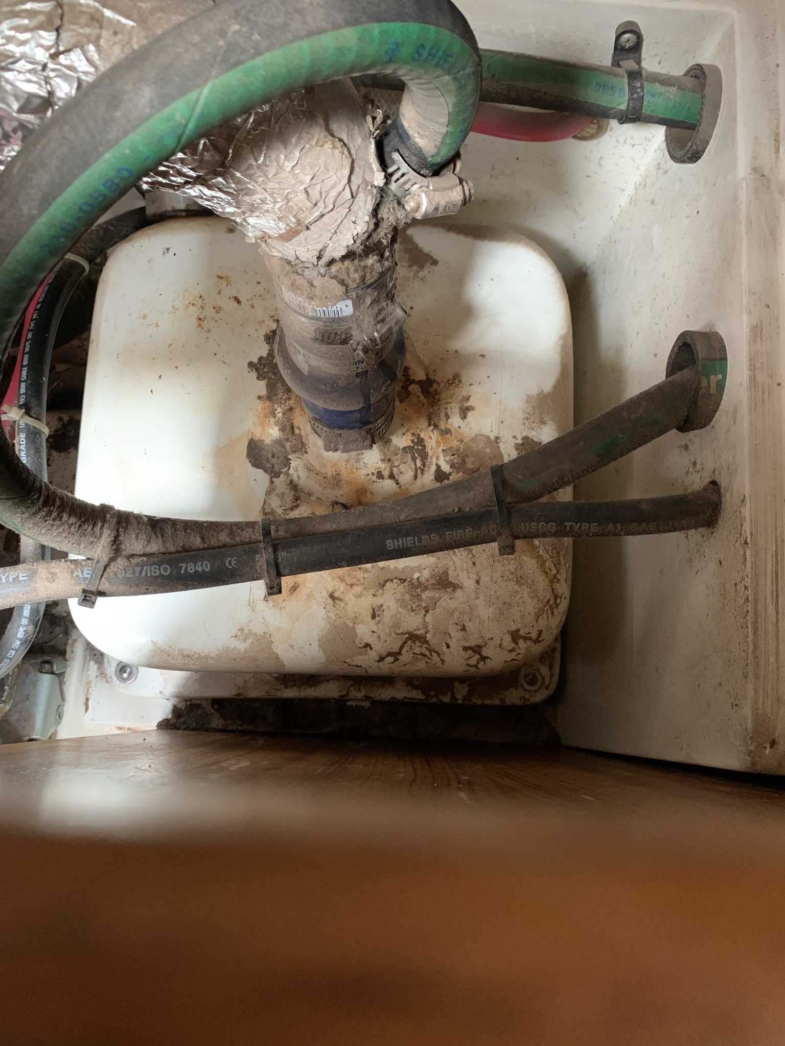

Motored back to the slip and found water on the floor of the galley dribbling into the salon. Not going to sink us but also not ok.
pulled things apart and found a steady trickle of sea water (tasted it) coming from the forward right corner of the base of the AquaLift.
read the manual and this site for insight.  Then I checked the siphon valve and found the my butterfly valve is also as crusted up as most of everyone else's.
pulled some more things open.

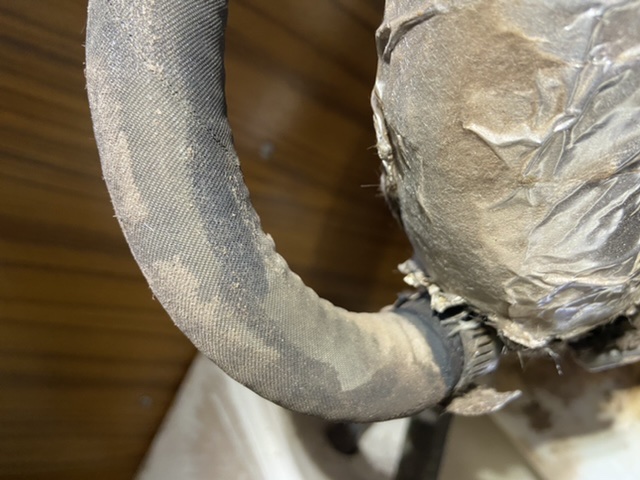

found that the hose clamp on the raw water cooling hose to the top of the muffler had broken.
quick new clam installed and No More Water.
