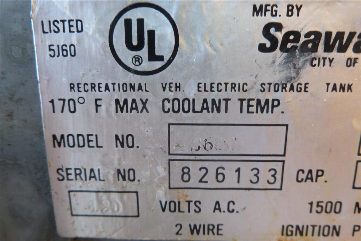

I removed my hot water heater today. Tons of fun.
Anyway, it says right on the label, this.
I'll still run my 180 F thermostat. Just hotter water. :o
