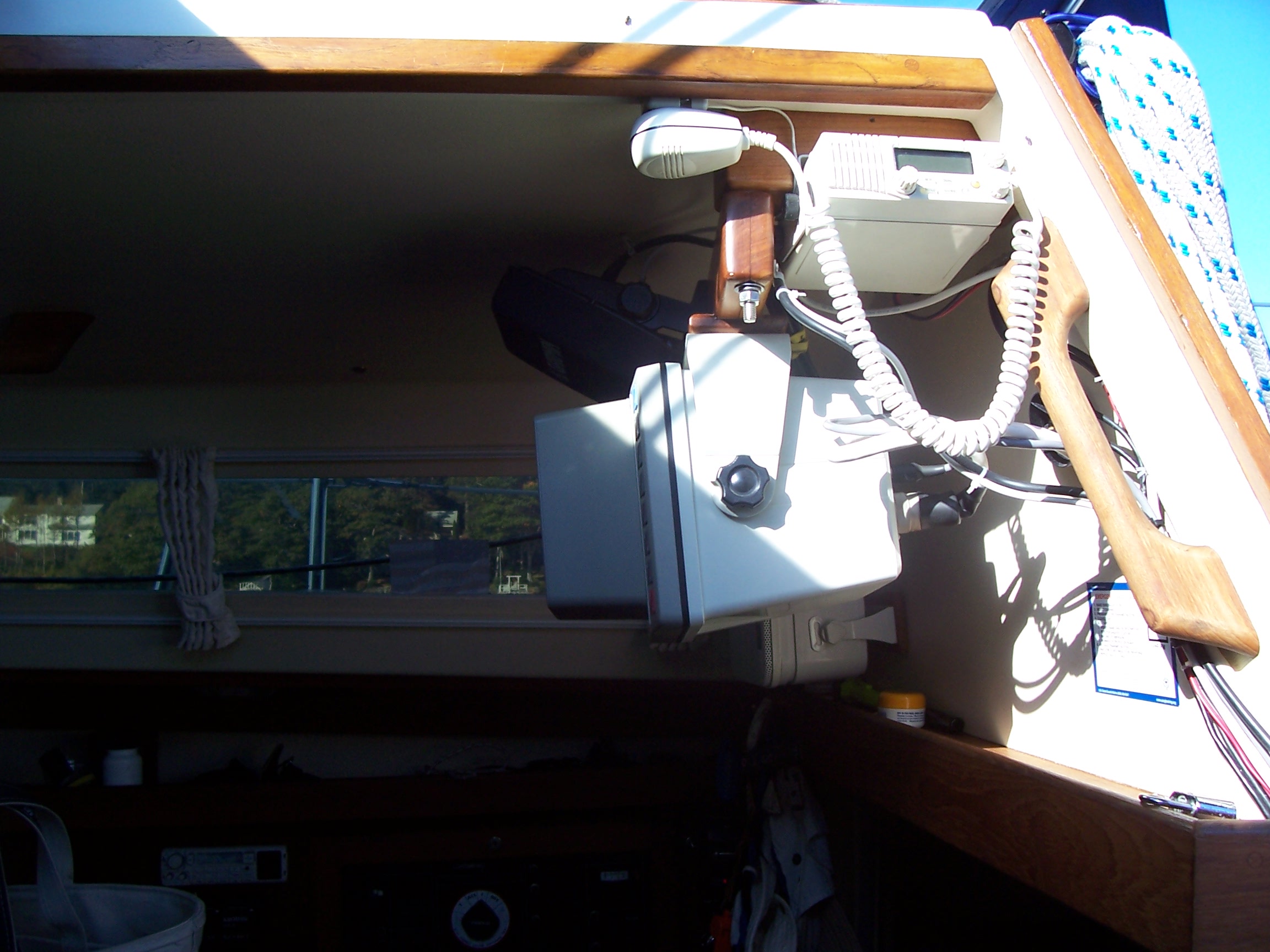

This looks like what your looking for? I have mine on the starboard aft coming and it has been than 12 years. Under the bimini and adjacent to the helm. Ran wires from radio under shelf (curtain for aft cabin) to starboard along existing wire race to back lazerette and coming.
http://www.landfallnavigation.com/icomhm157.html
Note to explain why I went under shelf from compainway to starboard shelf is I keep my radio accessible from cockpit. as shown here in earlier photo. I've since upgraded radio and added remote mic.
Image icon 20101220_2.JPG493.16 KB
