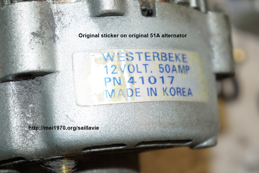

if the current alternator is the original one  it's part number is printed on a sticker. You will have to remove the alternator to see it.

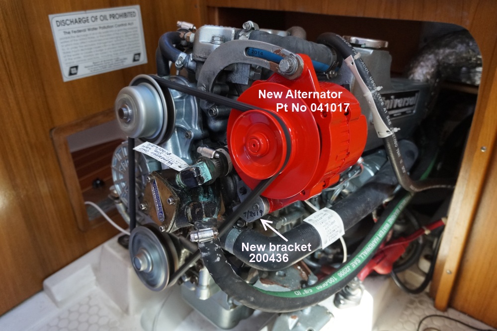

On page 58 and of the Manual the the part number for the original 51A alternator is listed as 041017.

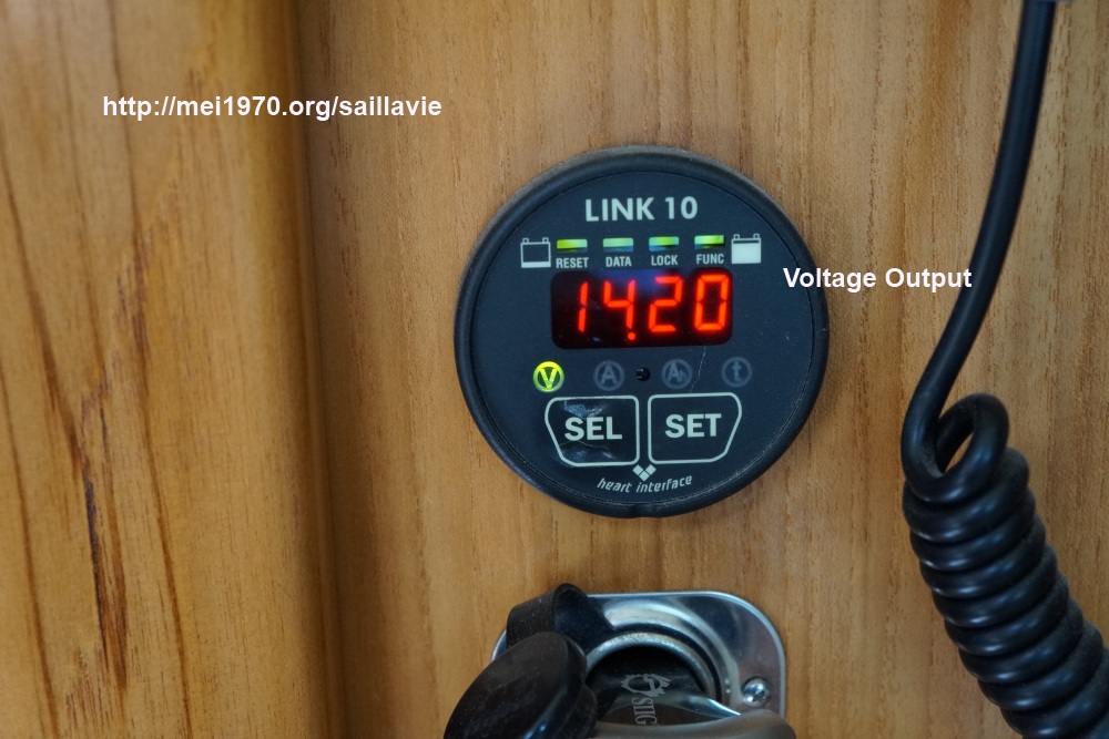

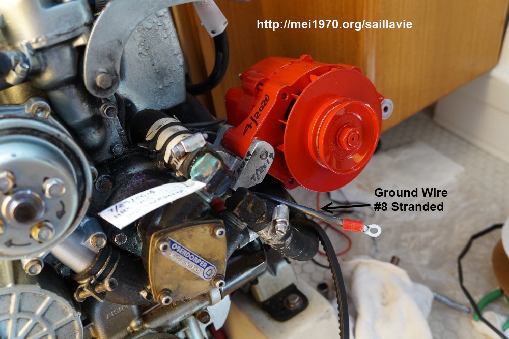

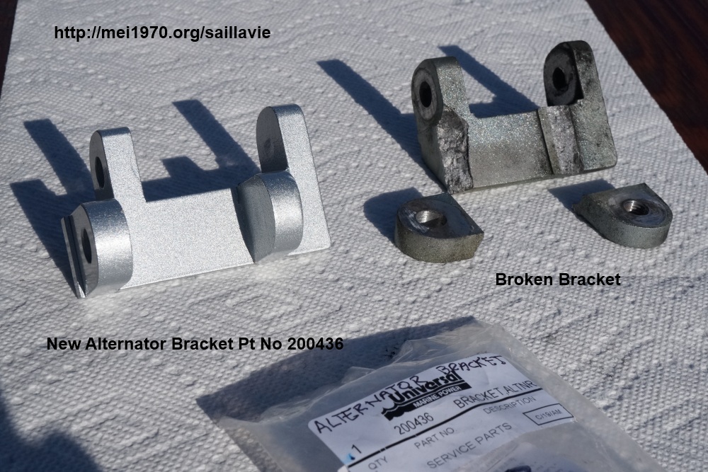

I had to replace mine as it failed due to replacement of the its broken bracket ( Part No. 200436) as it needed a better grounding. I installed a # 8 ground cable to the shunt near the house battery. The new alternator is painted red instead of the original silver paint.
