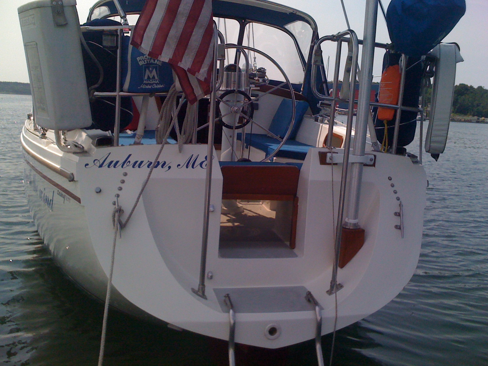

Posts: 591
Here is a picture of the "Doggie Catcher, it would seem to me you could purchase a piece of Plexiglas for a lot less than $85 plus the cost of a board and screws for the top you already have the sides.
