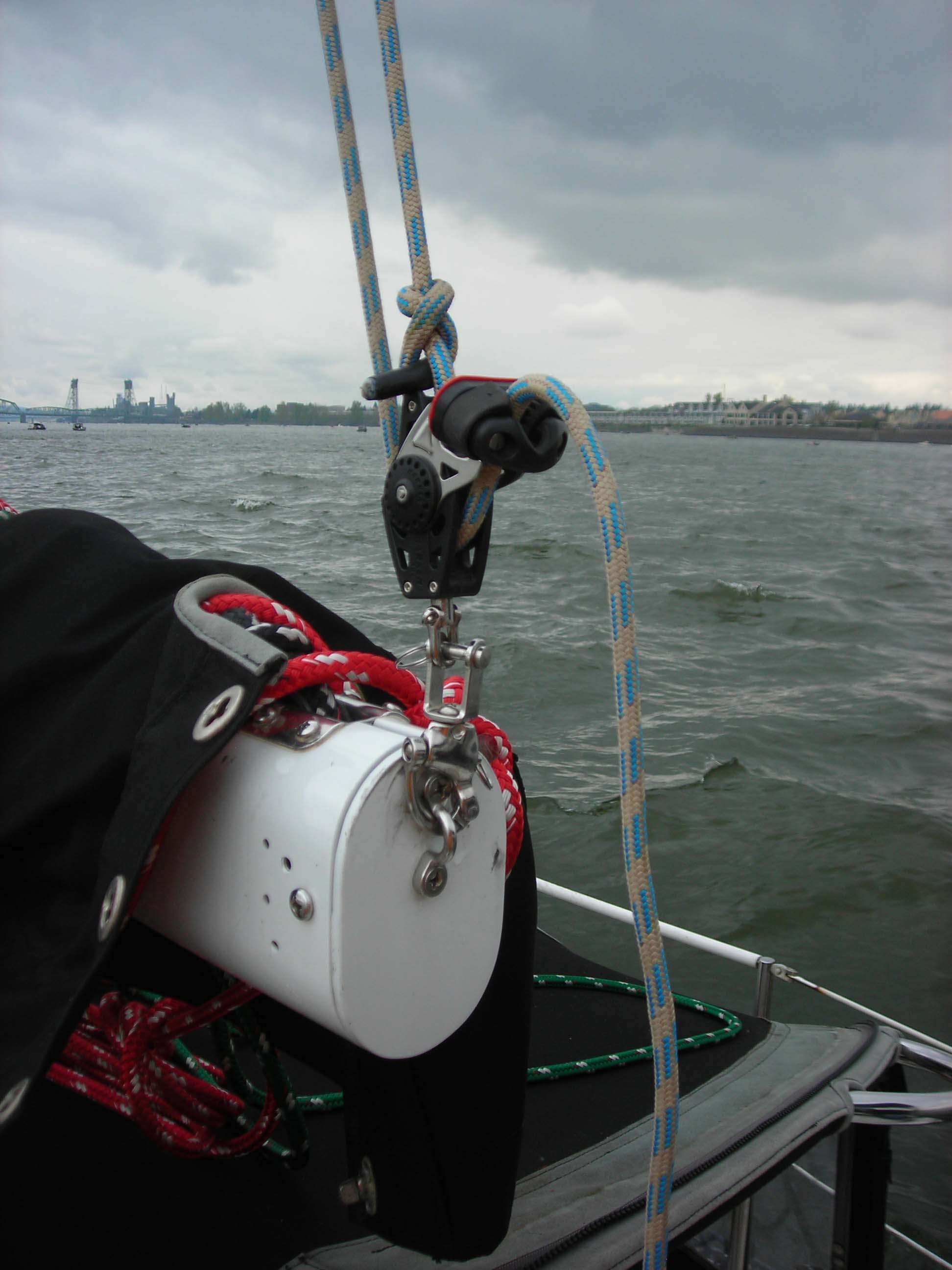

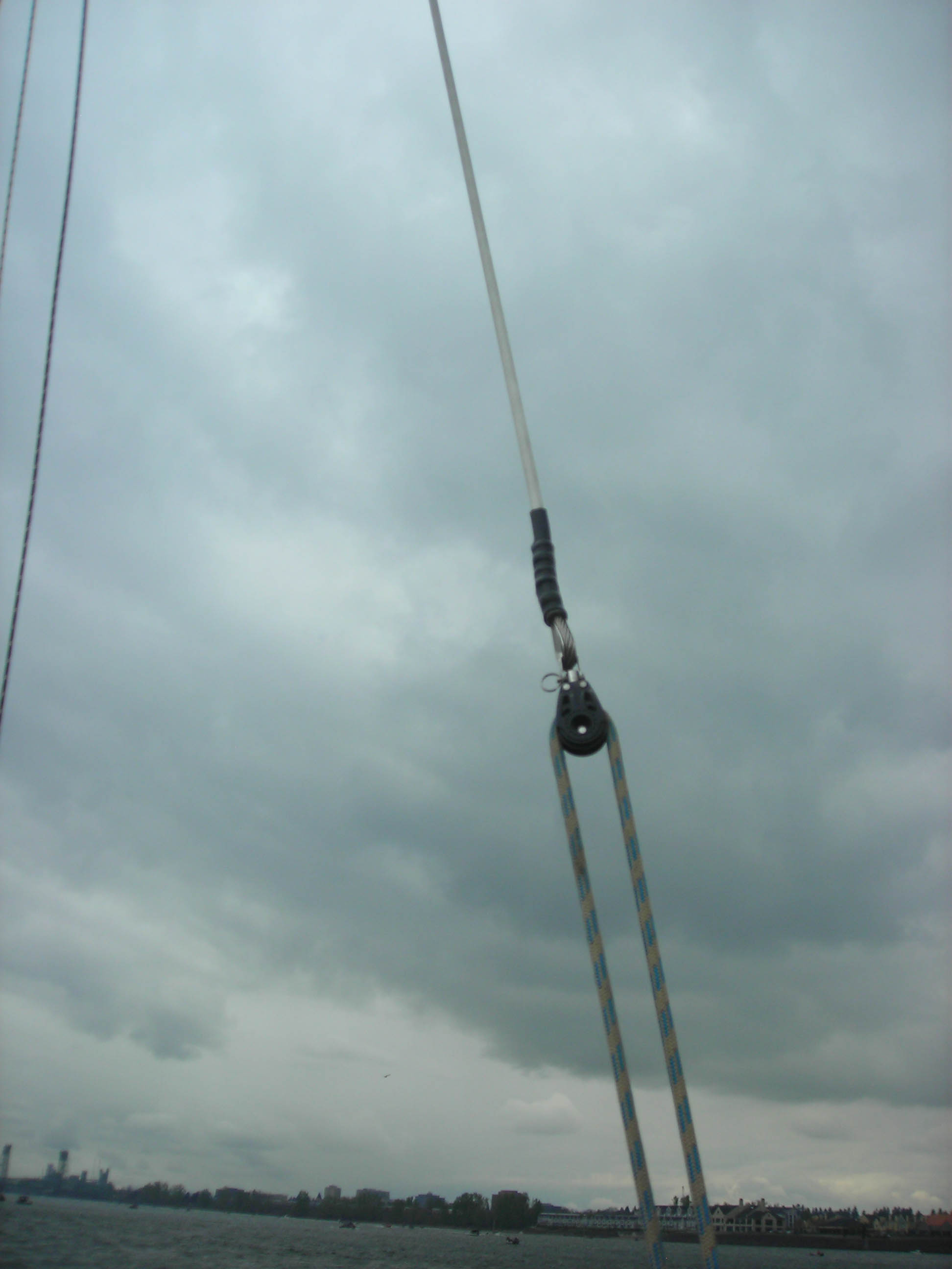

A friend on a C38 made a great mod to his topping lift to make for much easier control of the Dutchman guide lines. See photos of his installation below.
A rigid vang makes the topping lift is redundant, so its only job is to tauten and slacken the Dutchman lines. He added a simple - and cheap - block and tackle rig at the boom end of the topping lift, so that he could slack and tauten the lines at will. I copied his design on High Flight and I love the mod. Now I just tie off the topping lift "permanently" at the mast, and adjust only the boom end when I need it. It's a snap!

I'm away from the boat, but if memory serves it was 1/4". But because the boat has a rigid vang the topping lift is used only for the Dutchman. The greatest load would be if I forgot to slack the Dutchman under sail, then the billowed sail could place tremendous pressure on the Dutchman guide lines, and thus on the topping lift.
