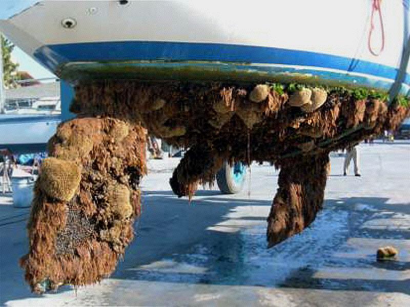

 Matt said it perfectly. I my case the bottom paint was peeling off in quite a few places. Just breaking off in 4X6 inch chunks. It was obvious that there was more than three coats on the bottom. While it's true that no boat ever sank due to blisters or peeling bottom paint you can delay stripping the bottom so long as paint stays on. So long as your bottom does not look like the one below, you'll be ok. If you think can can spot sand and paint then that would save you a few bucks this season. But the idea of heading to Mexico where the labor rate is a little less expensive might be a good one. Just find out how they are going to strip off the current paint and designate what paint you want applied as a final coat. Ask around the yard to fellow sailors as to what works or worked for them cause everyone has been where you are now. LOL

^^^Woah!  Ya nothing like that, not even close, hahahaha.  That guy should have harvested those sponges for a little side $$$.  On second inspection of the photos from the haul out in Feb. when I had the survey done, it doesn't look all that bad so I think I may be in luck after all.  Probably much simpler than my mind is creating it.  Thanks again.
