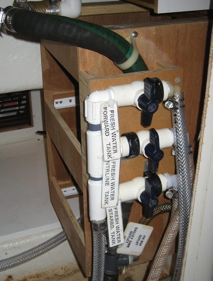

I made the same pump change that Bruce Landsberg did with the Surflo 2.8 GPM Pump. [URL="http://www.c36ia.com/node/422"]http://www.c36ia.com/node/422[/URL]
I liked the idea of the valves in the self under the stove. I have an AC hose running through that area and if I can move it at some point I would prefer to put a draw in that spot. Someone had done that in an old Mainsheet article.

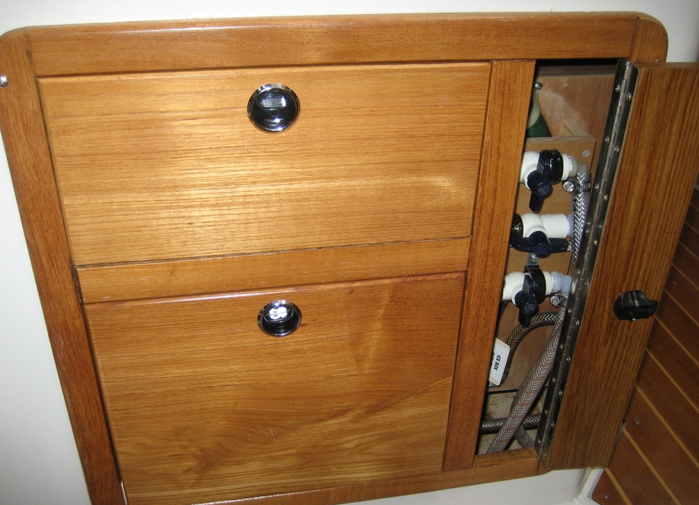

The vertical door under the sink is useless and I hate wasted space, when it is at a premium on a 36 foot sailboat. I reused the existing valves. Changing to the bronze valve would have been an improvement over the PVC valves, but the length of the handles might be a problem within the narrow area of the vertical door. Probably doable, but I cheaped out and reused the existing manifold. I was concerned about moving the valves to a higher position than the original placement, allowing the water to drain back into the tanks, but so far that has not been a problem. I had planned to add check valves if that turned out to be a problem. I have a check valve on one tank and have not noticed a difference.
I did have one problem with one of the T-fittings that cracked, out of sight, allowing air to get sucked into the system when the pump was running, but it was not large enough to leak water. Be careful to not over tighten PVC fittings
The valves are mounted on a U-shaped platform I added over the existing drain hose.

Nice job, I just made a new manifold for my water tanks and wanted to place my system there to be able to reach the valves without pulling cusions. Unfortunately that is where I put the regulator and combiner for my charging system. Looking at your pic's though it appears there is more room in the MkII than the MkI. I used 1/2" PVC valves and the assembly kept as short as possible and even with 90 deg. elbows like yours would not fit. It appears you made a platform as well?
