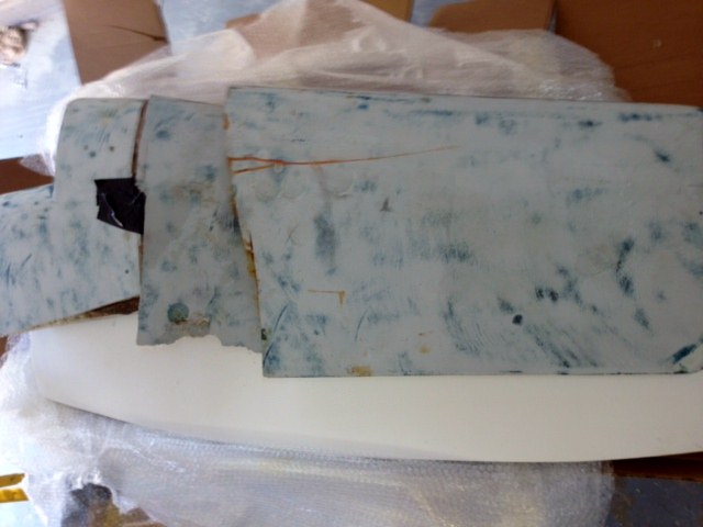

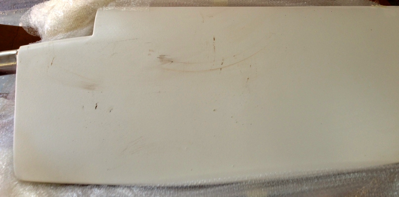

hi all,
attached is three photo's of the rudder that was shipped from foss foam. can any one suggest what the difference is size between my new rudder and the old rudder will translate to? could really use some input here although i guess what ever it means i kinda stuck with it.. BTW the second pic is my old rudder laid on top of the new to show the difference in size.

Mike perhaps this will explain the difference. My best guess is Foss is making the most recent design which in most cases be OK for use. It appears the rudder post should all be same size according to this pdf. lools like length of exposed post may vary.

Gary,
that helps a lot, i believe that Foss used the shoal draft design but extended it by about 5 inches, all i really know is that the rudder (new) has a much more elliptical shape and is much wider(?) than what i had on the boat previously. I am most interested to see what difference the design change will make in boat handling..

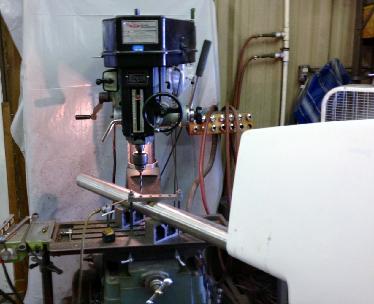

Ciscocat's picture
Ciscocat
Posts: 244
so i took my new rudder up to Cedar Mills Marina (ex home of valiant yachts). and the machinist that use to to fabricate all of the SS radar arches for 20 years used the attached drill press to drill 3 holes in the rudder stock. looked to be dead on to the old rudder. very cool to watch/help with the process!!
Mike Hogan
s/v Ciscocat #226
Mark I XP25, std rig
That my friend is not a drill press but a milling machine. Appears to be a knockoff of a very popular machine referred to as a Bridgeport. I have one in my garage and I have to admit I use it more as a drill press these days. In my early years I made a lot of Die and Mold parts on a Bridgeport when I was an apprentice Tool and Die maker.
Bit of trivia this machine can actually reproduce many of it's parts.
I'm sure it was much easier doing it this way and more than likely the hole alligns with itself from side to side.

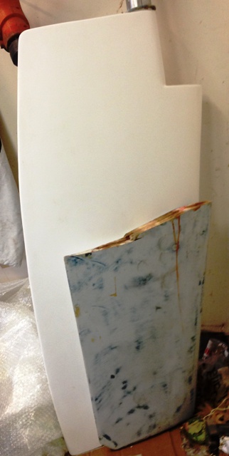

Hi all,
attached is the bottom part of the old rudder standing in front of the new rudder, very different. not a clue as to how things will work. putting it on tmw.
