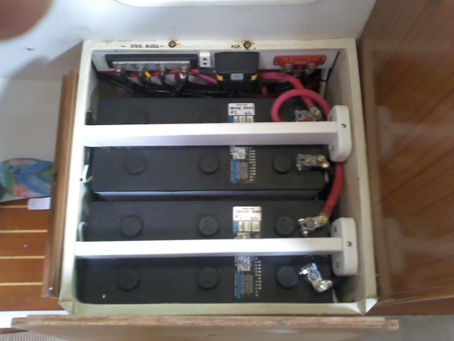

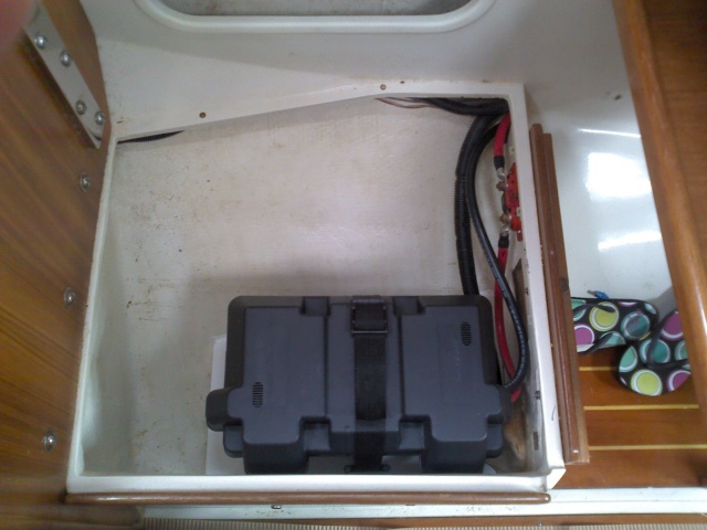

Here are the pictures of my setup.  As I said earlier, I don’t have a wiring diagram.  I did not do the install, the yard did it so I know little about the technical side of things.
On the house bank picture, you can see where the yard labeled the “Neg. Buss” bar and the “ACR”, the automatic charging relay.  From what I understand, the ACR is the heart of the system.  An internet search for “automatic charging relay” and/or Blue Sea Systems will turn up a number of wiring diagrams.

[quote=Solla Sollew] From what I understand, the ACR is the heart of the system.  An internet search for “automatic charging relay” and/or Blue Sea Systems will turn up a number of wiring diagrams.[/quote]
This was discussed not that long ago here, and these two threads have some diagrams and links to other threads/sites with diagrams:
https://www.catalina36.org/forum/technical-discussion/replacement-batter...
https://www.catalina36.org/forum/technical-discussion/starting-battery-i...
Hope this helps!
