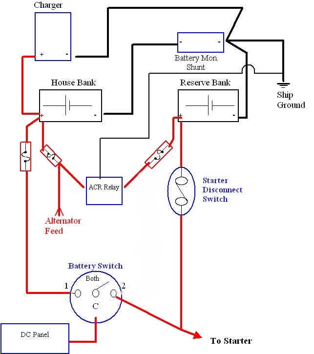

Greetings All...Looks like the day of reckoning has arrived. Our 2006 C36 is still operating on it's original 12 volt deep cycle batteries, dated August 2005. I've been keeping a very close eye on them for the past 3+ years of ownership, but this past weekend battery #1 wouldn't start the boat. Switched to #2 and it started, but not with the crispness it used to have. Battery water levels are fine, and the amp gauge says they are taking a charge at nearly 14 amps, but #1 is dead and #2 is right behind it.
This is no surprise, the batteries are nearly 9 years old. They had light use for the first 5 years, then pretty activate the past 3+. I've been researching options for a while. I've read posts talking about 6 volt batteries and wanted to know more, and if anyone has installed them in a late model C36 MkII.
- I understand 6 volts batteries are not the same size, so fitting can be an issue.
- I'd like to further install a starting battery, separate from the house bank.
- Adding a battery monitor would be helpful in keeping an eye on them.
- While I'm at it, get a battery charger with an inverter to run the outlets too.
I'm curious to know how the battery selector switch would work. Is it as easy as Battery 1 is starting battery and Battery 2 is the house bank? And if that's the case, then if I had 2 12 volt batteries, I'd have to split them another way?
What I like about the 6 volt option is the more amp hours as compared to the 12s. However, as they operate in series, them are doing the work all the time. But is that necessarily a bad thing?
Last question - I'm leaning towards AGMs. They seem to be a good value. Any thoughts there?
I'm hoping it doesn't come down to battery size. So any insight is very much appreciated. Thanks...Rob

Ah, I think I understand your question now: You want to have a dedicated start battery, and as well the ability to have [U]two[/U] house banks?
Certainly this can be done. But would seem to mean more complicated wiring (and monitoring -- for example, the Victron BMV 602 is designed to monitor 1 house bank and 1 starter bank). From what I've seen on this site and in the technotes, most C36 owners who've revamped their systems seem to have gone with just 1 house bank (consisting of any number of 12V -or pairs of series-wired 6V - deep cycle batteries) and 1 smaller (group 24) 12v starter battery.
For what its worth, we adopted the system described at the end of Mainesail's excellent article
[url]http://forums.catalina.sailboatowners.com/showthread.php?t=137615[/url]
("Alternate Methods & Switches"). The Alternator output goes directly to the house bank, and the start battery gets its charging via an Automatic Combining Relay (in our instance, a Blue Seas SI series p/n 7610). We've found this system works very well; basically, we never have to bother with the selector switch anymore (unless we have a rundown battery someplace); charging selection takes place on its own, and the starter battery gets to be regularly exercised for its stated purpose.

The simple trick is to take your current two house bank arrangement, and make those batteries into one larger house bank, add a separate reserve or start bank and continue to use your 1-2-B switch. Your boat, your choice as to whether or not you want to go to a two switch design or just the 1-2-B, as discussed by Matthew and in the links I provided.
Here's why a larger house bank is better, also discussed in the Ample Power Primer.
Largest House Bank 101 (by Nigel Calder)
[url]http://c34.org/bbs/index.php/topic,5807.msg45046.html#msg45046[/url]
The Ample Power Primer [url]http://www.amplepower.com/primer/primer.pdf[/url]
Also discussed in the Electrical 101 link I provided earlier.
Good luck. Once you decide what you want to do, it's pretty easy.

Thanks Matthew...I think you've got my objective. I read Mainesails postings last night and reviewed the diagrams. I even tried to copy them for reference later. I believe I understand them, but probably wouldn't want to do it myself unless I really had to, and I don't fortunately.
Stu...The link to Nigel Calder's article is excellent, thank you. I wonder by separating my batteries over the past 3 years has actually reduced their life, even though I got nearly 9 years. When I bought the boat around it's 5 1/2 year mark from the initial in-service date, the battery selector was on Both. I ran it that way for months until it was suggested I alternate use of each 12v battery by selecting 1 or 2 on the battery switch. One of the reasons to alternate use and isolate each battery is to have one as a "reserve". The other reason was sort of the same, if both batteries died, and you didn't have a reserve, you're in deep yogurt. So creating a reserve with only 2 batteries can also shorten their usable life.
But where I got confused was the posting by Scotty saying by using Both on the switch, you are basically creating a larger house bank, just what Nigel is suggesting. Of course, if you only have 2 batteries and you use them at the same time to make a larger house bank, you don't have a "reserve". Is that what you were eluding to when you said "Nope?"
Having only 2 batteries, my fear is and was if I use both with no reserve, and one of the batteries gets weaker than the other, which is my case now that I have them isolated, the weaker battery will drain off the other battery to equalize their load or reserve amps, if I have the terminology wrong I apologize. If you run two 12v batteries in parallel to double your bank, how do you know the "health" of each battery separately? Can you wire a battery monitor to report the status of multiple batteries in a house bank separately, and the entire house bank as one bank, and the reserve battery as well?
Also if I understand the postings, since your house bank may be 400 amp hours and your reserve bank or starting battery is only 100 amp hours, putting the battery switch on Both is probably not a good idea? Is this because the load draw from each bank may be the same amp hours, but it's pulling down the smaller reserve bank faster at a greater percentage of total amp hours available? And of course if you do this you don't have a reserve bank when the switch on Both.

Stu...I was just reading Ample Power Primer, great reference. It made me look for the manual for the battery charger for our boats. I found the ProMarine manual in the Tech Notes. If I read this right, it can charge 3 batteries.
If that's the case, since I'm not planning to go far in the next several years, maybe I just install a starter battery for engine starting and use as a reserve, and go with 2 more lead acids for a combined house bank and keep the same charger. That would be the least expensive for now.
If I ever decide to go cruising, I can review an electrical upgrade at that time to include solar panels or a wind vane or both I guess. How's that sound to you?

[QUOTE=rdmiani;22213]Thanks Matthew...
[/QUOTE]
As I understand it (caveat -- I have absolutely [I]no[/I] qualifications whatsoever in this area, just passing along what I've read, for what its worth), a monitor is not going to tell you the "health" of the batteries. It gives you lots of data, such as the voltage, state of charge, amps going out or in, amp-hours consumed. And this data can be helpful in assessing whether you are using the batteries in a healthy manner (e.g., not overly deep discharging, etc.) But determining the battery's present overall state of "health" is a more complex thing, involving things like load testing, etc. See, e.g., [url]www.pacificpowerbatteries.com/aboutbatts/deep%20cycle%20battery%20faq/dc...
Even if you are merely seeking to "report the status of multiple batteries in a house bank separately", the only way to do this is to disconnect them from each other, since -- as you correctly surmise -- they will otherwise be essentially one large battery (just the way an individual battery is a collection of cells, of which the monitor cannot give individualized data). On the other hand, if the batteries that make up the house bank are all of the same age and capacity, there shouldn't be much need to that. Other than the (apparently rare) chance of a bad cell, if the collection of batteries that make up the housebank were collectively purchased new and used (or misused) together as one bank, they presumably should be in the same state of health -- whatever that might be.
On the third (?) hand, if you have one house bank and one starter battery -- as we do -- a monitor such as the Victron 602 (as we installed) can give separate data on each (the data it supplies for the house bank deep cycle batteries is more detailed than that supplied for the start battery, but that's fine for our purposes; you can take a look at Victron manual to get an idea of the sort of information it provides: [url]www.victronenergy.com/upload/documents/Manual-BMV-600S-600HS-602S-EN-NL-... )
Also if I understand the postings, since your house bank may be 400 amp hours and your reserve bank or starting battery is only 100 amp hours, putting the battery switch on Both is probably not a good idea? [/QUOTE]
Its not so much because of the different AHs of the two banks, but rather because you want to make sure the reserve is in fact a reserve. Putting it on "both" utterly defeats the purpose -- if they're linked together they will be discharged down to same voltage, so that when your house bank hits 11.8V so will your starter battery. Then how do you crank your engine?
Unfortunately, you may have to use "Both" in order to charge both, the way the C36s come from the factory. The problem is that the tendency is to forget to move the switch away from "both" after charging is done (don't ask me how I know!) But if you use an ACR (battery combiner) then you no longer have to do so -- the ACR takes care of that for you even if the battery switch is left on the setting for the House bank only. And if you also wire the alternator output directly to the house bank (rather than through the battery switch), you've now eliminated the danger of frying the alternator's diodes if the battery switch is inadvertently move to "off" while the engine is running (and no, I haven't done that!), and completely converted it to a "use" switch rather than a "charge and use" switch.

Reading what every one has said about the danger of switching from 1 or 2 to both while the engine is running, I bought a new 1,2 both switch that will let you move from 1,2 to both with the engine running and not do damage . About 50$,

[QUOTE=William Miller;22226]Reading what every one has said about the danger of switching from 1 or 2 to both while the engine is running, I bought a new 1,2 both switch that will let you move from 1,2 to both with the engine running and not do damage . About 50$,[/QUOTE]
The error is not from switching between 1, 2 & BOTH it is that you may accidentally move it to OFF when doing so... All battery switches for at least the last 25+ years have been make before break...
-Maine Sail
https://www.marinehowto.com/
The "point" of the links I have provided is what Matthew mentioned: changing the function of the OEM 1-2-B switch from a "charging" "decider" and use switch to just a use switch by moving the alternator output from the C post of the switch to the house bank.
Understanding this basic concept is the key to understanding how your boat is wired and "how it works."
Once you make this change you can turn the switch to OFF and not fry alternator diodes.
