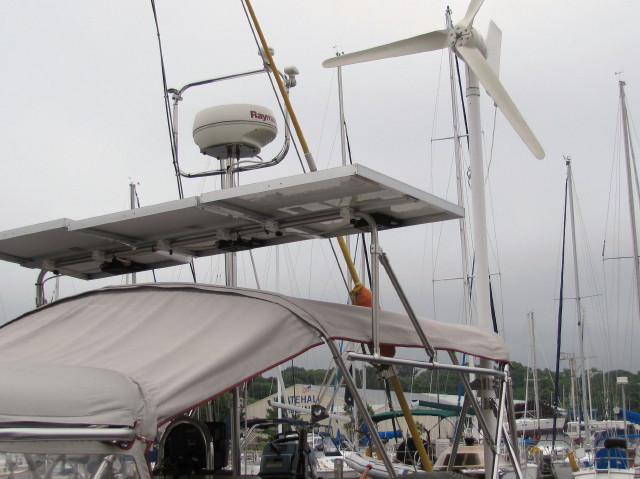

I have a set up that has 3 80 watt panels above our bimini and it is on 1 inch tubing. I had it built so I was able to take and tilt the panels some to gain more amps through out the day. I have not had any issues so far with this set up over the last 3 years that I have had it. One thing you may want to watch is how close you get it to your bimini as it may create mold if the sun can not get to it, as one couple in our marina had that happen with the set up i had but they had it so close to the fabric. What I will do is take some pictures and send you a few this weekend.
Randy

Glenn here is a picture of what I have mounted, I hope it helps.
Randy

Ah, it is nice to get a push now and then. lol. All in all, I have been in some high winds and they have been ok, They do not tilt to easy as that was a concern when I had the bar made.
Actually when I had it made I told the canvas guy that did the tube for me to have it 12 inches above the bimini so I could cut it down myself, I never thought about tilting them actually. So it was a mistake kind of but one that paid off as it does help a lot to get the extra amps.
Randy

Most helpful, I was in the process of figuring out what to do for my boat and the picture was useful. Also, I noticed your MOB pole against the split backstay, thats another item I will be adding in the next few weeks before I take off for a trip to Ensenada at the end of July.
