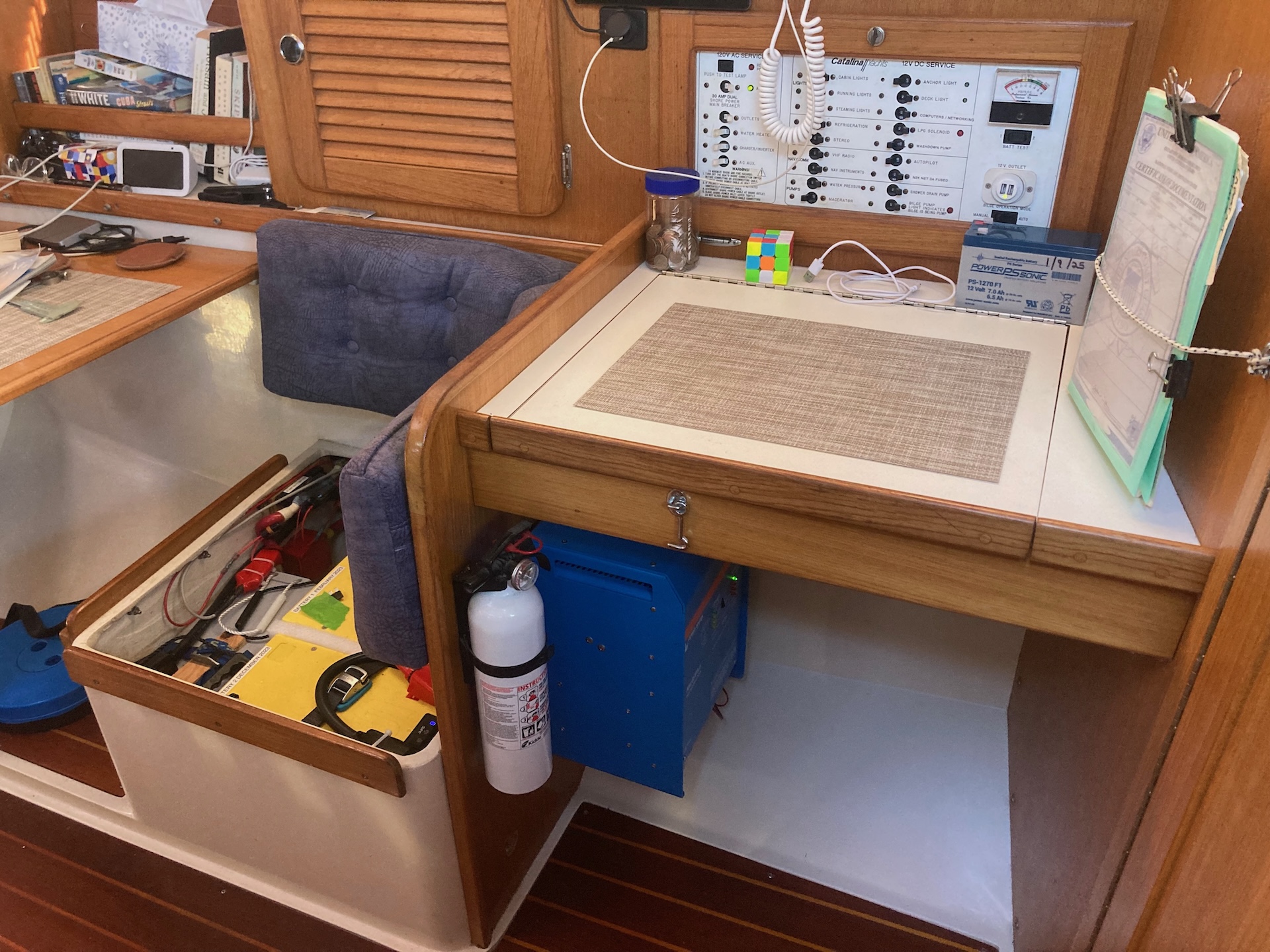

s/v Brazen Article is a MKII (2001, #1925) so the layout may be different. I mounted the Victron Multiplus under the nav station desk. That is close to the electric panel and battery compartment. Wiring was pretty easy once I drilled a few holes and routed cable. No problem with ventilation or excessive noise.
I have two 300 Amp LifePo4 batteries and an AGM start battery in the battery compartment on the other side of the wall.

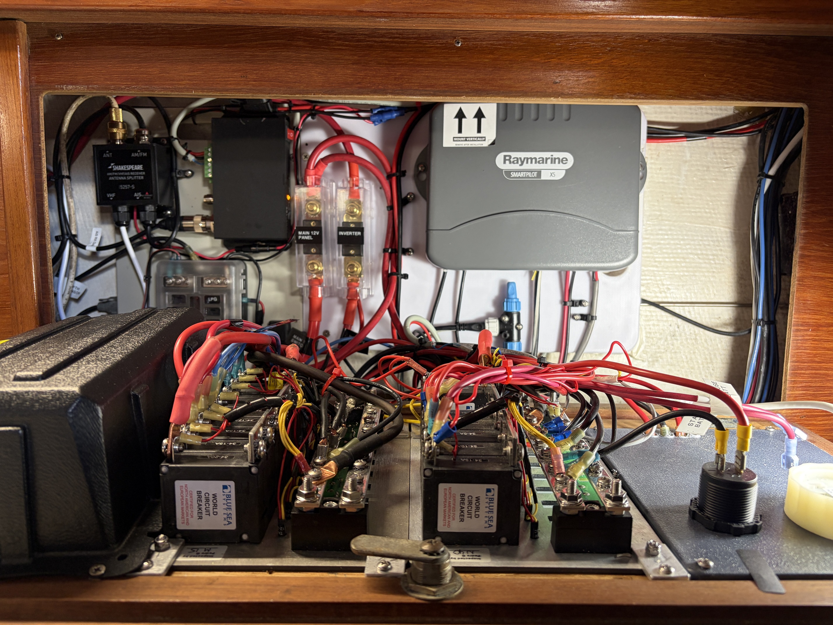

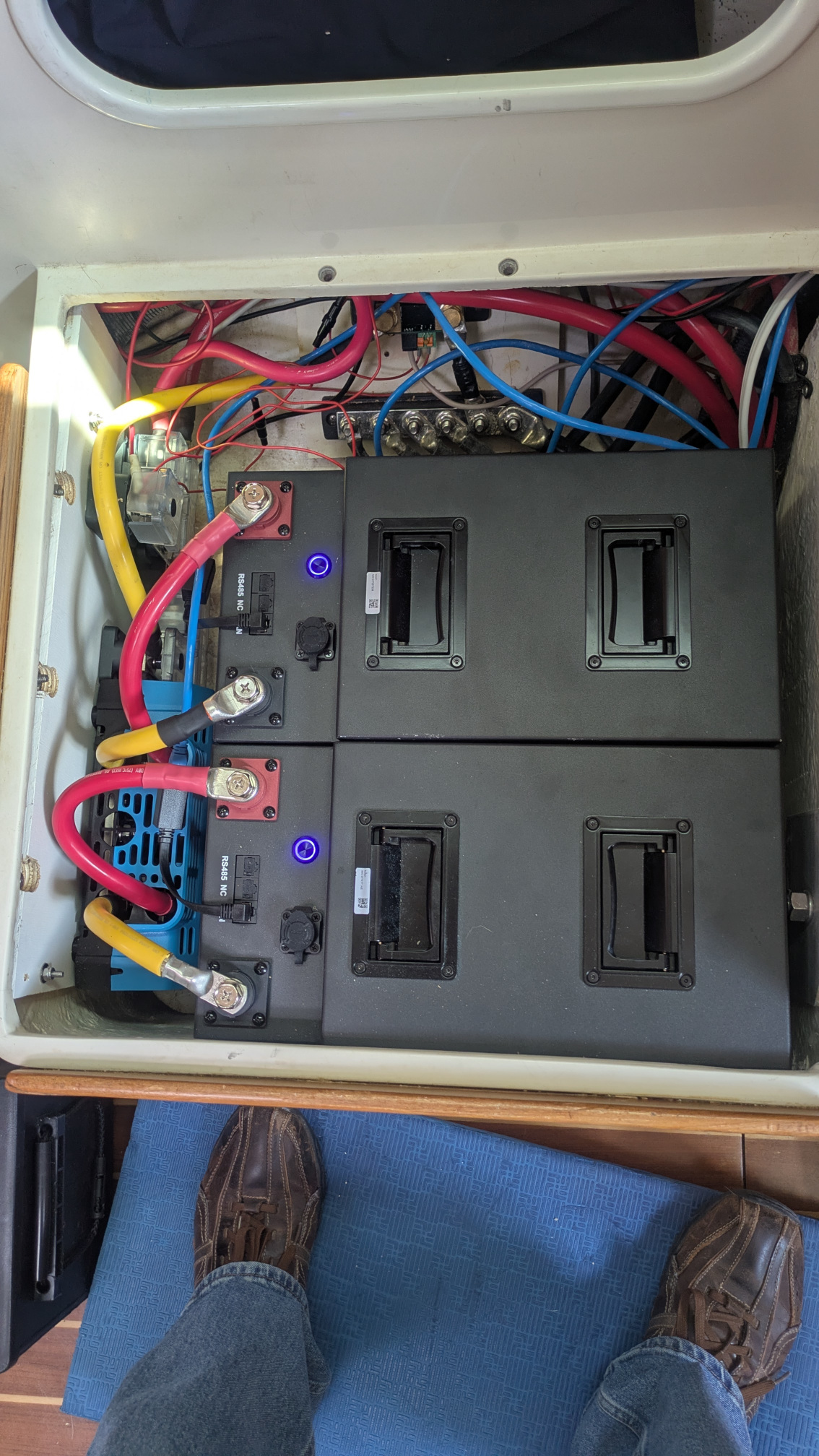

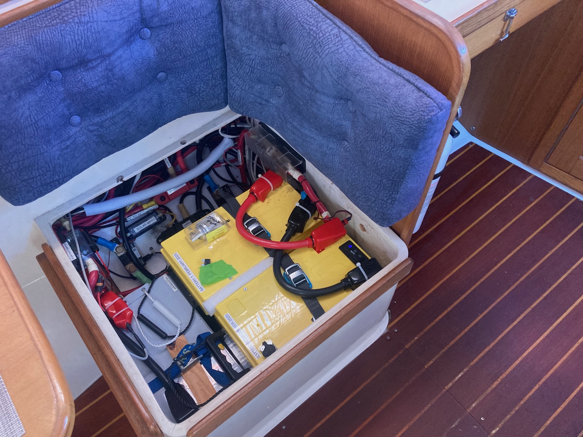

Like some others, I put two 300Ah LIFP batteries in, and I also redid the battery busses so that I could a) fuse everything, and b) provide adequate protection in case there was a short.  Each battery could deliver 300A sustained, so I wanted to make sure that I wasn't going to melt anything.  I ended up using the Lynx class-T battery In unit, as it could accommodate both of my batteries nicely.  I also placed a Lynx distributor in the same locker as the inverter/charger, where I could connect in the inverter/charger itself, DC-DC charger, solar MPPT, and one other item (which I haven't yet purchased).  Running the thicker (4/0) cable wasn't too hard, as there are adequate holes between the cavities, but the crimping was a bit of a pain.
I did also change out the battery selector for a simple on/off switch, because I wanted to ensure that the engine and house busses were separated.
As the battery locker is very easily accessed from the switch panel, I installed a Cerbo GX inside the switch panel so that I could monitor the whole system.
I have a picture of the battery locker, but not the charging locker at the moment (I seemed to have deleted that one).  But if anyone is interested in fresh pictures, let me know and I can go take some.

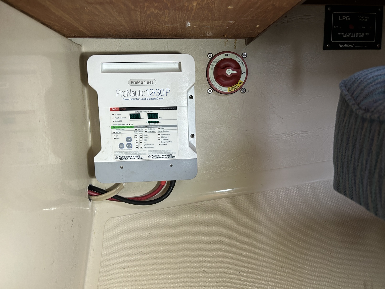

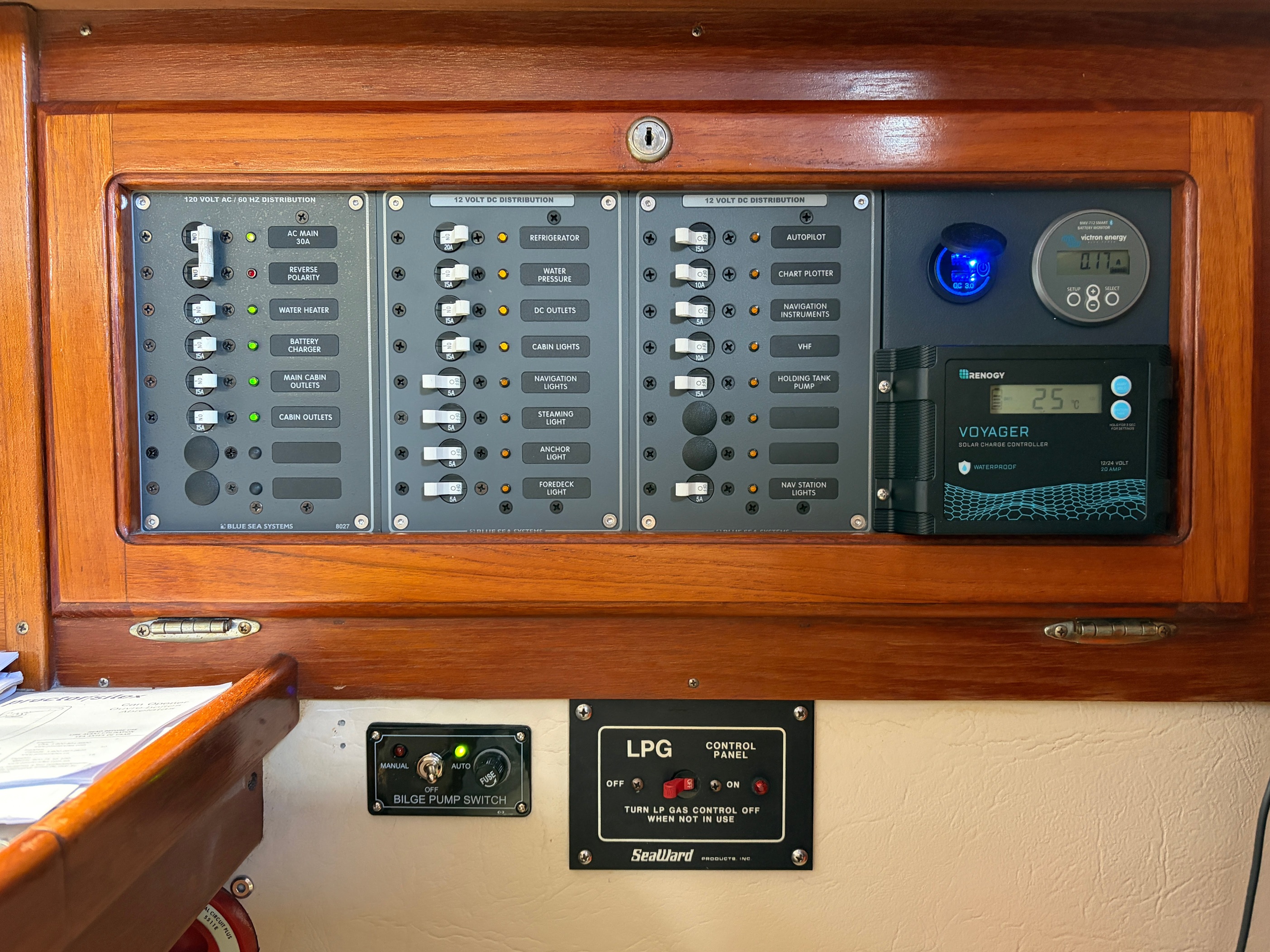

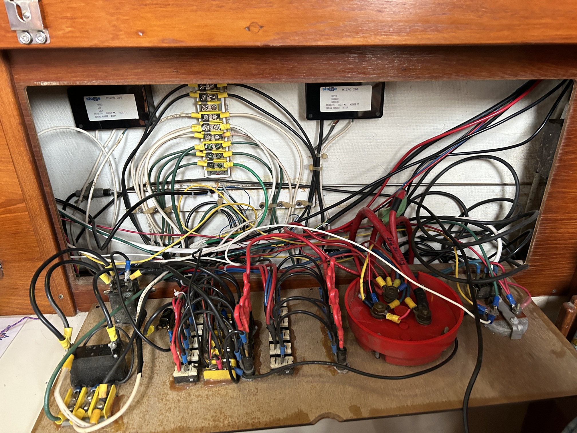

Mine is under the chart table on our 1987 C36 Mk1. It was close to the batteries and in the dry but also accessible so that I could read the LEDs etc. I relocated it from the cockpit locker. There is noise from the fan when it's charging but so far its not kept anyone awake to my knowledge.
FYI, I also upgraded the whole AC/DC panel system a couple of winters ago. It was a birds nest when I got the boat and I wanted to add other electronics to the system so decided to bite the bullet. I installed BlueSea systems components including AC and DC panels, ACR and Battery switch. I'm very pleased with the results.
Good luck with the project.

Your before picture looks very familiar to me.
