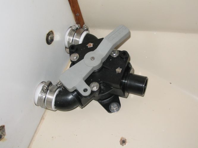

Hi Joan. I, too, suffered from "stinky locker syndrome" and I finally narrowed the cause to a barely noticeable leak in the diverter valve (Y valve) that directs the sewage either to the tank or overboard. I didn't like having that valve in such an inconvenient place under the locker, so when I changed it out, I moved it to the head where it is easily observed and accessible. It fits perfectly behind the toilet. The change in location also resulted in shortened hose runs which have to help as well. Here's a pic of my installation. I'd be glad to elaborate if anyone's interested in knowing more.
[ATTACH]108[/ATTACH] Click on pic to make it bigger
Mike:
Yes I would love more info on what you did. As going to saltwater next year I need to install a y valve, so if you can make it easier for me pleased do. You can mail me here I belive, if not let me know,
Randy
