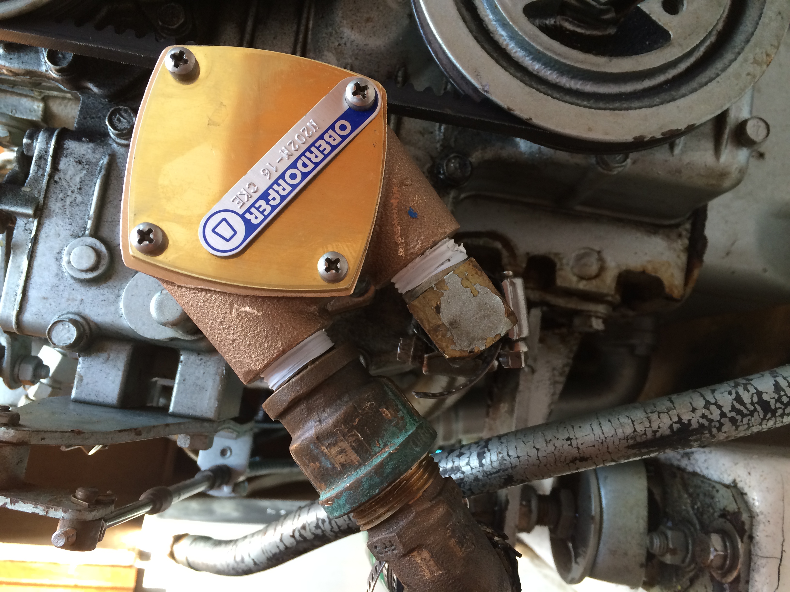

I have had an Oberdorfer N202M-16 on our M35B for over 4 years. The original article in the Mainsheet was based on my experience making this pump fit. I had around 800 hours (600 in saltwater) on the pump before I replaced it with a new one last year. My wife and I traveled from Vermont to the Bahamas down the ICW. I brought a spare pump and on the return trip I swapped in the new pump, because of some minor leakage on the seal. I may have been a little anal and premature on replacing it. The second pump had been modified using a 4 inch abrasive cutting wheel, easier and faster than the Sawzall.
I found a very good article from the Catalina 34 website by Ron Hill (http://www.c34.org/wiki/index.php?title=Raw_water_pump,_impellers_and_cooling_system) on replacing seals on these pumps. I bought the replacement seals and did the replacement. The cover plate did have wear, but the plate was actually slightly bowed out, so flipping it over and using the backside probably would not work well. I will have the cover ground flat before reusing.
I bought the seals from San Diego Marine Exchange, SKU = 40121, Description = OBE 5463 Lip Seal for $15.75 each. (http://www.downwindmarine.com/Oberdorfer-Model-202M-Rubber-Impeller-Pumps-Universal-Engines-p-91002307.html)
The engine always runs at 162 degrees F, once warmed up. I have never had to prime the pump.

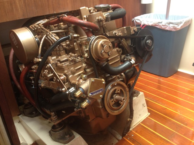

Well the O-pump project went like a dream.  Probably the easiest mod I've made.  To prime, I filled the hoses with water, then opened the vent plug on the top of the pump and added some water there as well.  Started right up, and no leaky-leaky.  I also found putting a thin film of Vaseline on the barbs made the hoses go on easier.
I'll keep the Sherwood pump in the spare parts bin for emergency use.

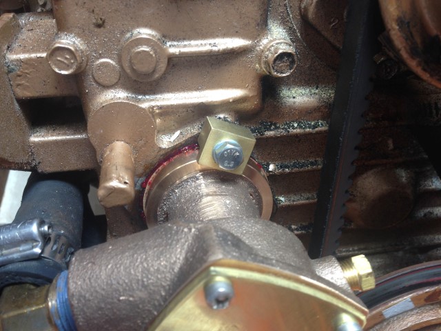

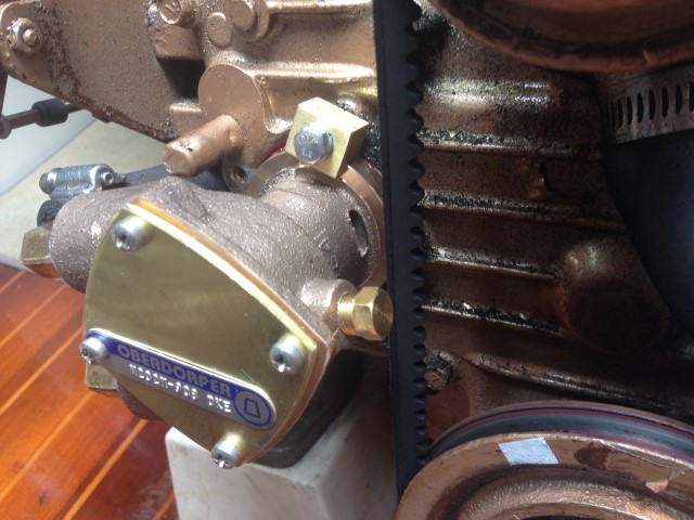

Today I installed the new Oberdorfer Pump Part Number  N202M-837 on my M-35 engine in a late 1990 C-36. In talking with my parts/pump distributor; DEPCO PUMPS in Tampa, FL. they steered me toward the forgoing Oberdorfer number and stated that is supposed to be a new kit designed to directly replace the Sherwood Pump, that is to say, without any grinding or further fitting.The kit came with new 90 degree elbows and all needed gaskets.
I am happy to report that was the case for me, as the pump was a direct replacement without any alteration or grinding of the pump housing. The new pump housing appears to have a modified collar making it more like the Sherwood.
Whether all of this will work (without grinding) on the M-35 A, B, BC engines is something we'll investigate - but it supposed to be a new item. A call to Oberdorfer in Syracuse, NY would certainly confirm whether it would work with your engine.
Only one word of caution; Be sure you understand which hose and pump fitting - is the input and which is the output of the pump before re-attaching. The job took less than one hour.
Bill Dolan

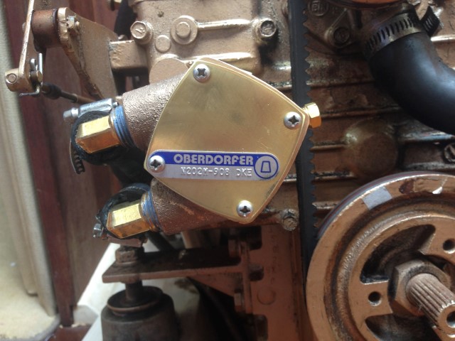

 Please be sure that the model of Oderdorfer pump you order is the correct one for your engine as there are several different styles of the pump base that are offered for the type 202 pump.. Some are square and would  require grinding (as outlined in the tech notes section).
The Oberdorfer pump that came with kit number N202M-837 was pump part number N202M-908 DKE and has a round pump base that easily fit to the M 35 engine without grinding (as shown in the picture in my post)
Again, whether it will directly fit your engine is a discussion you should have with Oberdorfer  (call Oberdorfer in Syracuse, NY 800-448-1668)
I believe the N202M-908 pump should fit all Universal/Kubota 35 engines without grinding, however, it would be best to check.

I replaced my Sherwood G908 pump with the Oberdorfer N202M-908 pump a few weeks ago because the Sherwood pump was leaking again.  I also had my heat exchanger boiled out and I installed all new hoses.  My Universal 35 BC engine has traditionally run at about 180 degrees at 2500 RPM.  Now the engine is running at about 200 degrees at 2500 RPM.  Does the Oberdorfer pump push less water than the Sherwood.  Is there a high capacity impeller I could install in the Orberdorfer pump.
Posts: 387
That might be the case as I noticed my engine which ran at a cool 160F (indicated) with the leaking Sherwood pump - is now running some 15 degrees warmer at 175F (measured) with the Oberdorfer N202M-908. (2500 RPM at 5.9 Kts SOG) Never thought much about it because since it's still with in the operational range. But now that you mention it..........

There are 2 sizes of inlets for Oberdorfer. For my M35B I userd N202M-16. This has 1/2" water inlet. There is also M15 version which is 3/8 water inlet. This difference may be the reason for higher water temperature. For my engine it runs at 162F at any RPM.
