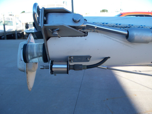

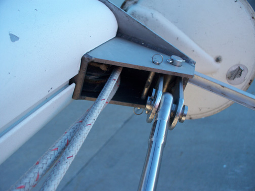

Domani: Changing out the sheave on top of the mast is not a job with the mast up, Well on a 1990 36 anyway. I have a picture that is a few months old that I can send you if you email me that I took of our mast when it was on our boat while we were in transit on the Erie Canal. It will show you what you see. The top of mast has a cap that has to come off to get the sheaves out as it set in a recess and on a pin. The stock sheave is nylon with a bronze bushing.
Take a look in your owners manual, it should have a good diagram of your mast head. It can be done with the mast in the boat, but I suggest using a cherry picker as I think both the fore and back stays need to be removed to get the mast cap off.

By the way here are a couple pictures of my mast head, It's easy for me to have pictures, I pull the mast every season.
