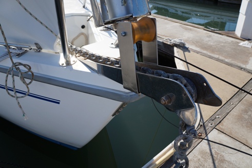

I have a Rocna 44lb (20 kg) on my bow. It rests just fine, but the problem is clearing the furler. I think want to experiment with a roller above the anchor, but I'm not sure how this will work. I videoed the anchor deployment and retrieval so that I could study the motion on my computer. Maybe I can figure something out. I'll tell you, 44 lbs plus over 100 feet of chain is one helluva load for a single hander to deploy, not to mention retrieve.
Posts: 450
I have a 44 lb anchor and here is how I solved that problem. I have also added 2 relays to control the windlass motor up and down with 2 switches at the helm.

 Haro, Brilliant!
I have been troubled retrieving my 33 lb Spade anchor, having it get caught on the bottom of the jib furler.
https://www.spadeanchorusa.com/product/spade-s-steele-s80
Your top roller idea is the solution!
Thanks, Steven Jones

Haro, thanks for that photo. Yes, that's along the lines of what I was considering. I'll try that out. And I am hoping to add remote windlass control as well.

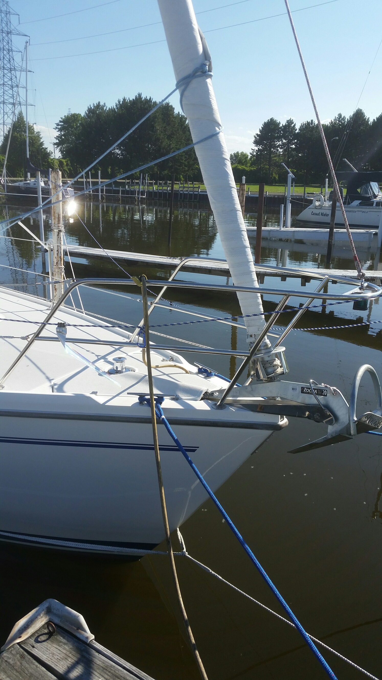

I put a Rocna 15 on my 1993.  It rests fine with no modifications.  It's a little difficult to get under my furler drum, but really no more difficult than the Danforth it replaced.  The anchor itself has set perfectly every time so far.

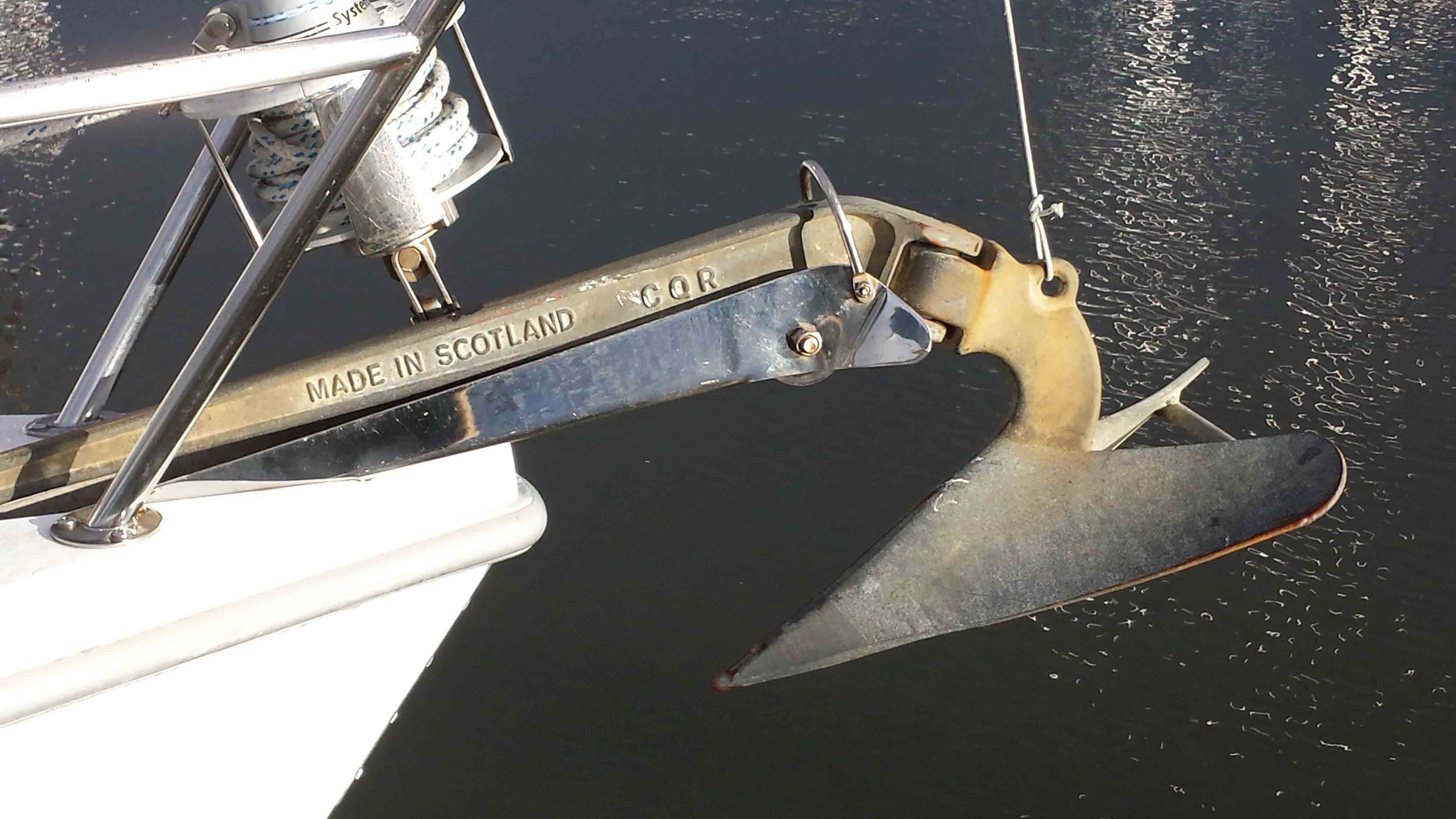

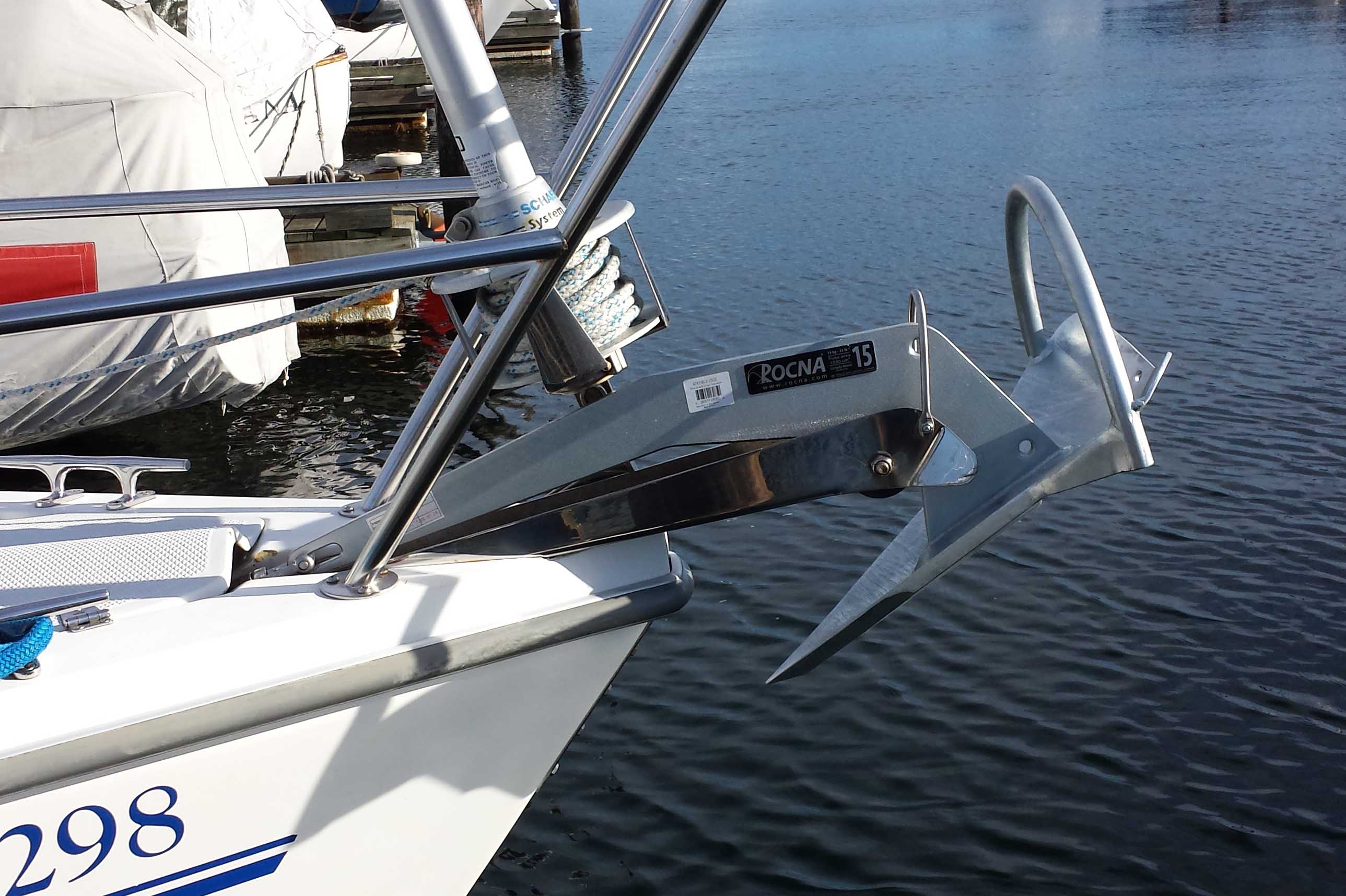

I installed a 15kg Rocna this spring.
I replaced the original bail with a larger one - then moved the original bail to just under the furling drum (where it lines up with the point where the Rocna just begins to narrow...   this keeps the anchor shank from banging into the furler (which the CQR always did...).
I am posting the original CQR along with the new Rocna (before installing the original bail under the furling drum...)

Howard,
One comment,  I thnk you should reverse the shacklshackle.  The curved part should be attached to eye in shank of the anchor, thus reducing the potential sideload  on the shackle pin.

Actually Lou, that is a swivel shackle - designed and built with a pin at each end...

Good to know, Larry.  BTW, I have this photo of how a 20 kg Rocna sits on the the bow roller of a C36 Mk II.  No problems with fouling the deck, but I do have the same issues Larry has with the shank hitting the bottom of the roller furler drum on recovery.  Also, it invariably comes up backwards which causes some maneuvering with the boat hook as it's hanging by 6 feet of chain from the front. I don't have a swivel due to fears of swivels breaking that I've read about - perhaps an excess of caution.  Anyhow, I'm very happy with the anchor, and am happy to hear that it performs so well under very difficult circumstances.

I use the windlass to bring it up to the bow roller where the anchor hangs vertically. From that point, if necessary, I twist the anchor chain to cause the chain to rotate (to 'jump' in 90 degree increments) until the shank is aligned properly. Then I lift the chain to 'wrangle' the shank past the furler.
I lead the chain straight back to the windlass. The chain fall from the windlass is wrapped around the cleat inside the locker. That's the stowed position. Finally, if going out in the ocean for a passage I use a short piece of line to make doubly sure the anchor doesn't go walkabout at sea.
Posts: 450
I use my trip line that is attached to the anchor to twist the anchor to the correct orientation then using the windlass I pull in the shank. The roller that I have installed prevents damage to the furler. See the image above.
