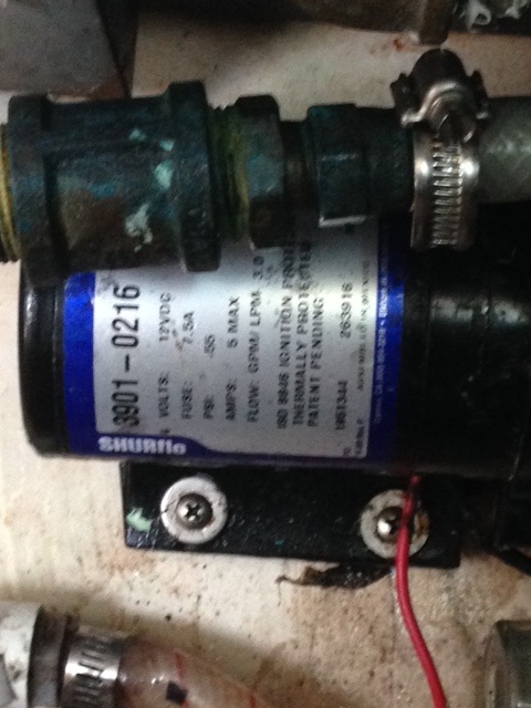

My C36 is a 2003 as well that I just purchased last year.  Not sure if it is original but my fresh water pump is a Shurflo 3901-0216.  Picture attached (I hope).
Jeff Wilson

Thanks Jeff,
Much appreciated!  Got the picture.  Sailed the last 2 day w/ company so no work time.  Calling W. Marine now and heading out to the boat.  Even if there's no kit available now, maybe I can clear out the screen, hopefully.  Have a great season on your new boat!
