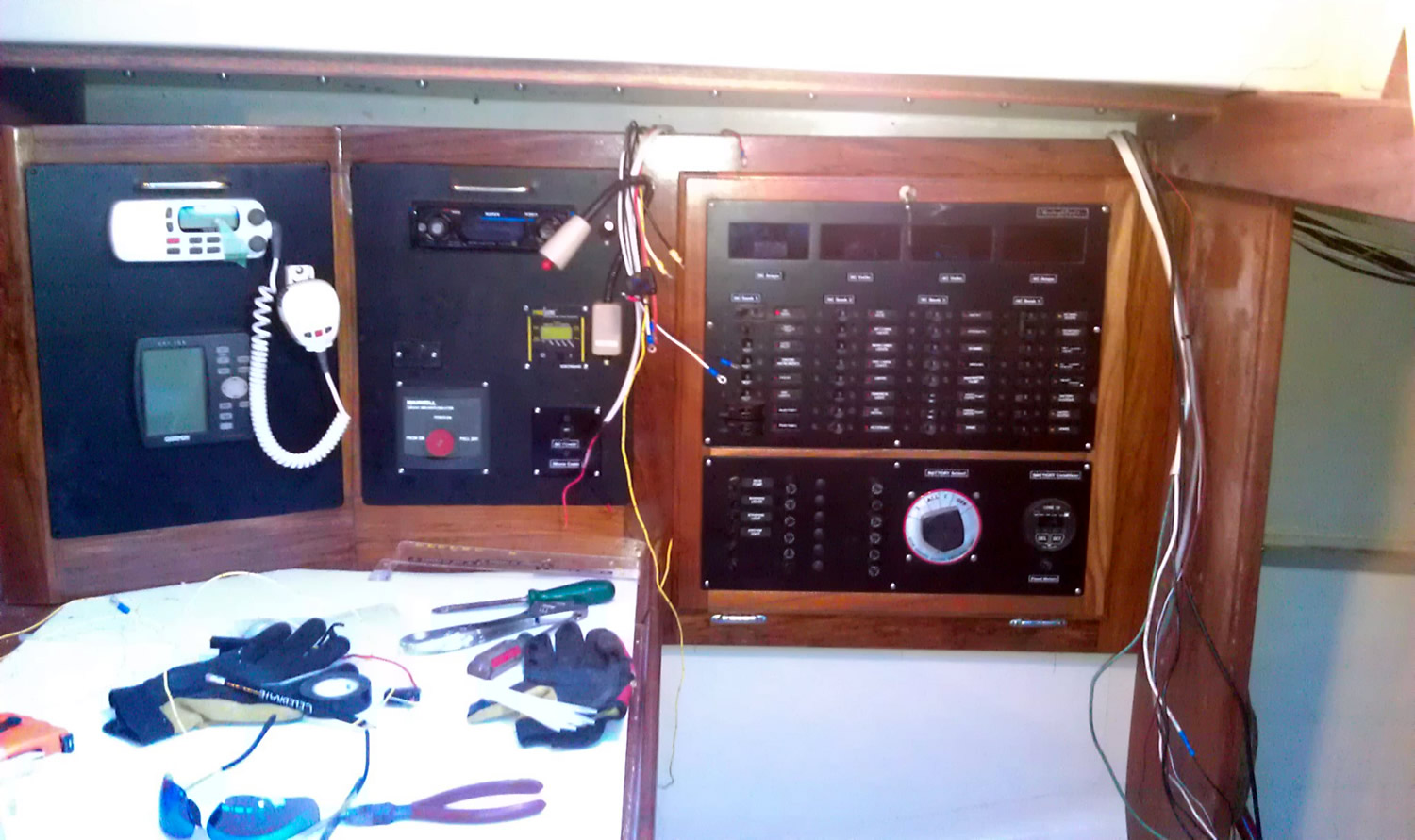

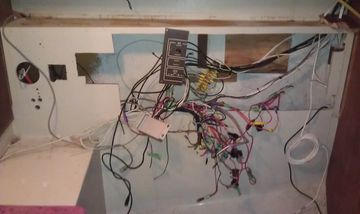

I started into it today. Initially I'm just pulling out and cleaning up 30 yrs of abandoned wires from old equipment & mods. I'm sure I'll end up going all the way like you guys did. Both of your new panels & neat wiring are inspiring!
ps...Ross, you're my new standard for when ever I feel I'm getting carried away (or discouraged) with this project. I can't believe you stripped the whole inside! Must be gorgeous now.
Here's my panel & rats nest:

Hi Paul & Ann:
Welcome to the forums, this is without a doubt the best source of information for the new C36 owner. Regarding your fuel tank, we had a similar situation with our original equipment fuel tank. Imagine getting a call from the boatyard in February saying that they noticed diesel dripping out of the depth sounder transducer through hull and had just pumped 15 gallons of fuel out of the bilge. Being on a relatively tight budget, we looked at our options and decided to glass the outside of the tank. I sanded the entire exterior of the tank, wiped it down with lacquer thinner and applied West System epoxy. We used 2 layers of glass cloth on the bottom, one on the sides and top, and an extra strip of glass around the bottom edges. No more leaks and after one season on the water there is no evidence of the glass separating from the aluminum.
I am looking forward to reading about your experience with the wiring system!
