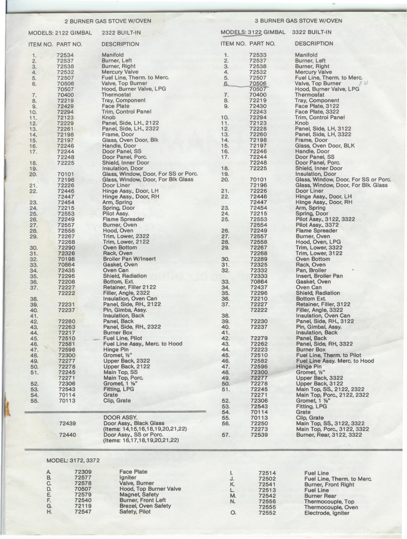

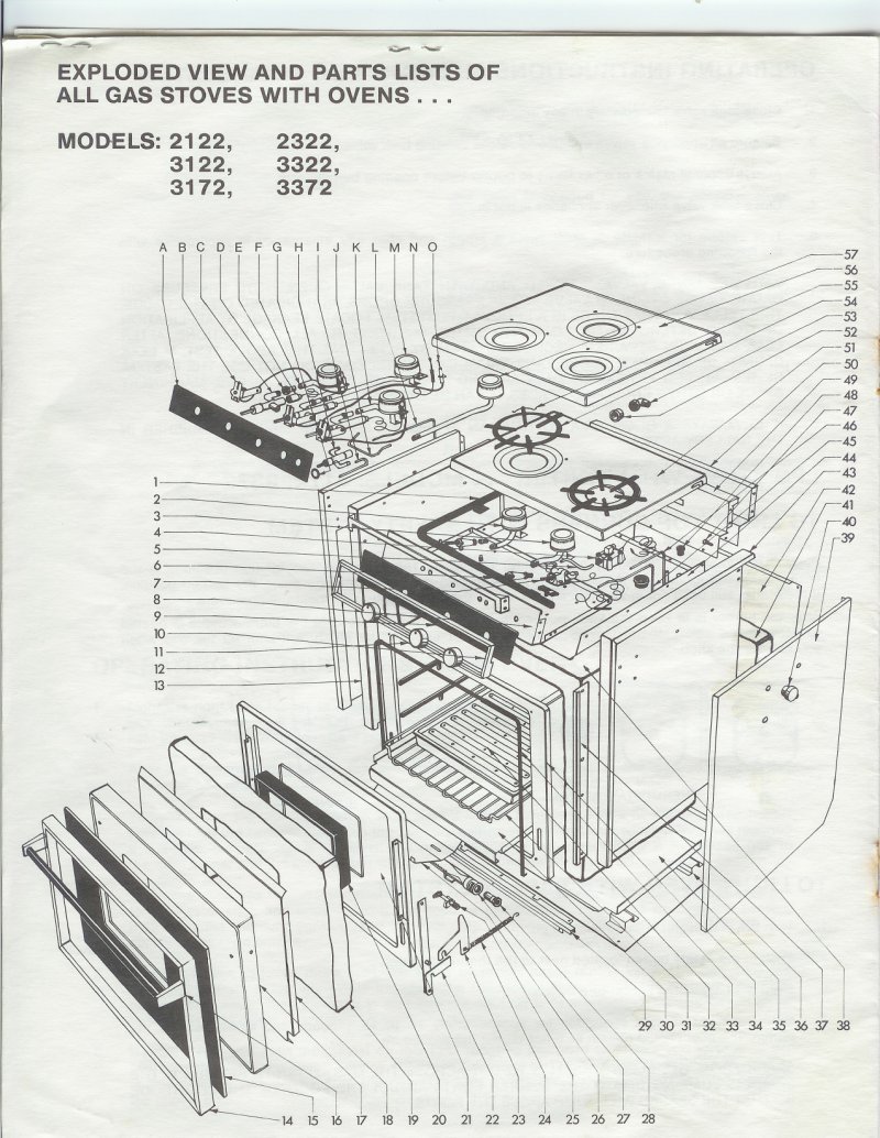

Mike,
Have you checked the Tech Notes CD? There are pdf manuals on the CD for both the CNG and LPG Seaward stoves on the CD. I'm not sure about the details of your stove, but there are also exploded parts diagrams with numbers. I'm sure you could find your info there. Hope this helps.

Last year I decided to clean and repair the parts and the gas valves on my boat range.
I took all of the "guts" home for the winter.
I spent many evenings looking for a parts list for the range on our boats.
I concluded it is a Hillerrange Princess Stove.
I think this is what you are looking for.

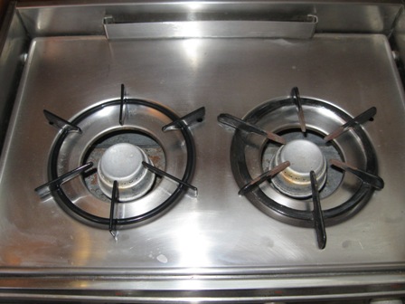

OK Stu, you win again.:D I called Seaward and after a while of playing phone tag, I finally got through to them and the new grates and clips arrived today. If anyone wants them, the correct stove # is 2372 for the Princess stove on the MK I. The grates are about 15 bucks each and really improve the appearance of the stove.
[ATTACH]181[/ATTACH] New one on the left, old one on the right.
Thanks Mike for calling Seaward. I am a bit late here but our stove is Model # 2122 SN# 50704 . Looks just like the one in the picture. Had it on a file as it something I have done with the whole boat. Have pretty much all my part number so if I am home I can still have access to them .

You either never do any cooking on the stove, or you have done an AWESOME job of cleaning the stove top!!
