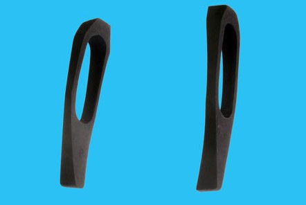

I took my mast down last fall to repaint it.  I found that one of the spreader base castings was broken.  This is a small part that sits between the spreader and the mast.  Probably not a critical part, but with it broken there is a little bit of fore-and-aft wobble to the spreader, and it puts additional pressure on the pins holding the spreader in place.  I ordered replacements on Catalina Direct.
