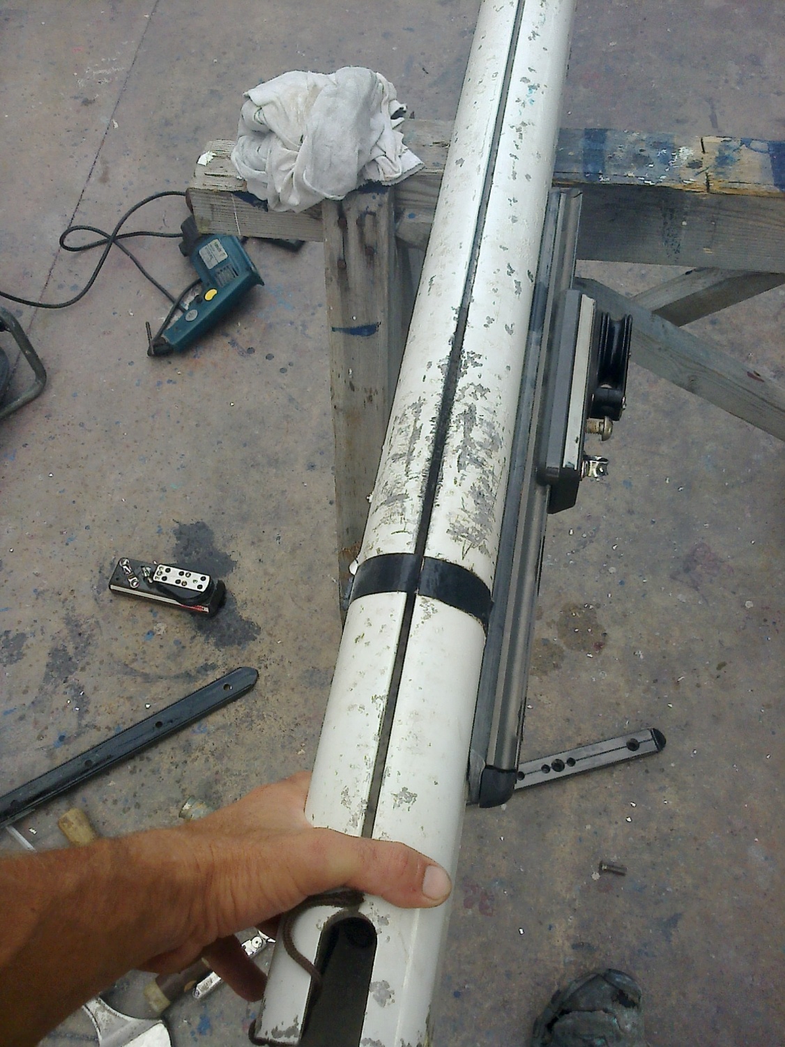

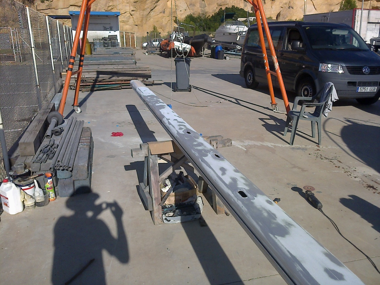

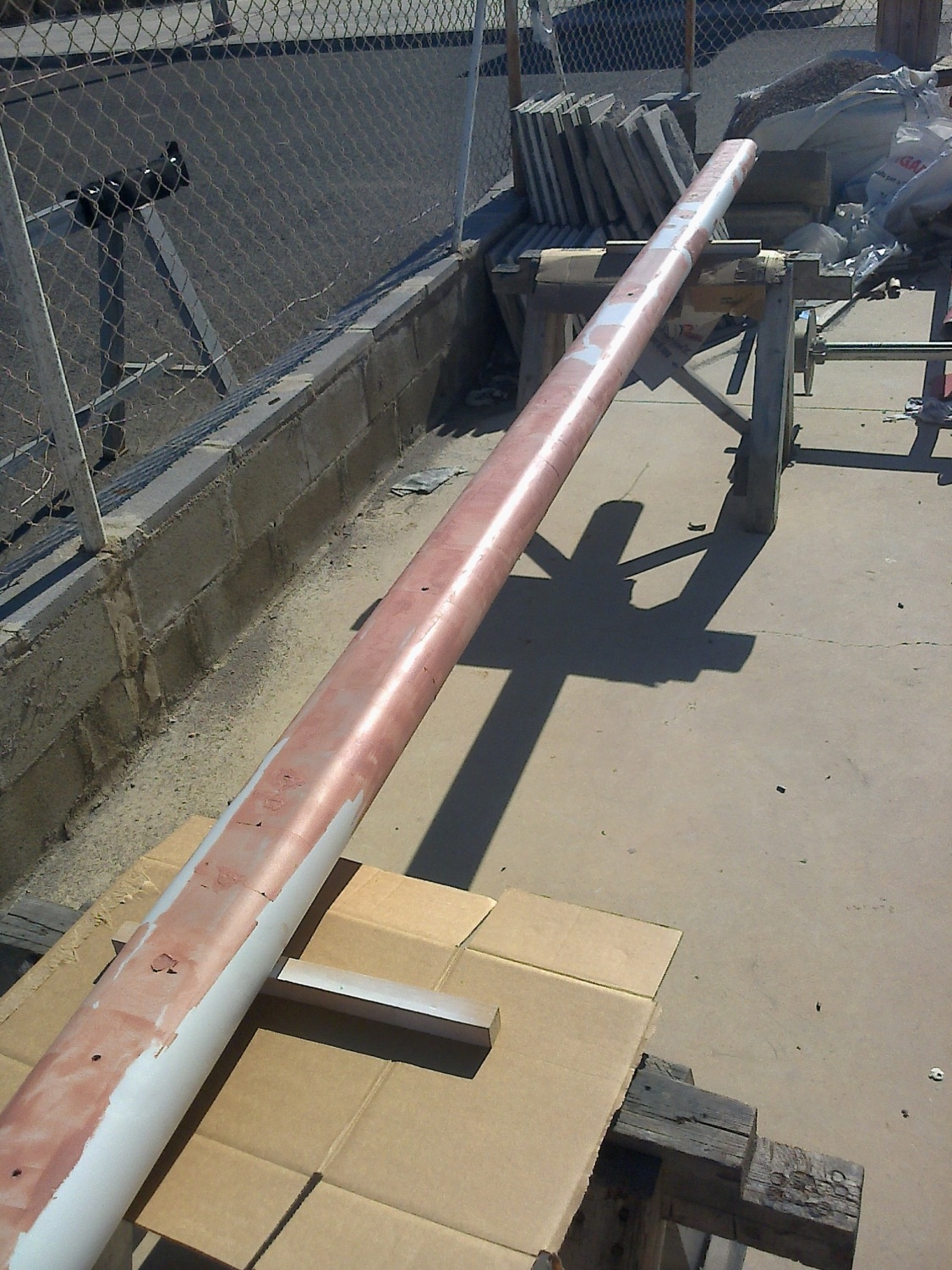

Hi,
I did the same job some five years ago. Have a complete report of the work done (Spanish) with pictures, but it looks to big to upload here...Will try to send you a PM.
