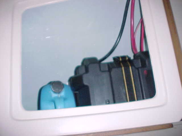

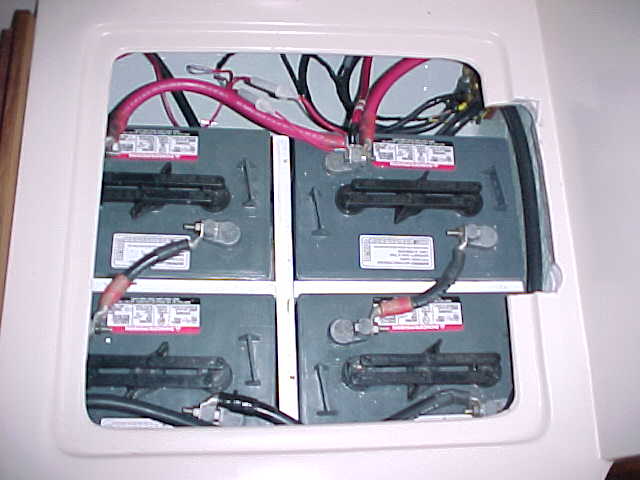

David, First as Tom has said "its your boat" but I would move the battieries. Based on your description you added the 250# additional to the side that did not need it. I'm wondering what you did with the batteries you had under the aft game seat ?Here are a couple of pictures of how I ended up. First one is the four batteries in the aft game seat and the other is the starter or emegency battery under forward game seat, as I use the main bank for everything.
Gary
