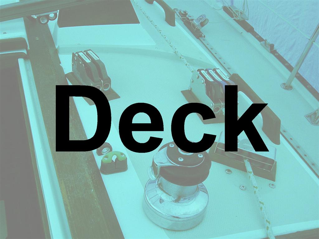

I agree with everything said so far. One other thing you might want to consider is moving the jib halyard to the mast. If you are like me, you adjust it very few times each season (non-racing). In the Upgrades section is a link to the improvements I made on Julandra. There's a whole section on deck improvements, including moving the halyard winches inboard on the MkI, putting in rope clutches as Stu described, and going to double reefing lines. Made a HUGE difference. Other than putting on the mainsail cover, everything can be done from the cockpit, which is a big safety factor as Bud said.
One thing to consider with deck organizers; I'd try to keep the angle that the lines make through the organizers to the minimum possible. On my '88 C30, the dual level organizers turned the lines 90 degrees. That's a lot of force and it resulted in bending the bolts/axles of the rollers. Garhauer of course replaced them free of charge. The lines exited the bottom of the mast at 90 degrees to the centerline, so there wasn't anything I could do about it, but if you can avoid it, minimizing the angle will decrease the load.

Matthew,
Good question. The one thing that comes to mind is to mount the cam cleats for the traveler lines as far aft as possible, the first time. In my original layout I copied a newer Tartan at our dock with the cam cleats forward (Which you can see in the pic in post#17 above, just below the D and the e). That did not work well for me. I would occasionally need extra pulling power to move the traveler, and a few times I found myself almost wearing grooves in the teak trim at the top of the bulkhead. It was also harder to engage the line in the cam cleat. Moving the cam cleat aft solved those problems, but left me with 4 extra holes in the cabintop. If I think of anything else I'll post it.
