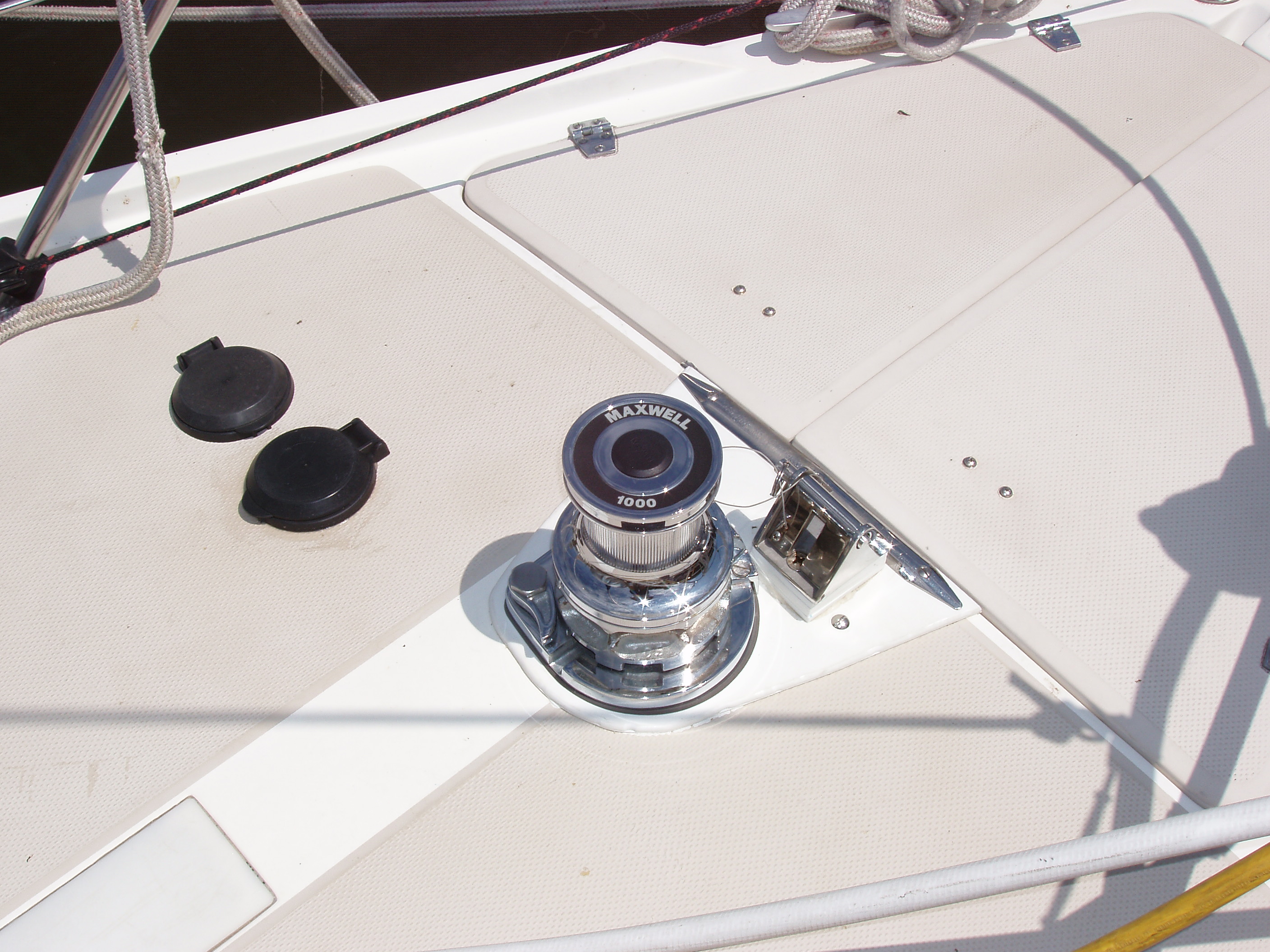

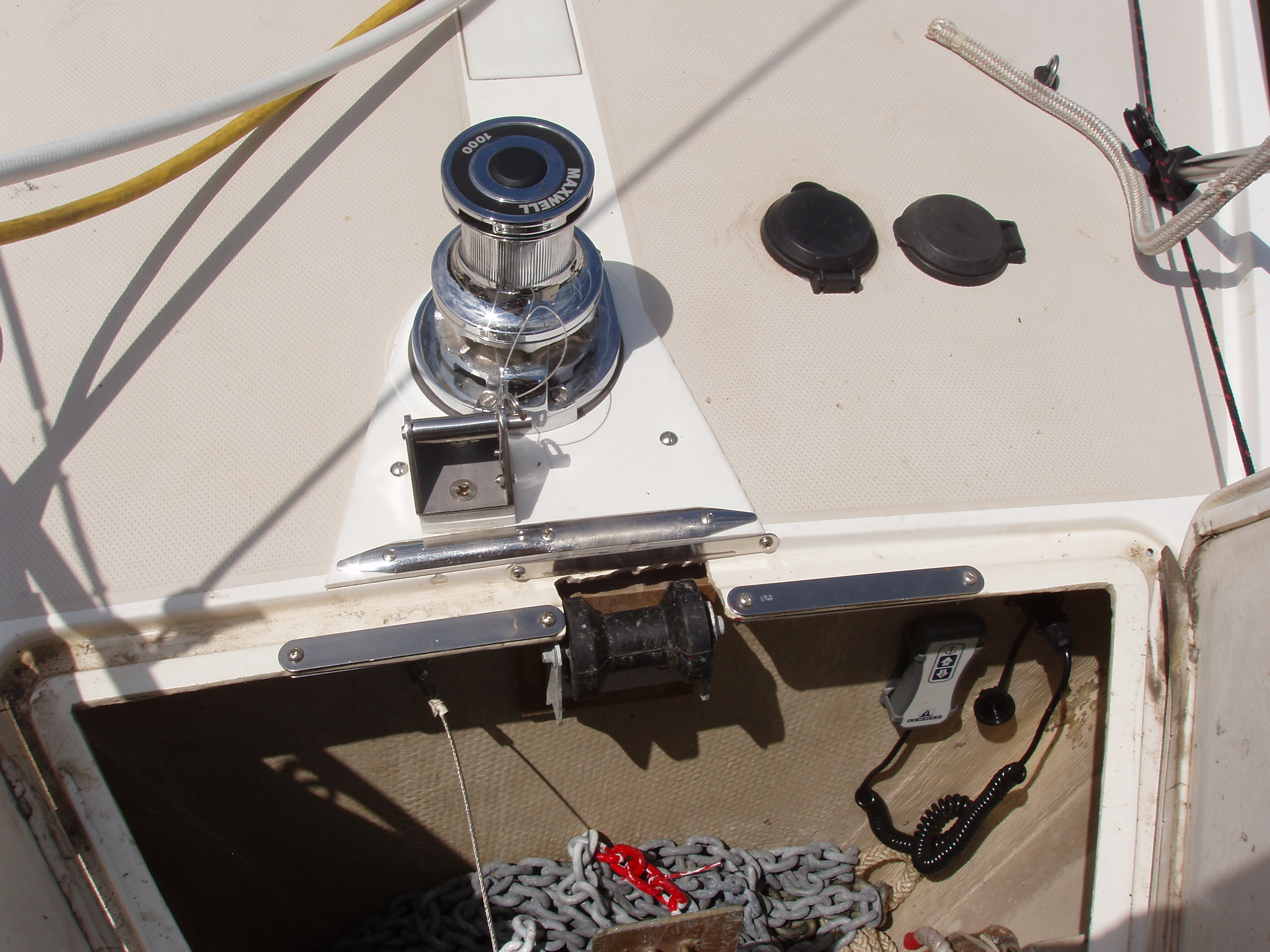

I have a MK 1 model and I installed a vertical windlass on my boat.  See the photo attached.  It is straight forward and the windlass can handle both chain and nylon rode.  I have 120' of 5/16" chain and 200' of 9/16" plait line.  I have other pictures, too large for this website, I'd be happy to share with you.

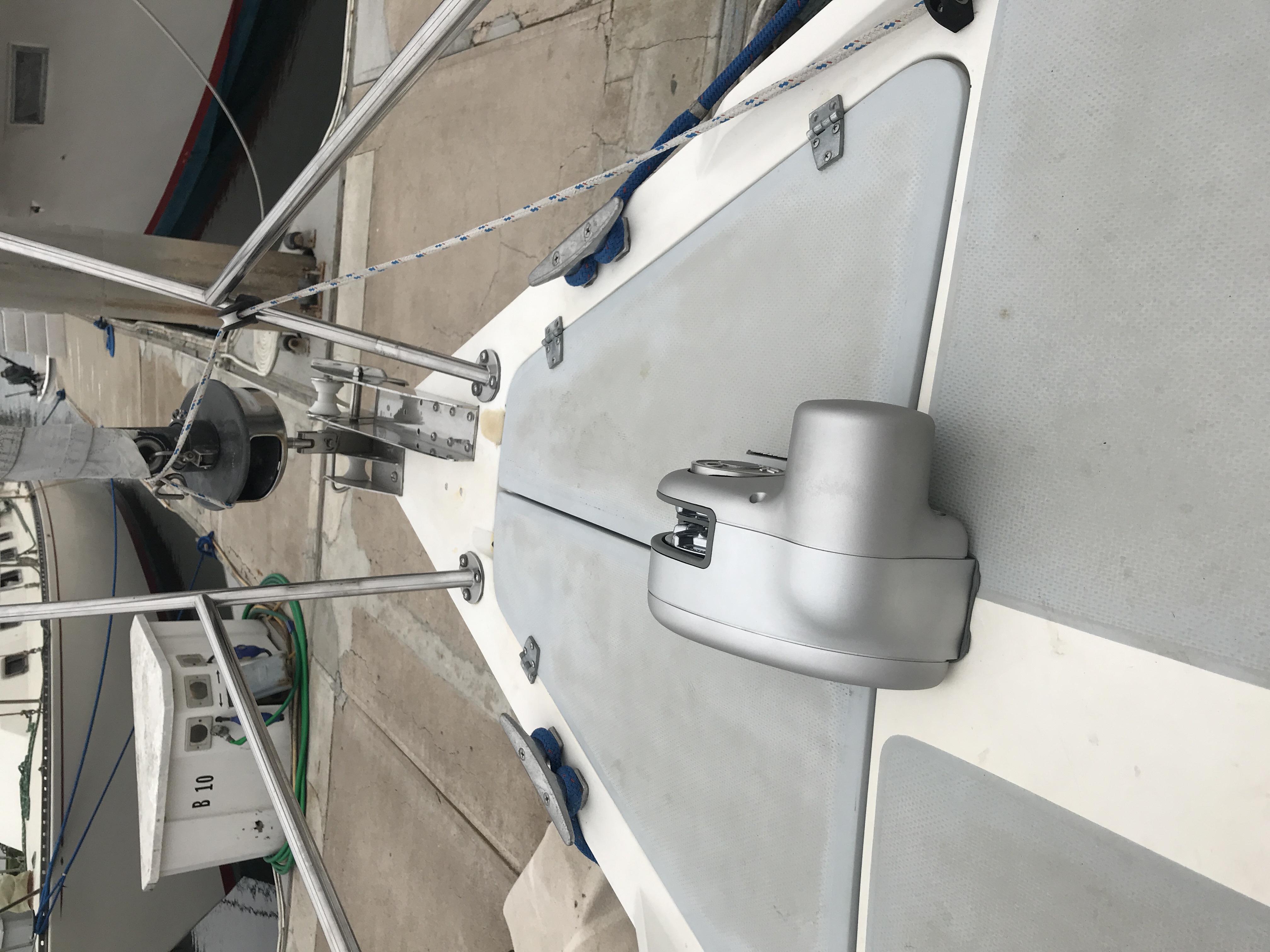

We mounted a horizontal windlass, would have preferred a vertical but we also didn't want it intruding on the v berth.  Took some mods but worth it, and clean, no designated battery, no problems.  We've anchored out at the Channel Islands here in Ca, sailed to Puerto Vallarta and back, anchoring all over the place and in all kinds of conditions up to 40kts of wind and no problem, we use a bridal so the windlass doesn't have to support any load.
Sorry, I dont know why the pictures load side ways!?

Link to image/post in the forum with photo of the vertical windlass setup in the pre-Mk II models: https://www.catalina36.org/sites/default/files/forum/IMG-2621.jpg
