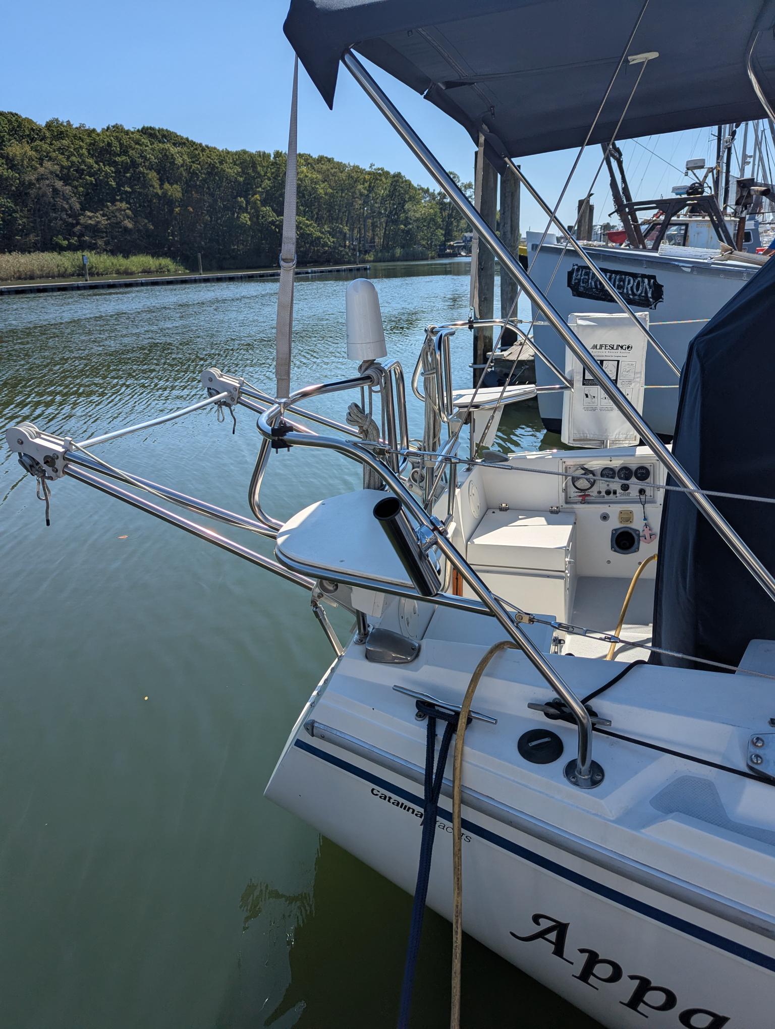

First off, we want to add davits.  Second off, right now our wheel and stern feel extra narrow and restricted because of existing bimini framing, and because our boat's PO fabricated his own perch seats inside the factory rails (they're a nice effort but not comfy).  CD offers the Mk 1.5 retrofit stern perch kit where the pulpit's side rails extend aft to form a seat beyond the cockpit, then the rails return to meet the existing boarding ladder.  The attached photo shows such an arrangement on a sister ship (those davits might be a tad low to avoid the dink dragging when heeled...?)

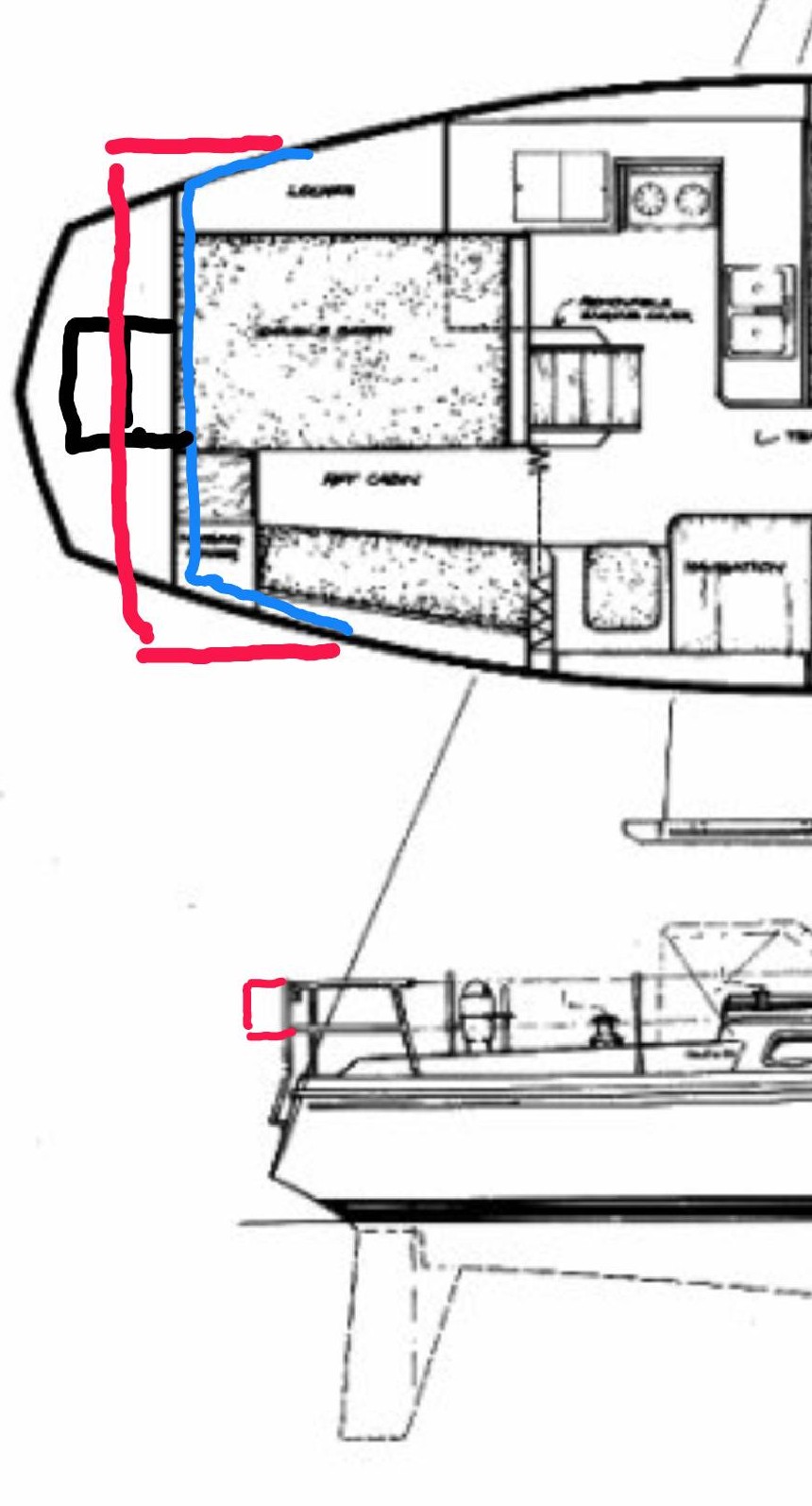

The attached sketch shows the stern rail arrangement the canvas guy suggested in red...and the OEM rails in blue.  The ladder would need to be modified accordingly.  On the plus side, assuming good backing plates and strong welds, the proposed rail expansion gives a much more spacious stern experience akin to a Mk 2.  And also on the plus side, my (much fairer) co-captain likes this concept.  On the minus side, it will shift weight a bit, it may push the davit mounting further aft...and something is nagging at me that if this was a really good idea someone else would have done it already so we'd see photos online.  Safe sailing is generally a conservative activity and such boat modifications are safety critical.  What does the group think of the concept (excluding the associated boat bucks)...is it worth exploring for extra room or should we stick to the more conventional, tried and true perch rail approach?

Keith-
Those davits in the picture look much too low to keep a dink out of the water. What does your dinghy weigh and how long is it? Generally, davit arms should be taller than the stern rail, and should incorporate compression posts to take some load off the stern rail, which is commonly a point of attachment for the vertical parts of the arms. I suggest contacting Garhaurer. They likely have a design for the MK 1.5. They were very helpful for our MKII davits.
