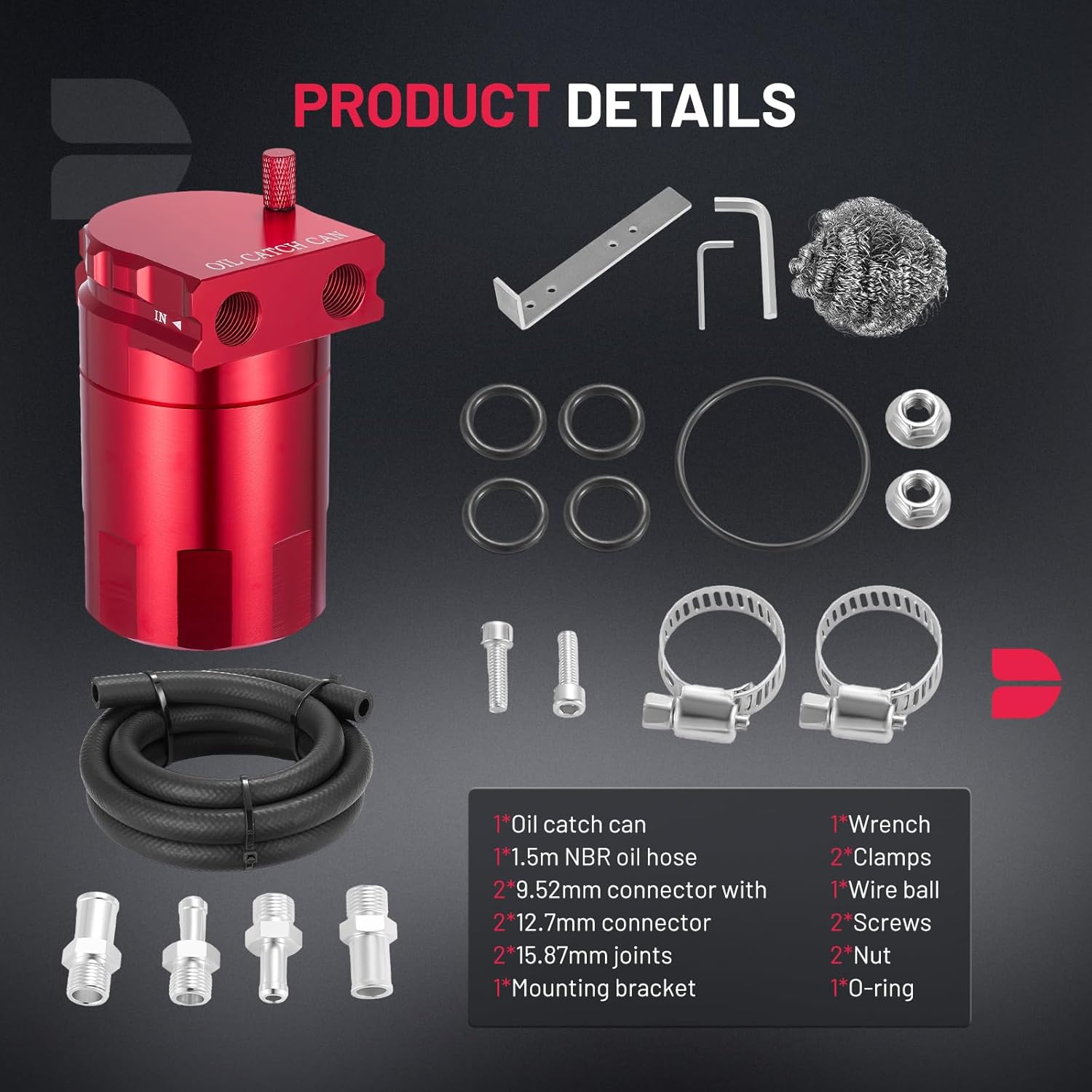

And so, I’m exploring the option of installing an oil catch can along the length of the crankcase blow-by vent tube.  Amazon has a number of these for sale for around $30 bucks.  Many of these have an air intake air filter mounted on top whose purpose I don’t understand.  Perhaps in a sealed system this allows for air pressure equalization.  Mine, of course, is not sealed and is open to atmospheric pressure at the air filter and so this small air filter would be unnecessary, I think.  Do any of you have any thoughts or recommendations on this general topic?

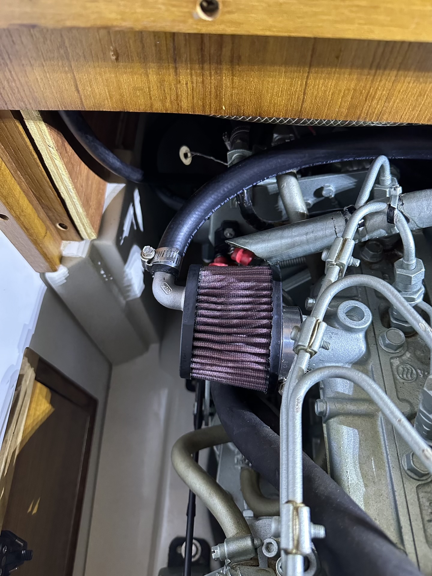

This has worked for me
2003 Catalina 36
