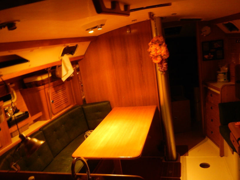

Finally purchased the Eyeball replacement LED bulbs from Marinebeam.com, they had been out of stock for a while.
[URL="http://store.marinebeam.com/eyeball-fixture-bulbs.html"]http://store.marinebeam.com/eyeball-fixture-bulbs.html[/URL]
They were worth the wait. They are 3 Watts at 180 lumens vs 1.44 Watts at 80 lumens for the Amazon bulbs. The lens in the bulb puts a lot of light on the table area and lights up the rest of the immediate area with nice even lighting. The incandescent bulbs have a harsh darker transition band just above the cushion on the bulkhead.
The previous incandescent bulbs did not put enough light on the table to play cards with out additional lighting.
Here is a photo, with just the two replacement LEDs on over the table.

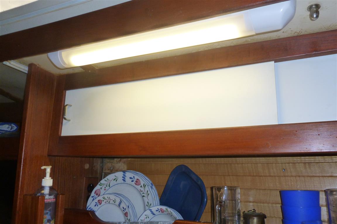

[QUOTE=LCBrandt;17580]nothing high current draw remaining except a two fluorescents in the galley, then all the lighting on the boat will be LED.[/QUOTE]
Larry, we replaced our fluorescent with a Marinebeam LED

[QUOTE=VermontSailor;17648]Finally purchased the Eyeball replacement LED bulbs from Marinebeam.com, they had been out of stock for a while.
Here is a photo, with just the two replacement LEDs on over the table.[/QUOTE]
I just installed a bunch of these last week on a Pearson 36-2. Not a bad light at all. Not too cold but certainly not what I would consider "warm" either..
The BIG benefit in buying from Jeff/Marine Beam is the constant current circuitry which many el-cheapo's simply don't have..
Many do not know this but Marine Beam supplies a some of the MAJOR marine lighting companies and they sell the same bulb with a different label for slightly more money... It is good stuff whether you buy it direct from Marine Beam or through a re-seller of Marine Beam products....
-Maine Sail
