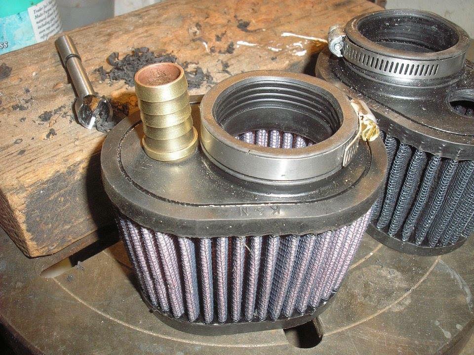

From Rod Collins aka Mainesail:  ​http://www.pbase.com/mainecruising/m25_air_filter__pcv_valve
Second picture shows routing the PCV hose into the filter.

After consideration, I decided to go with the K&N  RU2450 and side mount it on the side of the of the M-35 engine. The intake air manifold on the M-35 engine is not quite the same as the  M-35 A & B engines. Although the air intake is the same diameter, (1.75) - the manifold input port on the M-35 runs parallel with the floor - where in the later model engines, the input port has an elbow and points skyward.
I do not intend to run the oil breather exhaust hose in to this filter, rather, I will take the oil breather hose and push it into an empty water bottle with some stainless steel wool at the bottom of the bottle. Not pretty but effective.

I use the 2450 as well.  And I plumbed the breather tube back inot the filter to keep it from getting too oily.  Works like a charm.

Thanks for the picture Phil. I think I'll give that a try.
