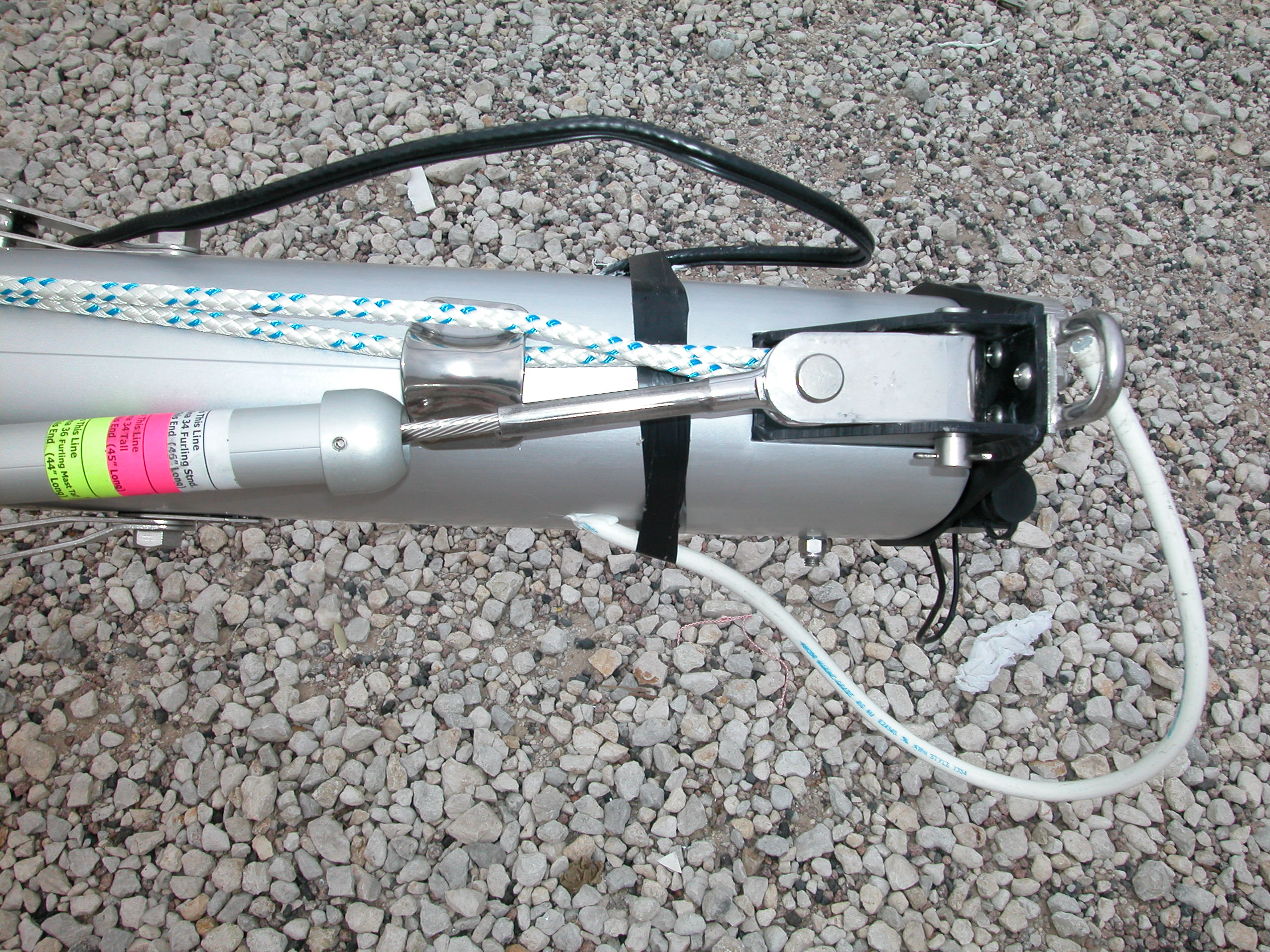

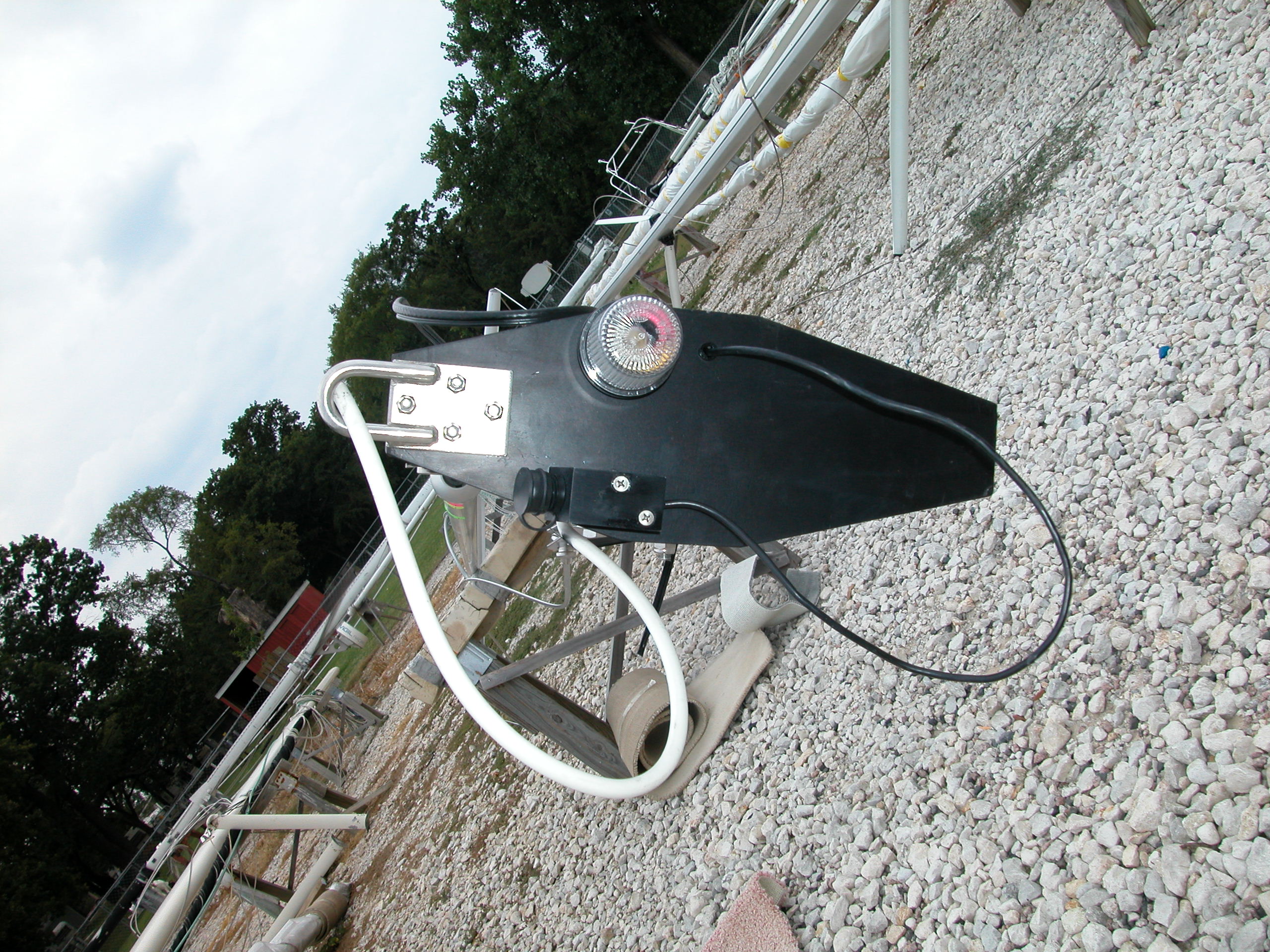

Larry,
I've uploaded two pix of the top of the mast of #2211, so it should look the same as yours.  Note that this owner chose to have one wire come out of the top of the masthead fitting (small black wire for wind instruments?) and two wires come out of the side of the mast (white vhf coax + larger black wire for ???).  Hope this helps.
Thanks, Tom. That's helpful.
The white wire in the photos is clearly a coax, the small black one is for a wind sensor. Not sure what the large black one is for, but I'll guess anti-lightning static dissipator?

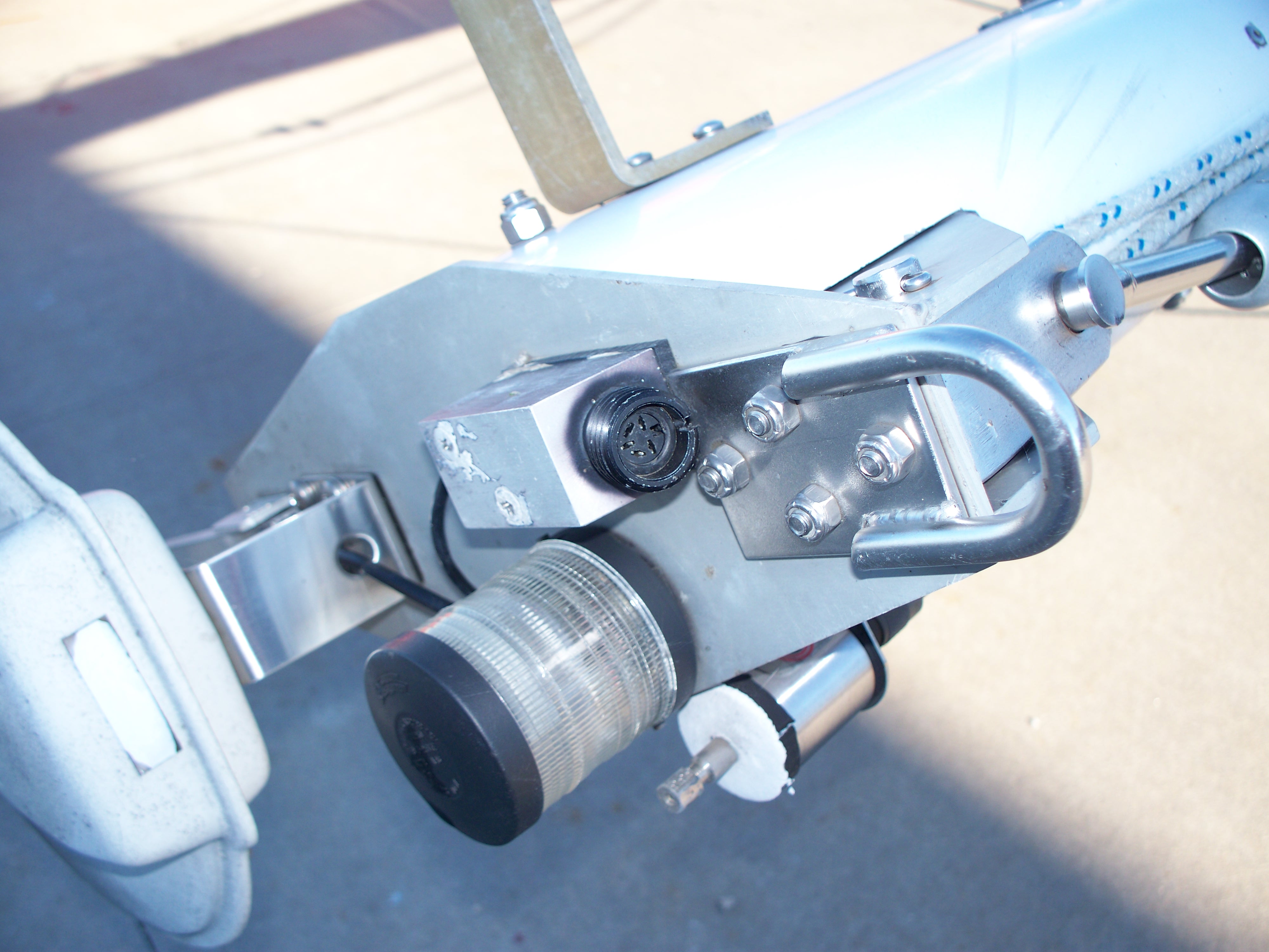

See if this helps.
Bill Matley
Cheboygan, Michigan
Lakes Huron, Michigan,
Canadian North Channel
"Spirit of Aloha" Hull #1252
Image icon 100_1889.JPG1.1 MB
Thanks, Bill.
