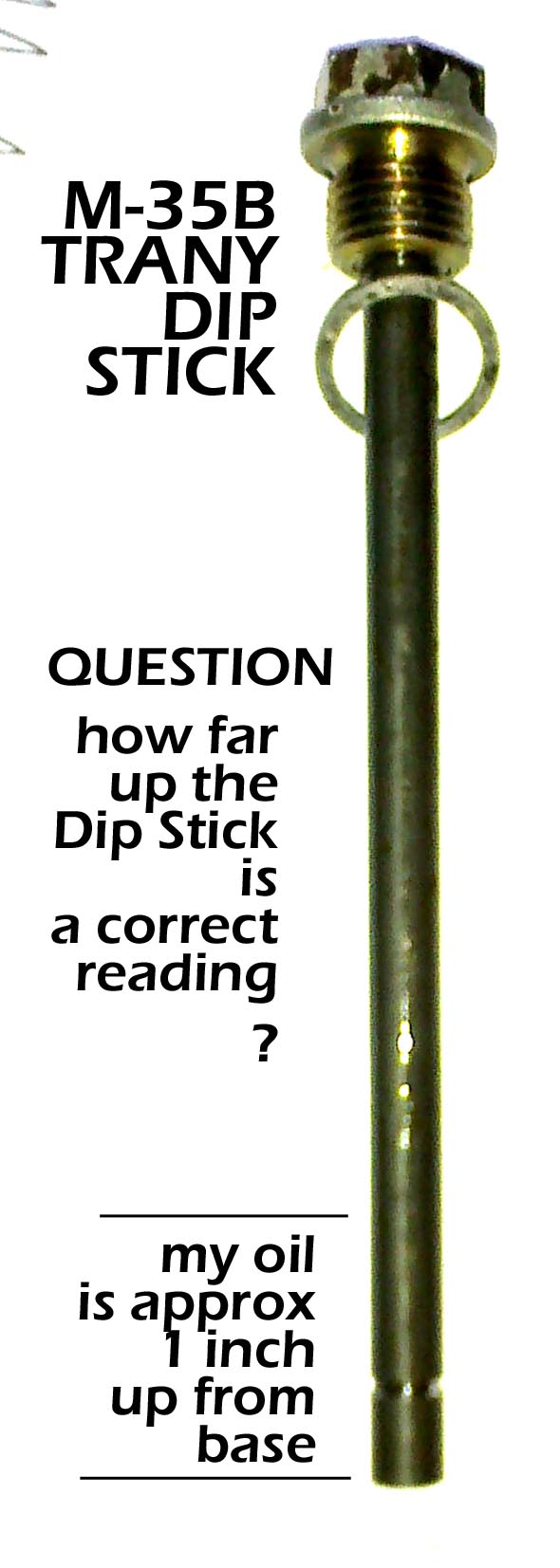

How to read the M35B Tranny Dip Stick, and
My M-35B Gear Box Dip Stick OIL reads about
1 inch up from the bottom.
Is this correct?
(photo attached)

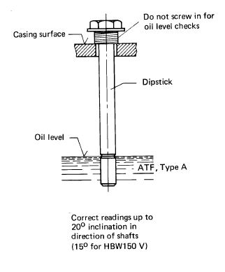

The level reading is taken with the dip stick unscrewed and resting on the casting. See attachment

Completely unscrew and clean. Insert dip stick, allowing the dip stick threads to just rest on the casing.  Remove and inspect.  Ideally, the fluid just reaches the line on the dipstick (about 1/2" from the bottom).  Anything significantly past this line is overfilled and anything below this line is underfilled.

Just to be clear, it looks to me that the answer to your question is a big NO (it is not correct) and as I understand it, overfilling trani fluid can cause big problems.
