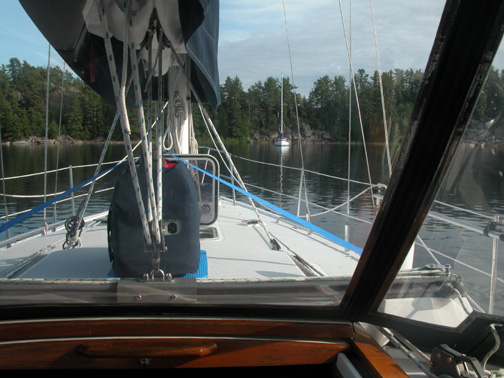

I didn't like the red color of the generator, it was too obvious and could invite someone to steal it, so I had my local upholsterer make a custom cover out of blue sunbrella material to match my sail cover and canvas. He did a great job and designed the cover so that I can run the generator with the cover on. The generator looks much better in blue.
I mounted the generator under the boom just forward of the dodger. I have a picture to show it better. It was a good location for me, it doesn't block my view or interfere with my sails.
I set the generator on a blue foam pad and ran a strap tie down from the port to starboard hand rails. It was very firmly attached!
I used a large bicycle cable type security lock to make sure the generator was still on the boat when I returned from any shore travel. That tie down and security system worked very well.

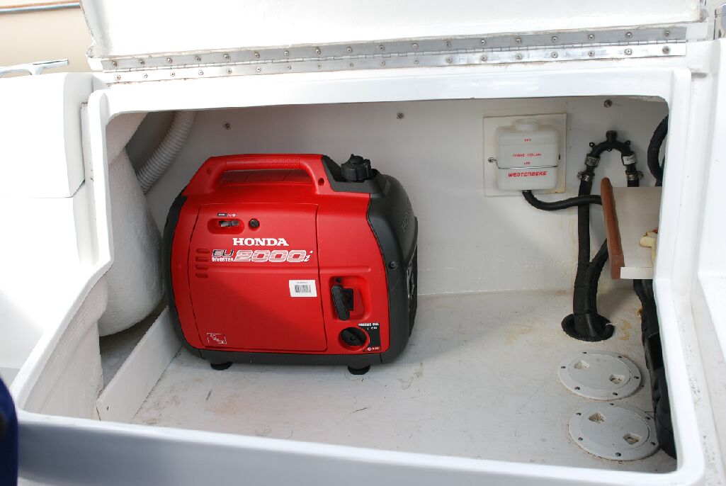

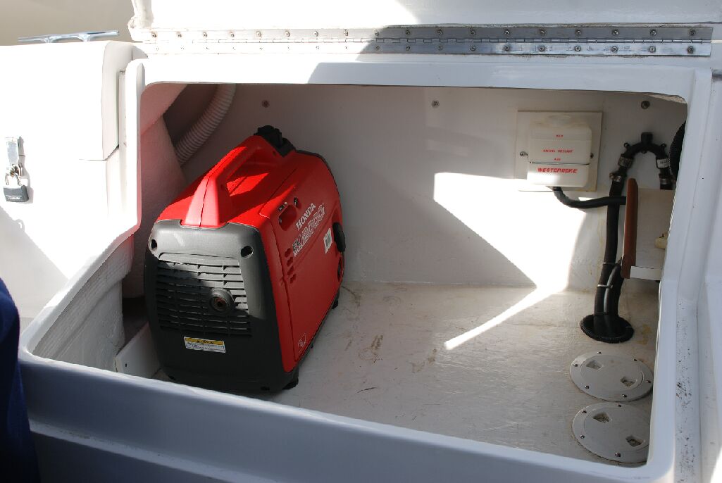

I have one and it works great. See attached photos
Oh, no! Someone stole my scuba tank, wet suit, fins, weight belt and mask; buckets of cleaning materials and rags; deck brush; snatch blocks and dock lines; flare kit; 4 seat cushions; companionway hatch boards; and other assorted gear.
On, wait. That's not my locker! Whew!!!! ;)

I was planning on storing the generator in the cockpit locker. My locker sure doesn't look like the one in the picture!!!
