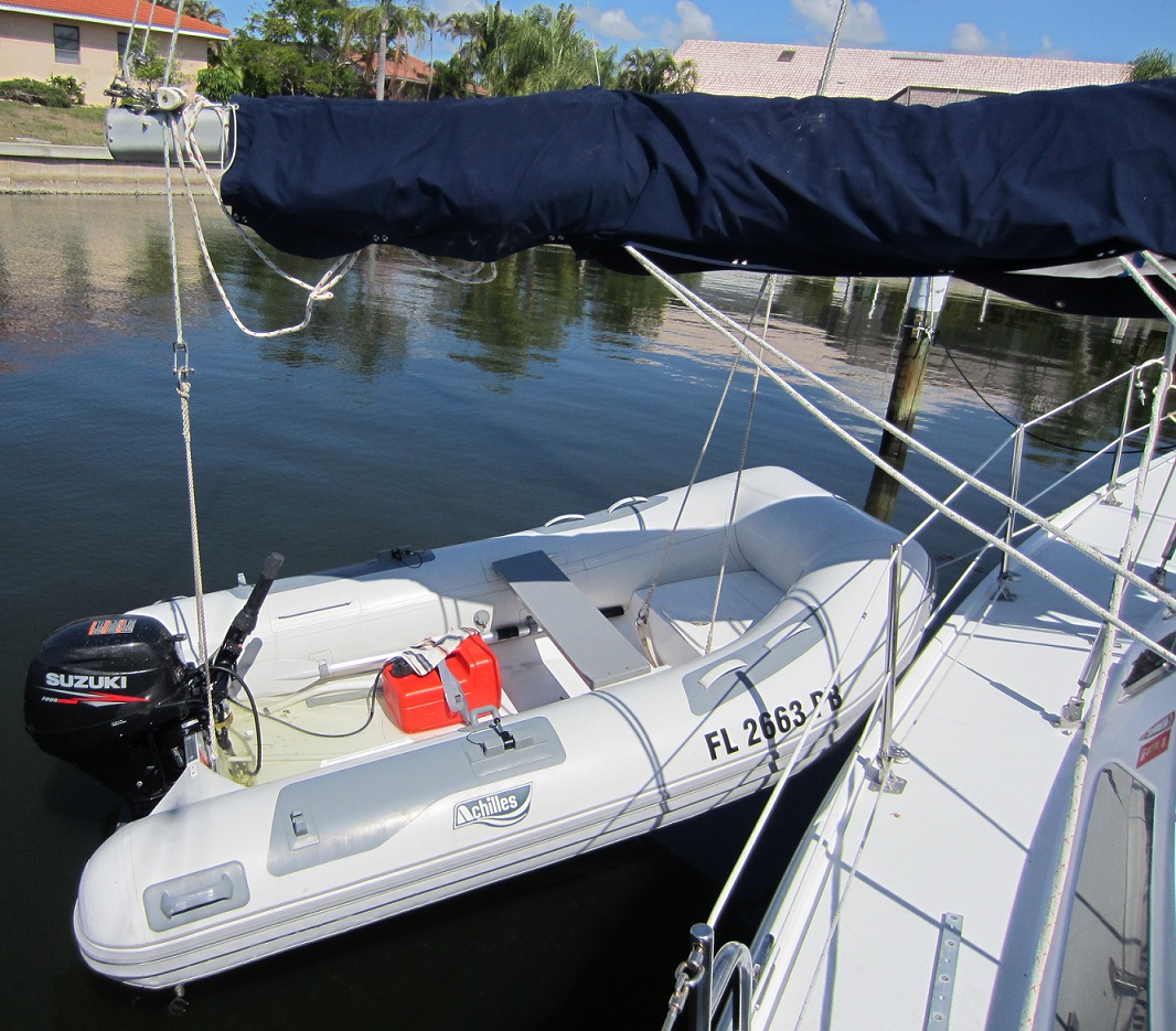

Who has employed some tricks to heel their boat successfully? I plan to make a trial with my 250 lb dinghy/engine held to one side with the boom and using the main halyard and a snatch block to hoist the dink. Then I will measure the heel angle and see how much that gets me.

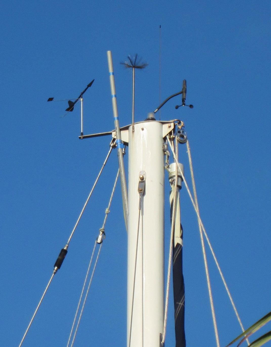

I just measured the actual height from the waterline to the top of all the masthead gear (not counting the flexible VHF antenna) and found it to be 50 ft 10 inches. I measured twice and got the same number.
First, I put tape marks on a piece of PVC pipe and taped it to the main halyard shackle. At the zero point on the tape marks, I attached a 50 ft long measuring tape and hoisted it up the mast. Then I sighted with binoculars from my backyard and saw that 2 ft from the zero point gave me a few inches clearance over the gear.
I then stretched the tape to the top of the deck and measured. then I went inside the boat and measured up from the known (within 1 inch) waterline level to the overhead liner. I guesstimated 2 inches from there to the top of the deck.
When I added it all up, it was 50 ft 10 inches.

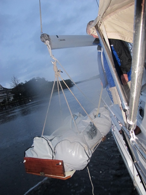

As suspected, our C36 is relatively stiff.
With a 250 lb dinghy hanging from halyards using the boom to keep it outboard of the hull, I measured 2.5 deg. Adding about 80 lb of water to the dinghy got me to 3.3 deg. Having my 240 lb of bulk standing at the rail and leaning out slightly over the boom got us to 5 deg.
Interestingly, when I take the weights and multiply by the distance from the centerline of the boat to the approximate center of mass, each stage of the measurement yielded very close to 1,000 lb-ft of moment per degree of heel. That would change (increase) as we heeled farther, of course, but it is a good rough number to know.
Nothing during the experiment seemed like a strain, but I don’t know how much more water I would feel comfortable adding to the dinghy. My conclusion is that it does take a fair amount of moment (weight times distance) to get any appreciable heel. Even 5 degrees buys you just a little over 2 inches of extra clearance, which in our case might just be enough.
