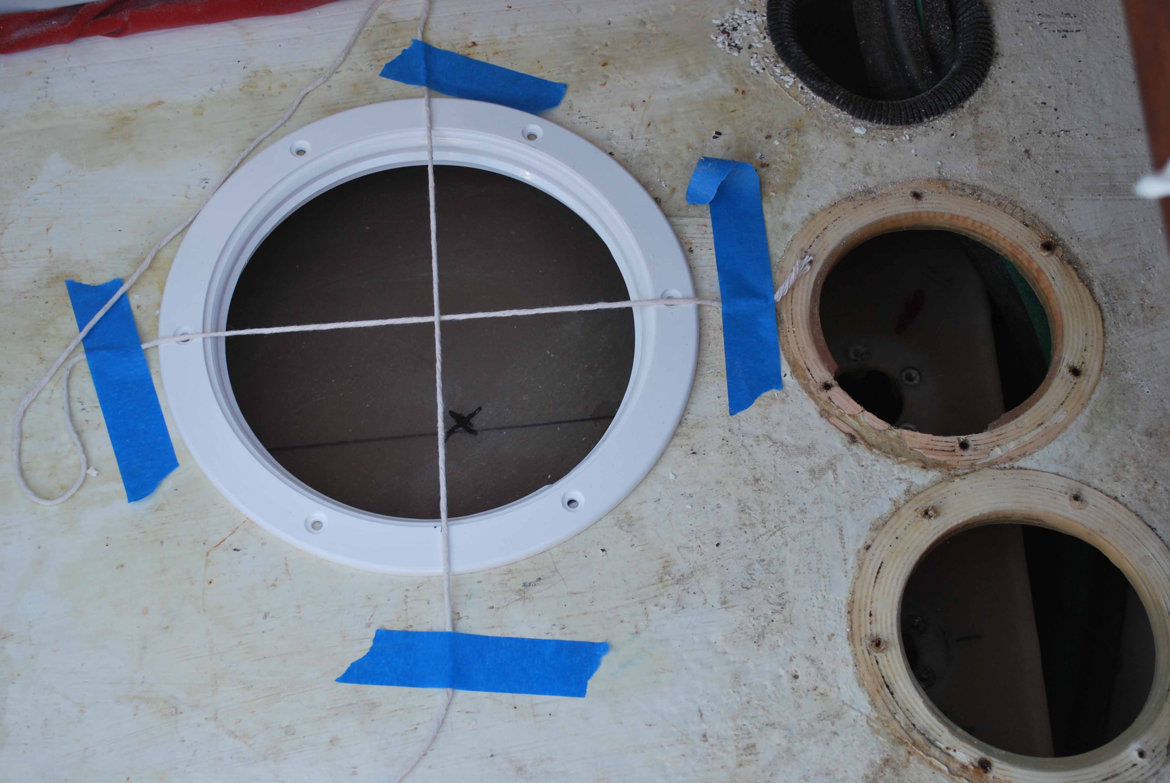

I then figured out roughly where I wanted the access plate on the tank and cut out the hole in the locker deck. Since I had the tank out, I had to slide it back into place to make sure the hole in the tank was directly under the deck hole (see pic 2).
